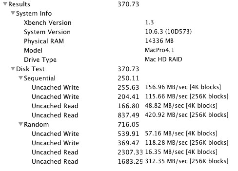

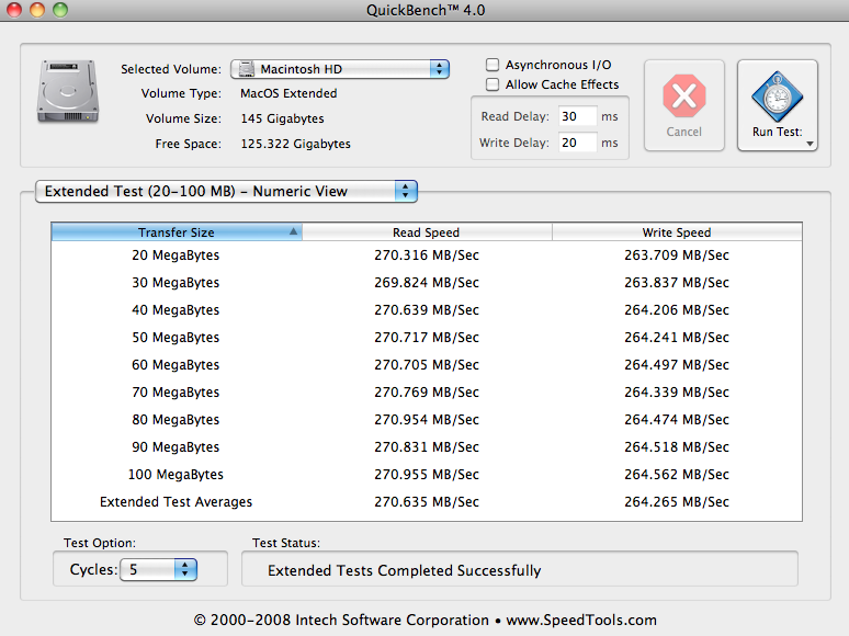

Just got an OCZ vetex 2 installed in my 15" i7 MBP. It's installed in an optibay from newmodeus and I have the WD 1TB drive in the original HD location.
A note for anyone planning on doing this. If you want bootcamp, install the SSD in the original HD location first. I could not get windows to load using the superdrive via USB. I put the superdrive back in its original location and it worked fine. Interesting note: it benches faster in OS X then windows.
First the original 500GB HD.
Now the Vertex 2 Xbench

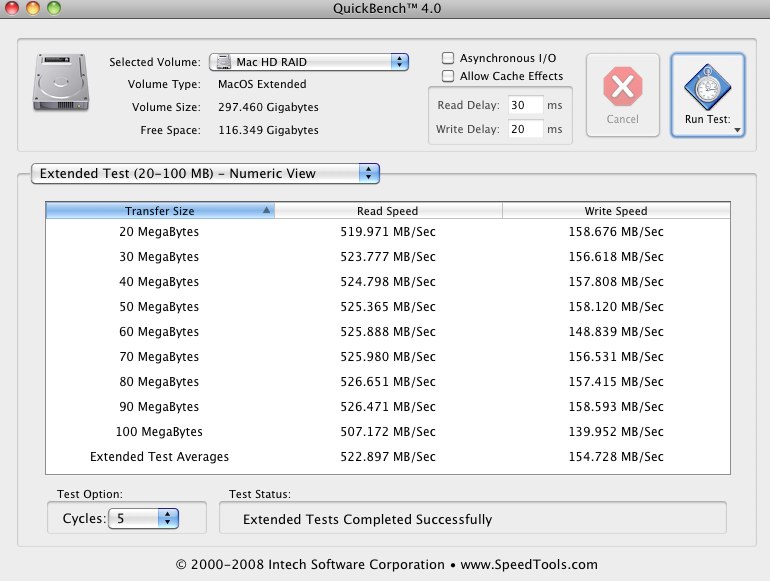

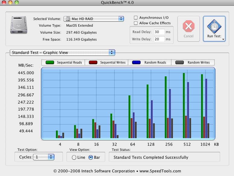

Vertex 2 quickbench
The WD 1TB:

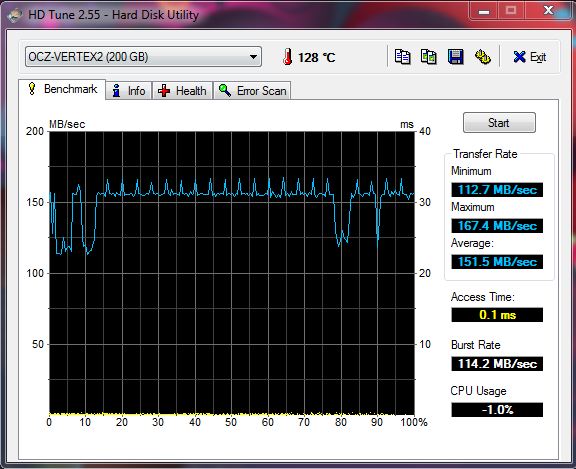

Win 7 64 Bootcamp benches:

I'd like to see the QuickBench Extended 20MB-100MB Test results in 5 cycles. (Are you running version 4.04? It should give an average in numeric view.)

Thanks, Bugout, for the QuickBench Extended results. That's as good as or better than any SSDs I've tested recently:
http://barefeats.com/mbpp19.html
And the Vertex 2 has the SandForce controller and firmware with enterprise-level features that keep it running fast no matter how heavy the usage.
I refer all you and others to the testing by Lloyd Chambers where he beats on the SSD to see if it slows down. The OWC (based on the same SandForce chip as the Vertex 2) does not suffer slowdown. The Crucial M226 and C300 both have serious issues after heavy use:
http://macperformanceguide.com/SSD-RealWorld.html
A good review of the Vertex 2 versus other SSDs was posted on the 28th:
http://anandtech.com/show/3681/oczs-vertex-2-special-sauce-sf1200-reviewed/1

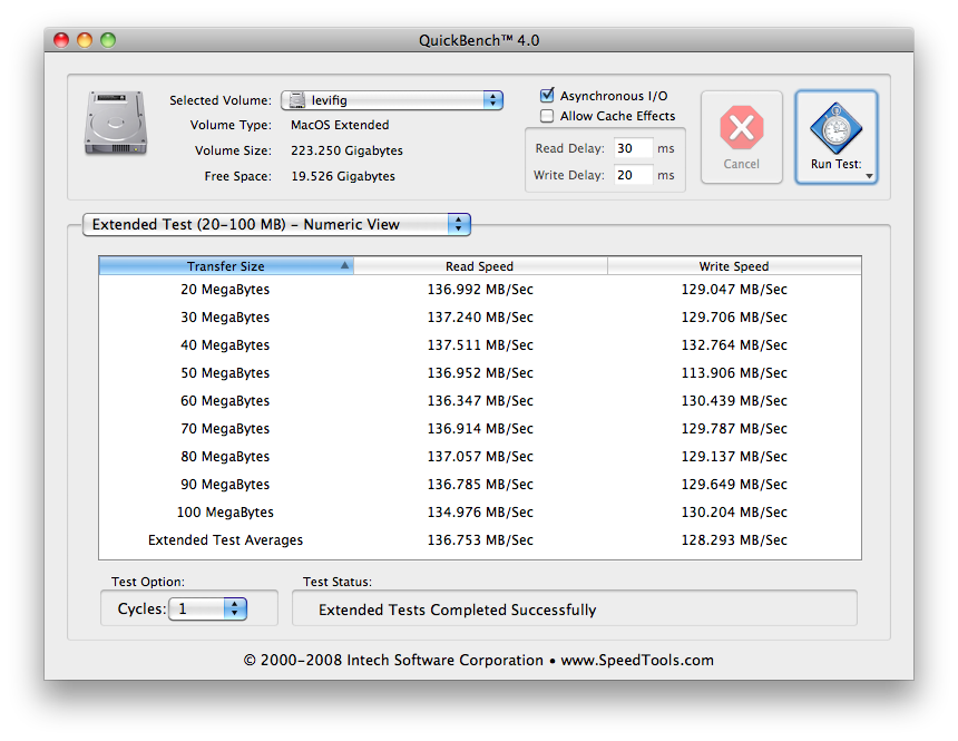

WOW I just got my Vertex 2 last Friday and while the whole system feels TONS snappier, I noticed the benchmarks weren't even close to "standard" though…
Here's mine:
Any ideas? Should I return the drive? What should I do? :\
