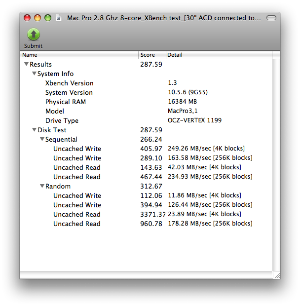

Just installed my Vertex 250. Here are the XBench results. 560% increase over previous stock 320GB HDD:
Disk Test 51.02
Sequential 120.11
Uncached Write 125.70 77.18 MB/sec [4K blocks]
Uncached Write 121.19 68.57 MB/sec [256K blocks]
Uncached Read 97.94 28.66 MB/sec [4K blocks]
Uncached Read 145.24 72.99 MB/sec [256K blocks]
Random 32.39
Uncached Write 10.88 1.15 MB/sec [4K blocks]
Uncached Write 76.38 24.45 MB/sec [256K blocks]
Uncached Read 89.16 0.63 MB/sec [4K blocks]
Uncached Read 137.88 25.58 MB/sec [256K blocks]

Those numbers look great...I guess I was just expecting more from something advertised to reach 250MB/sec???
Most numbers I have seen have been around 130MB/sec
The numbers in text in his post was for the hard drive. The uploaded screenshot was the SSD specs. They look good to me.
That looks like some crazy speed. Question is, zero out the entire drive, then run it again. Curious to see how that'd affect it. =)

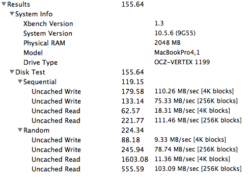

On 30GB Vertex. Early 2008 MBP.
Start up time went from 30 seconds to 20 seconds. OS X installed in 15.5 minutes.
