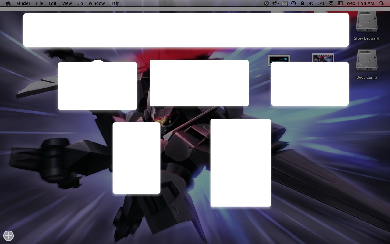

Also I keep getting the same glitch now, which is a grey or black bar just below the Menu Bar. My mouse will appear above it and any windows but the icons on the Desktop are covered by it. 😡

I also did some digging on the Apple Support forums, and found a tip. If you change the screen resolution to anything else, and then change it back, they go away. Temporary fix, I guess. I made sure to check the 'Show displays in menu bar' option to make it easy to do.
That beats logging out. Thanks.

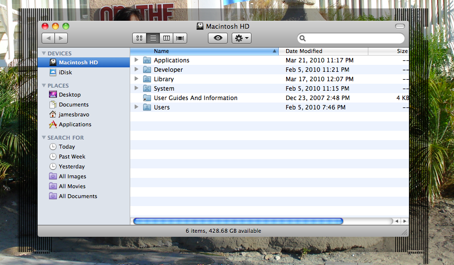

Penryn Blackbook with X3100 graphics here, suffering from the same issue.
In addition, the Dashboard, Exposé and Spaces are jerky when used with an external monitor in extended desktop mode.
This is ridiculous. I hope 10.6.3 address the issues. If Apple wants to retain exclusive control over their hardware and drivers, they need to do it properly.
Well, switching screen resolutions seems to be fixing it, but only temporarily. I'd really like to find an actual solution.

i'm getting it too. i upgraded to SL a little over a month ago
i too have x3100

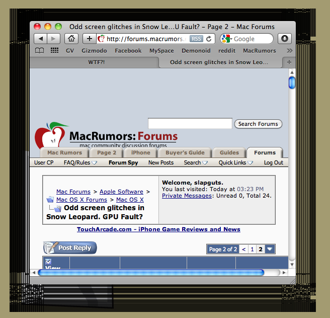

What confuses me is that I was running Snow Leopard since Day 1 with no problems. However, I had to reinstall Snow Leopard earlier this year and since then I've been having these graphics glitches. It only happened after doing the 10.6.2 combo update. (I was on 10.6.2 before the reinstall as well with no problems, but did not update through the combo update, just from 10.6 to 10.6.1 to 10.6.2).
I'm having the same problems with my late 2007 Macbook with the X3100.
I have narrowed it down to something having to do with Safari. If I don't use Safari, I NEVER get the glitches, but if I switch back to Safari, after some different period of time, the glitches will come back. Not sure if it's flash or quicktime related, but it has something to do with Safari.
I've switched back to Firefox, reluctantly, until this issue is resolved.

It's back. I'm starting to think it's related to Safari as well.

I THINK it has something to do with either Flash or the Quicktime Plugin for Safari that uses the black UI. I need to do some more testing to see if I can reproduce it, but I'm pretty sure something with the interaction between Safari, and either Flash or the Quicktime plugin is to blame.
Firefox and other browsers use some other plugin for playing back quicktime media, with the old QT7 interface.
I'll mess with it some more and see if I can narrow it down some more.
The other thing is I think I'm running Flash 10.1 beta, so I might try to uninstall that and go back to the 'stable' (hah) release of Flash instead.

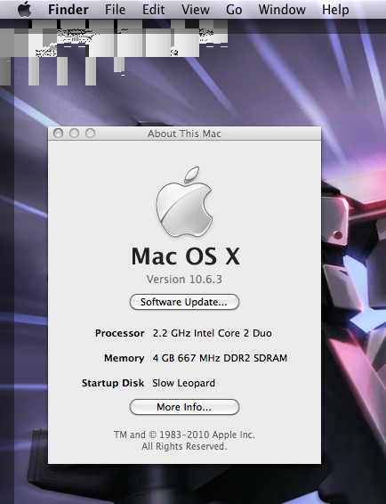

I'm still getting these problems in 10.6.3 😡 So annoying I don't want to give up using Safari as the Top Sites feature is so useful to me. So now to wait for 10.6.4...🙁
Worse
It seems to be even worse with 10.6.3, I might give using Chrome or Firefox instead to see if it is Safari. I'm actually starting to find my Macbook being slower then my girlfriends 2 year old free Dell Inspiron 1520! 😡
