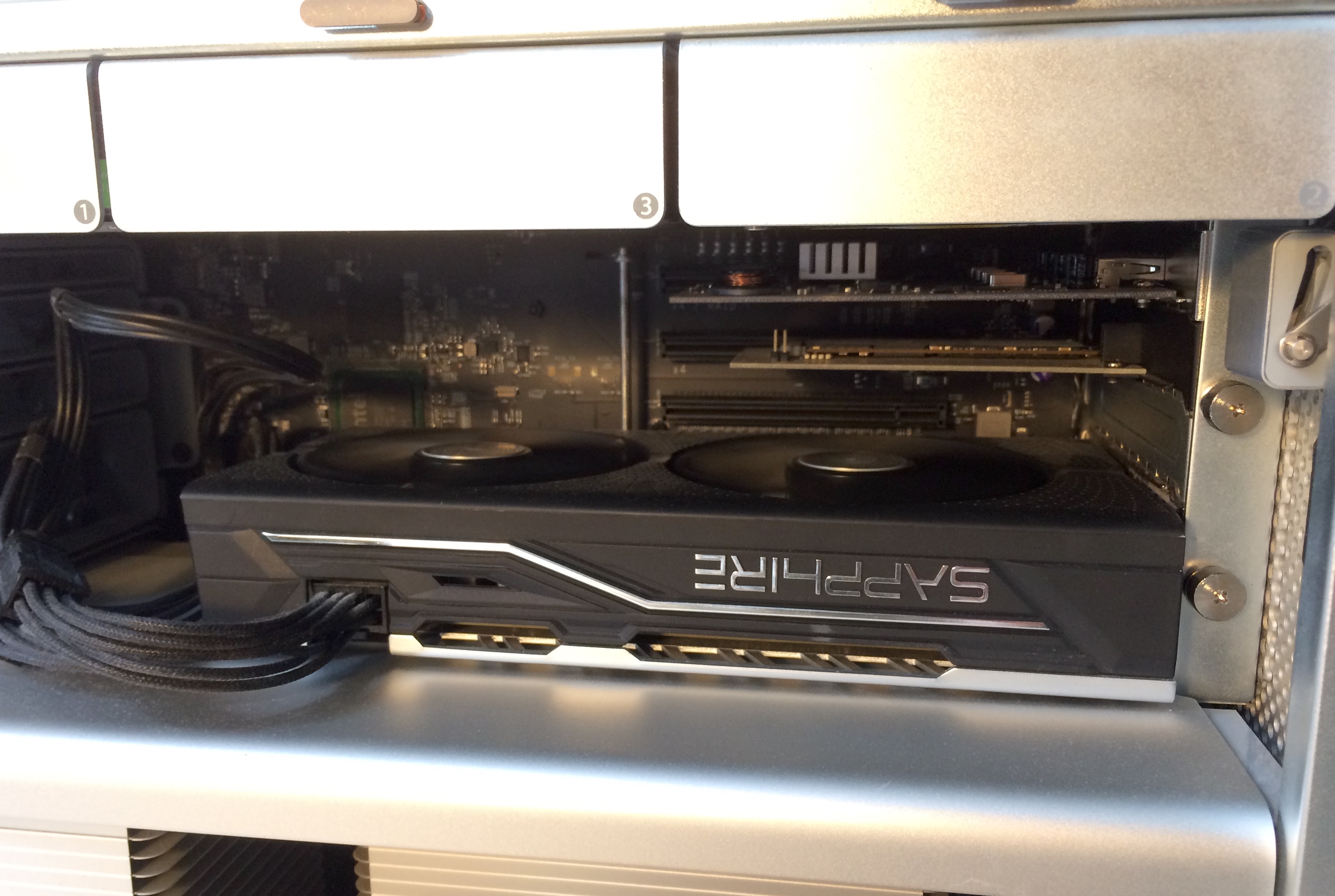

I got a strange issue with fan speed on my RX580 pulse (seems like a bug) — from time to time after boot or waking from sleep, RX580 fans start spinning on high speed. It goes to normal, If i put Mac Pro in to sleep again and then wake up.
Never has this issue on boot (both warm and cold), and I never sleep my Mac as well, so has no idea if sleep is an issue.
Anyway, are you sure it's the GPU's fan but not the PCIe fan?
