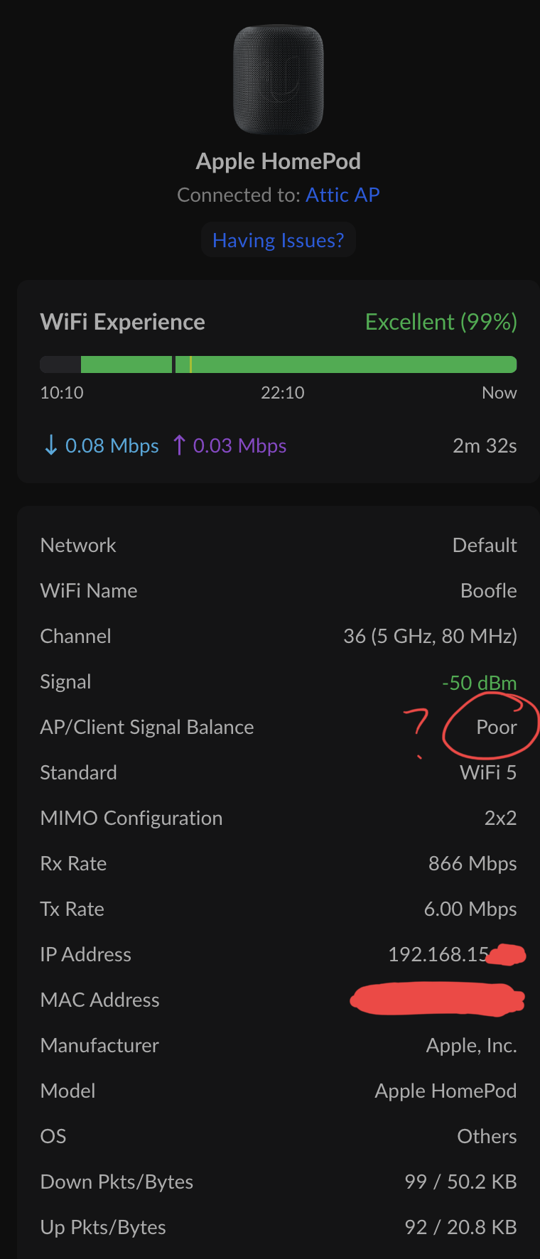

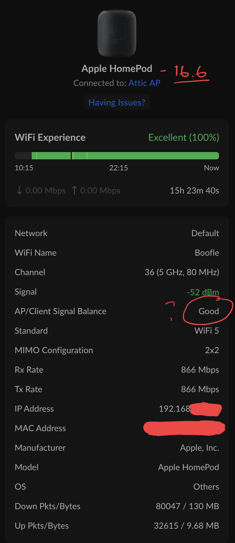

I have a Unifi WiFi network with a WiFi 6 Lite (U6-AP-Lite) AP in the room where the HP OG's are located, and I've had this AP for over a year without any issues.
So aside from being unable to upgrade to 16.6 on one of the HP's, I can't get the things to work properly anyway.

View attachment 2237971View attachment 2237973
