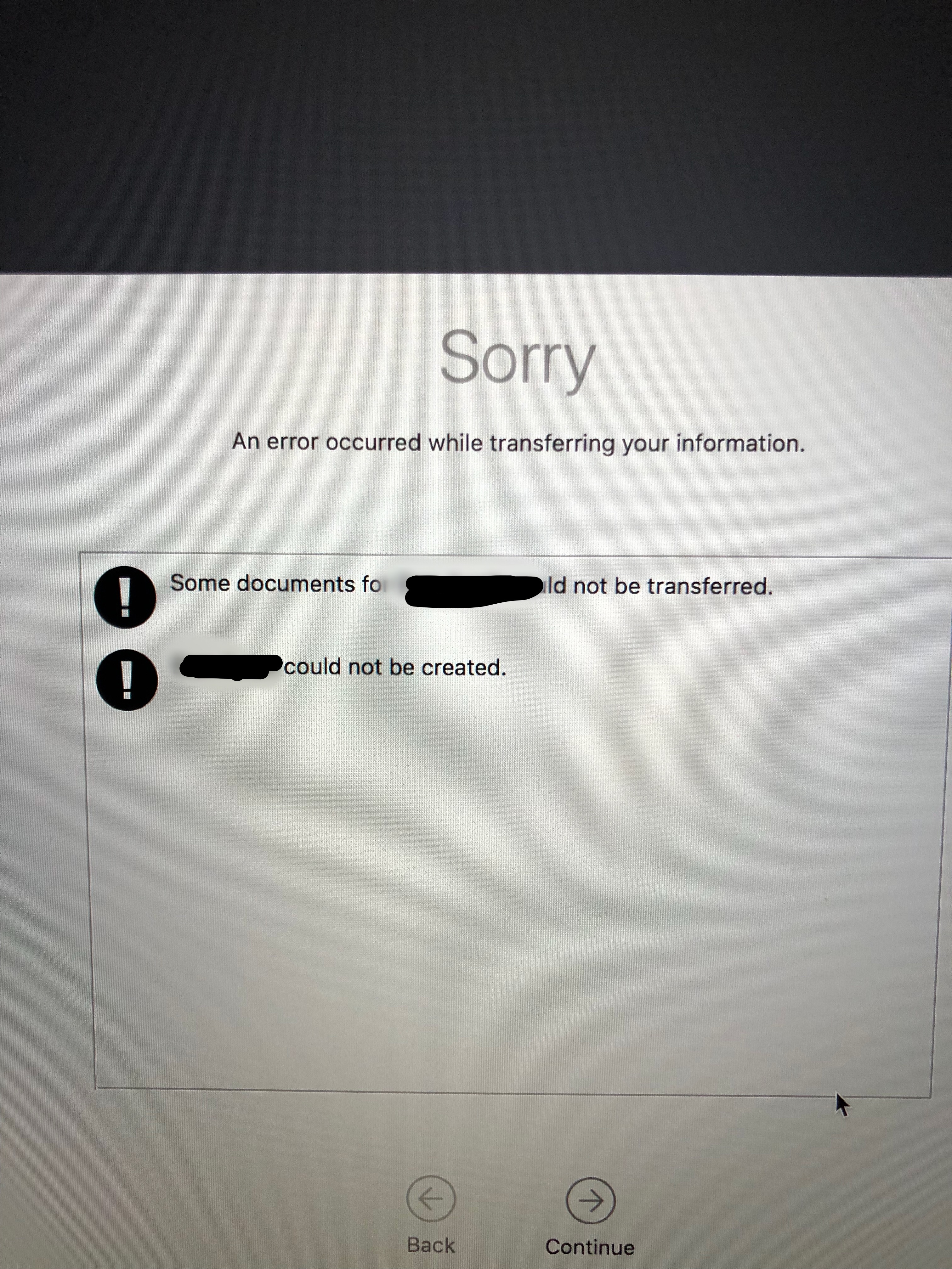

So then I do the same thing only using Migration Assistant to copy across from my old mbp. I use a TB 3 to TB 3 cable to connect the two mbps.
Cmd R to Disk Utility - erase disk, then reinstall MacOS so it starts in fresh setup.
Select setup from another Mac. I setup Migration Asst on my old mbp, they link, it correctly reports about 900GB to transfer. Passwords are entered as requested.
This fails in a different way (see pic below), and as a result data looks to have come across but virtually no settings have.
Any ideas how to get either approach working? I have a few days to decide whether to return it, and I have decided I am not going to install everything from scratch. Thanks!
