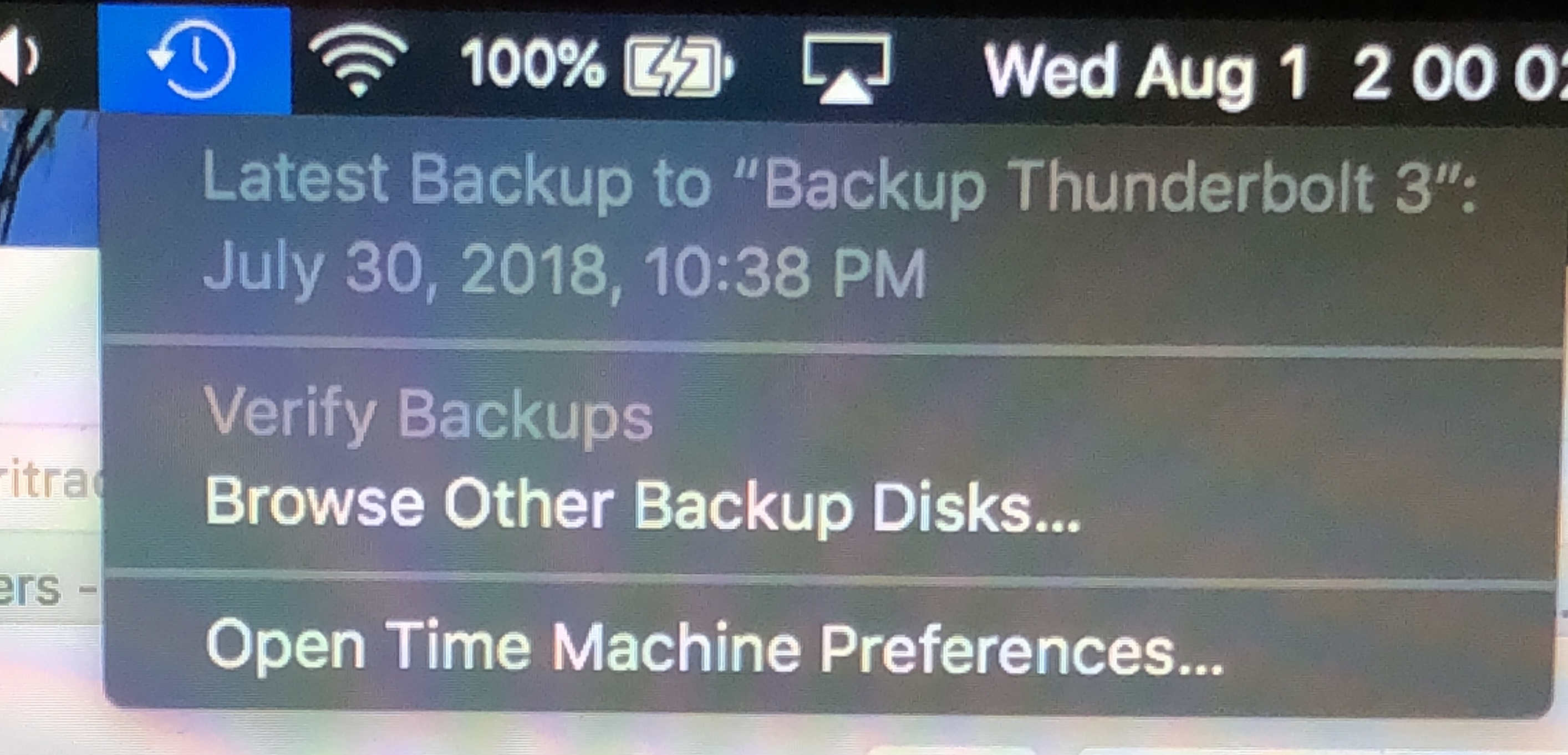

Thanks for the tip! I checked it, and when I use the Option key "Verify backups" continues to be greyed out - I tried ejecting/powering off/re powering on/plugging in drive, I made sure it was not in backup, preparing, or cleaning up or anything...see below.
Will need to use Terminal to verify then, as your Time Machine disk is not mounted in a Time Capsule or on a NAS. Can only verify using GUI if drive is network-attached.
Before doing that, turn off Time Machine and use Disk Utility to run First Aid on the drive. Then, if everything comes back ok, turn Time Machine back on, and then run this in Terminal:
Code:
sudo tmutil verifychecksums /Volumes/Name_of_Time_Machine_Drive
- Replace “Name_of_Time_Machine_Drive” with the actual name of your TM drive.
Note: It will take a long time, so just let it run.

Well I think you hit the nail on the head @duervo, the First Aid finished fine, albeit took a long time...but the verify checksum has reported all kinds of errors. It's been running since last night, so I decided, since my new mbp is now up (3 days after it arrived lol), and since I still have my old mbp with everything properly installed and data intact, to just erase/reformat and start over with the time machine disk on the new mbp.
I am thinking now that even though I was doing new backups it wasn't doing full backups of course, I think it links to original files if they haven't changed, and that must have been what's hosed further back in time.
I may, once I am sure the new mbp is ok and I don't need anything on the old mbp in a couple of weeks, erase it and try setting up new with a backup from the new mbp - while the old mbp doesn't have a T2 chip if that's the culprit, it will be nice to see the mbp come up ready to go in minutes instead of days!
Thanks for your help - I think you nailed the issue.
