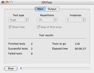

it half crashes. lets say you have the dual core running all '4' cores at 100% lets say 75% into the tests with 750 tests done and 250 tests left. it will freeze up and the last 25% or 250 tests don't get done. the '4' cores may show 100% or better yet one of the '4' cores will show 100% and will shift from the first core to the second core to the third core to the fourth core.
the last 25% of the tests do not get done. the machine cools done get a bit since only one of the '4' cores is stressed. I was able to get this to happen on both all 2012 minis using this program
http://www.macupdate.com/app/mac/23935/cputest
this did not happen when I tested the 2010 2.4 mac mini, but on the 2 quads and the one dual core 2012 it happened. I think it had trouble with the hyper threading or maybe the mountain lion osx.
the 2010 mini was using snow. the 2012 minis did this with the stock hdd the usb3 ssd and the t-bolt ssd. so for now I am not using cputest results on new minis. when I ran prime95 set on torture test small 1 2012 quad failed with rounding errors and 1 2012 quad did not get rounding errors the 1 2012 dual passed.
http://mersenne.org/freesoft/default.php
this is the link for prime95 set on torture test small
the 2012 mini does pass well one quad and one dual passes. I returned the quad that failed.
So if i understand it correctly, the strange behavior of cputest is the bug, not the actual "failed tests"?
In the picture above you see a section which displays "Failed tests"
The number of that was always 0 during the bug? It has never showed a another number than 0 on your second/replacement Quad Mac Mini? Correctly said, it had no errors but your problem was something else? (A bug)

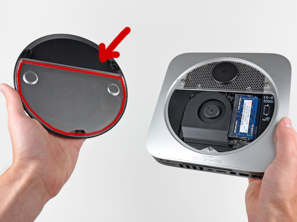

Yes. Mainly because with just 500um more they could've added a much better heatsink and a better fan. Not to mention 2 or 3mm longer and being able to put a larger fan. And tbh, no user would notice that at simple sight…
That's why I plan to mod it. I don't wanna be worried about temps. Also I don't wanna have a jet taking off under my desk every time I encode something using handbrake.
If I get to lower temps just 5ºC but manage to keep the fans in the lows 4500rpm instead of 5500rpm I'll be more than happy. :)
If you drill holes in the bottom make sure to have the feet either on the corners of the aluminium housing or otherwise close to the three studs.
Why? I was planning to drill THIS zone (where the antenna plate is and where air is swallowed in) and put 3 rubber stands HERE. Is that a bad idea?
(See attached photo)
Good locations - if you place feet on the area where there is no metal backing , i.e. somewhere in the location where the antenna grille is, then the bottom will flex.
