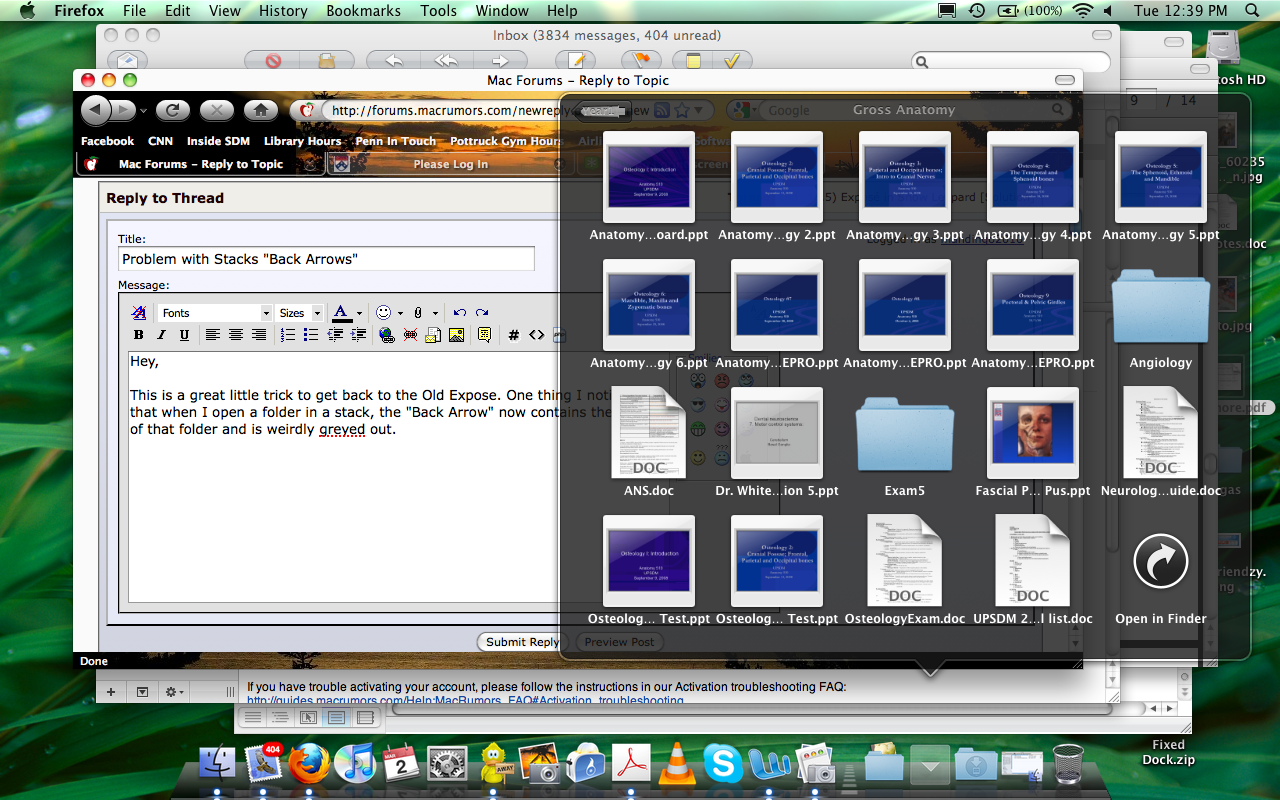

Problem with Stacks "Back Arrows"
Hey,
This is a great little trick to get back to the Old Expose. One thing I noticed is that when I open a folder in a stack, the "Back Arrow" now contains the name of that folder and is weirdly greyed out. Take a look.
Anybody else have this problem after reverting to this dock?

Hey,
Mandingo2010
It's a BETA.
