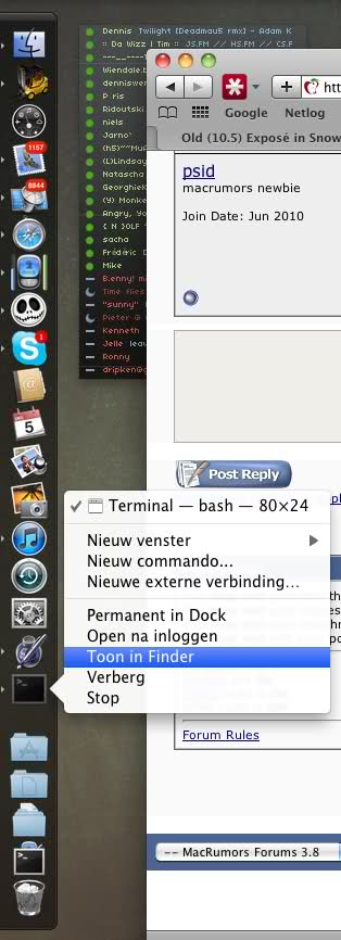

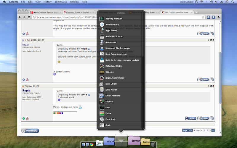

Translucent menus
The
defaults write com.apple.dock use-new-list-stack -boolean yes; killall Dock
fix seems to make some menus dark translucent, but the right-click menus are white. E.g. the Stacks are translucent (with many files inside).

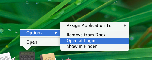

Here is a screenshot of it, check the About This Mac dialog box:
With the 10A380 Dock you also get back the white menus and a bonus "Assign Application To" menu if Spaces is enabled.
See screenshot:
