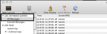

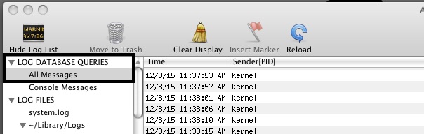

How do I get to "Log Database Queries"?
First you need to start Console then it should be the top line - see below picture....
Got it!! Still the only big issue is the Kodak esp 3.2 printer which is not connected. Though I'm not sure what I was looking for, but the only crash report was WORD failed to open, I relaunched, and opened right up. Nothing other than that.
