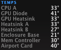

Hey guys,
I replaced the thermal paste of my MBP 2.4 Penryn, however not with the traditional Artic Silver 5. I replaced it with Artic Cooling MX-2; there is not metal substance in the paste which can cause corrosion. So, I opt for the MX-2. These are my temps idle. On load, CPU does not go above 60C degrees. I work on a glass desk, and the room is quite small so it can get warm.
I thought I give you guys my finding, and hope you might try MX-2 instead of the AS5.

Wow, that pretty good since you didn't replace your thermal paste. I on the other hand, the before temps were hovering around 50C idle. 🙂

I really do suggest ifixit guide, as I used it as a reference. My before temps were 50C idle and now like my image shows. 33C idle.
