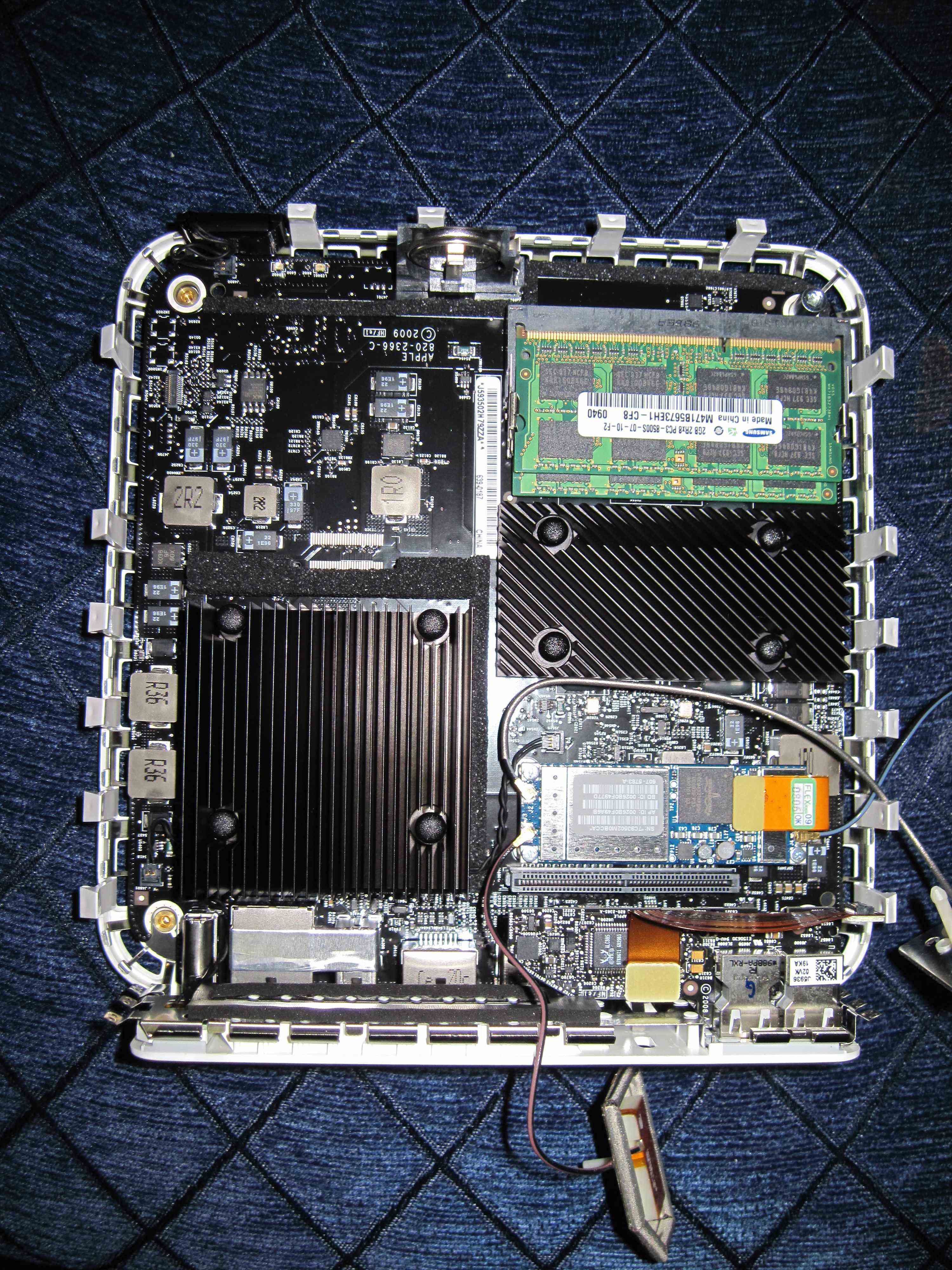

After installing 8 gigs of RAM in my Early 2009 Mac Mini the onboard sound card is no longer recognized, I opened it back up and could not figure out where a loose connection may be, there's the expansion card style connection from the top half of the Mini to the bottom (holds the disk drive, I think the harddrive and the sound stuff), and then the little orange cable that has a bend in it, but both of those are firmly connected... so I'm not sure where the problem could be.
Does anyone know what the problem might be?
if that cable is attached you are in trouble.. here is a photo this is the mother board. on bottom right is the copper cable it is attached to the mobo correctly.

look at the link and see the fully assembled mobo and top with the cable

I assume you mean that is the one thing I could possibly fix? 🙁

Ok so, that's just a back story, sorry, fact is I've had the same issue after opening up one of my Minis and I'd bet $100+ that the DVD drive cable just isn't in **ALL THE WAY**. I opened it up after Googling your exact issue, refitted it, still didn't work.
Then tried it again, but this time since I accidently broke the very small plastic retaining clips that I thought came off a different way then they really did (I know I know, rule of thumb *never* force anything regarding computers), so I took a piece of strong tape and held the cable in place and now works perfectly.

So I'd just try checking the cable - multiple times if necessary - before assuming anything else. Let us know if it fixes it?

Also, that's what I was thinking, but it looks to be in place... I think... I could give it another go, not exactly doing anything right now
