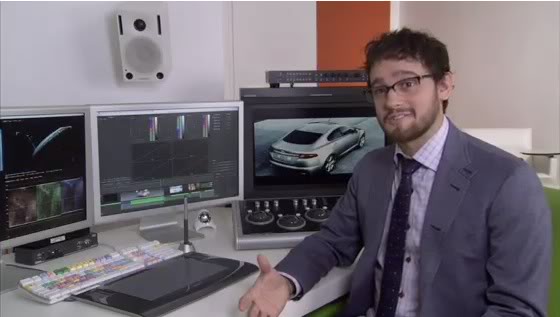

Saw this at Apple's site, and wondering if the black monitor on the right a broadcast monitor?
What is the black console in front of the black monitor anyway?
This guy is using the old Apple keyboard, but wth did he get the coloured key caps from? A lot of questions for video noob like myself it seems! 🙄
Yes, a colorist's control panel (for use in color correcting apps like Color), and from a place like this. 🙂

Mmm... I can't seem to find the control panel in the said link.
Care to provide a link to it? Thanks.
I'm pretty sure it is a JL Cooper EclipseCX. Link
As far as control panels go it is on the low-end at around $5k.

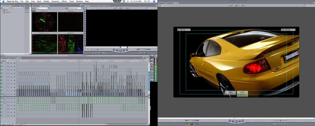

This is the layout I currently have on my two 19" Viewsonic VX922's, it changes slightly depending on the job.
