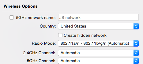

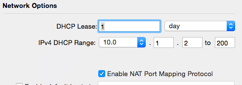

I am wondering if one of my time capsule settings are wrong in airport utility. I attached some screen shots below of my settings... I tried adding a 5ghz network and no luck

Am I missing something here, there is no checkmark in the checkbox next to the 5GHz network name. That has to be checked to activate the 5GHz network, if I am not mistaken.
By default, an AirPort puts the 2.4 GHz and 5 GHz bands on the same network name (SSID) and lets the client and the base station auto negotiate to find the best band.
sorry in the screen shot I had removed the checkmark. I did check it off and use the 5ghz network. but same results
