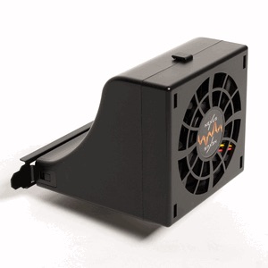

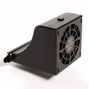

Do you think that a USB powered fan pulling air out of the empty PCIe slots would have any effect or would it be too gutless?
i guess a fan like this may be more effective than a normal USB fan to pull the hot air out.
However, I never use it by myself, so can't give any comment, other than it may destroy of the beauty looking of the cMP 😛
While any of the PCI-e slot fans mentioned above would exhaust the hot air out of the Mac Pro, they will also generate more noise, take up a slot, and will require routing another set of wires to power the fan. I wish Apple had included a little exhaust fan above the PCI-e slots.
