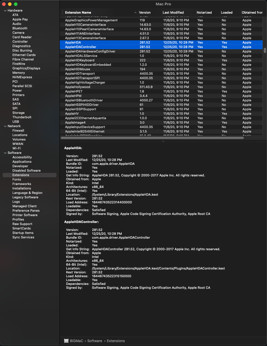

I just looked in my patched Big Sur install with WORKING AUDIO on my 3,1 and found TWO AppleHDA.kexts!?! One was loaded and the other (AppleHDA.kext2) had only a controller component loaded? These were patched by Jacklukem's Big Sur basesystemfix USB installer patch. Perhaps you can load them via OC and get audio to work?

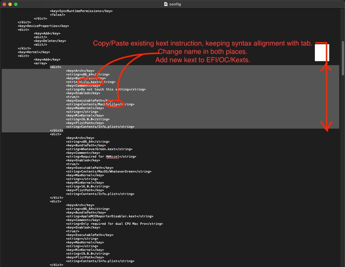

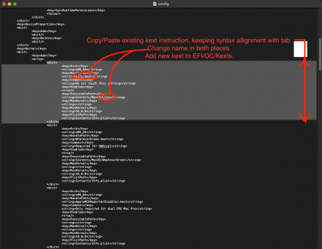

Haven't tried injecting kexts via OC yet. Still a little unfamiliar as to how to properly setup config.plist for AppleHDA.
You can simply copy an existing kext instruction from the config.plist and replace both xxxx.kext names with new yyyy.kext name and place the kext in EFI/OC/Kexts. OR just patch the damn thing with Jacklukem's basesystemfic like I did! LoL!
That easy huh? Was thinking other keys like MaxKernel or MinKernel needed alteration.
And yes, forgot about AppleHDAController.kext. I believe that would have to be replaced as well. Thanks for providing both.
