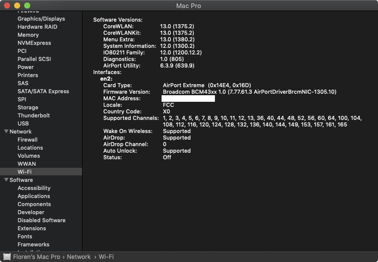

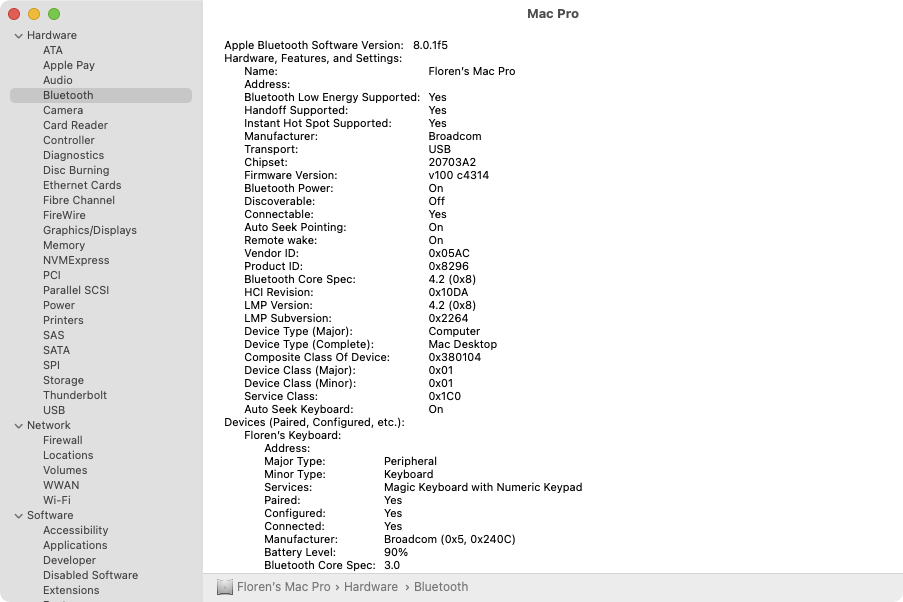

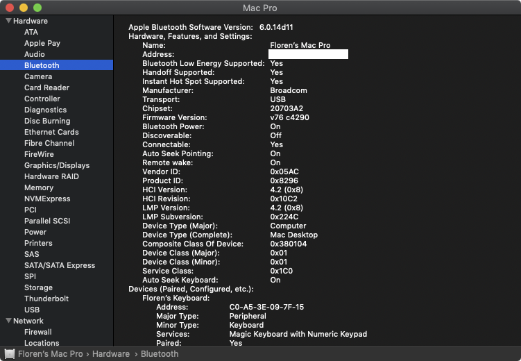

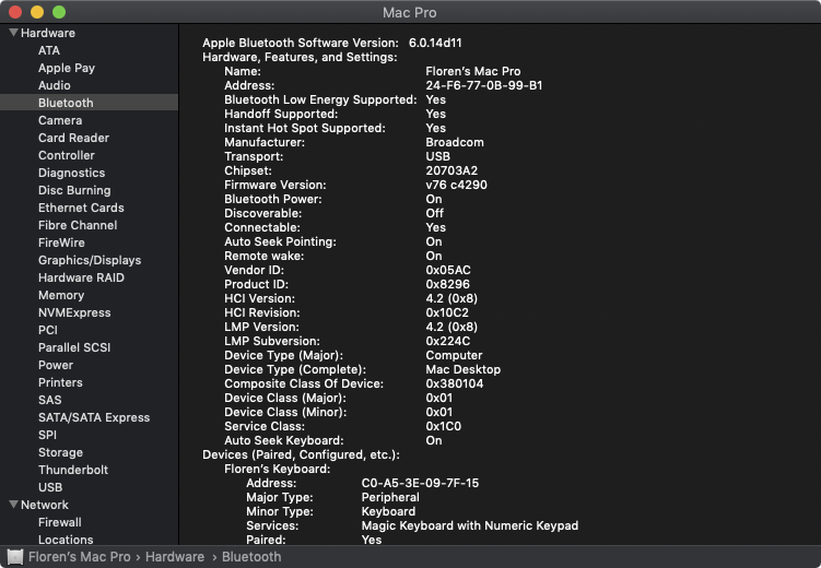

Details from Mojave:

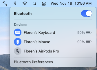

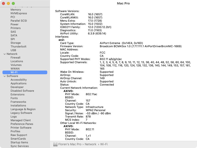

Details from Big Sur:

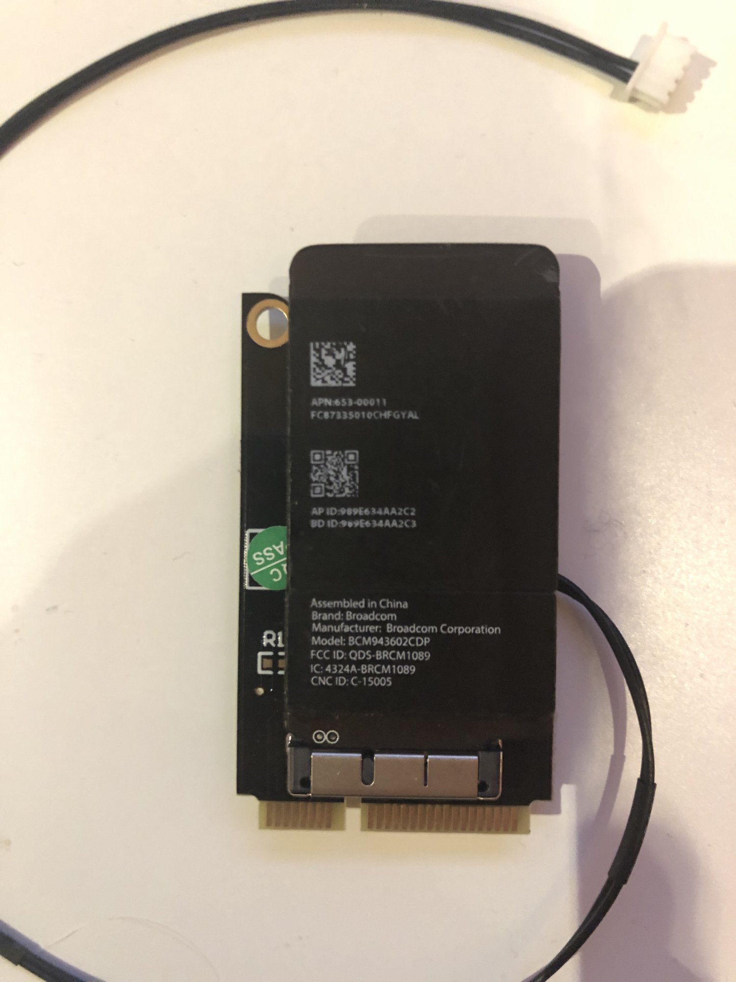

This is the card I use:

Just checked Mojave and my card is using the BrcmNIC here.
Can you please let me know how do you determine what kext your card uses? What is your current plugins content in Mojave? This is mines:
Code:
$ ls -lh /System/Library/Extensions/IO80211Family.kext/Contents/PlugIns/
total 0
drwxr-xr-x  3 root  wheel    96B 12 Mar  2019 AirPortBrcm4331.kext
drwxr-xr-x  3 root  wheel    96B 12 Mar  2019 AirPortBrcm4360.kext
drwxr-xr-x  3 root  wheel    96B 12 Mar  2019 AirPortBrcmNIC.kext
drwxr-xr-x  3 root  wheel    96B 12 Mar  2019 IO80211NetBooter.kext
The Mac suddenly rebooted while in Big Sur and brought me back to Mojave. I did not wanted to take any chance and I did a NVRAM reset, then the usual double reboot to gain back Bluetooth. Here it is my Bluetooth info in Big Sur:
Can you please let me know what card brand and model do you use? With all this headache, might as well buy a new card that fits into current adaptor.
System Info - look under network-wifi:
Interfaces:
en2:
Card Type: AirPort Extreme (0x14E4, 0x111)
Firmware Version: Broadcom BCM43xx 1.0 (7.77.111.1 AirPortDriverBrcmNIC-1669)
Just using a 94360CD from eBay. However, I remember other users having problems with some cards causing reboots. Not all these cards seem to be created equally! Best bet is one from an Apple computer but mine seems to work so I was lucky. I also have one in my cMP3.1 which has worked perfectly. It is also using the BrcmNIC in Catalina. Not updating this machine to BigSur.

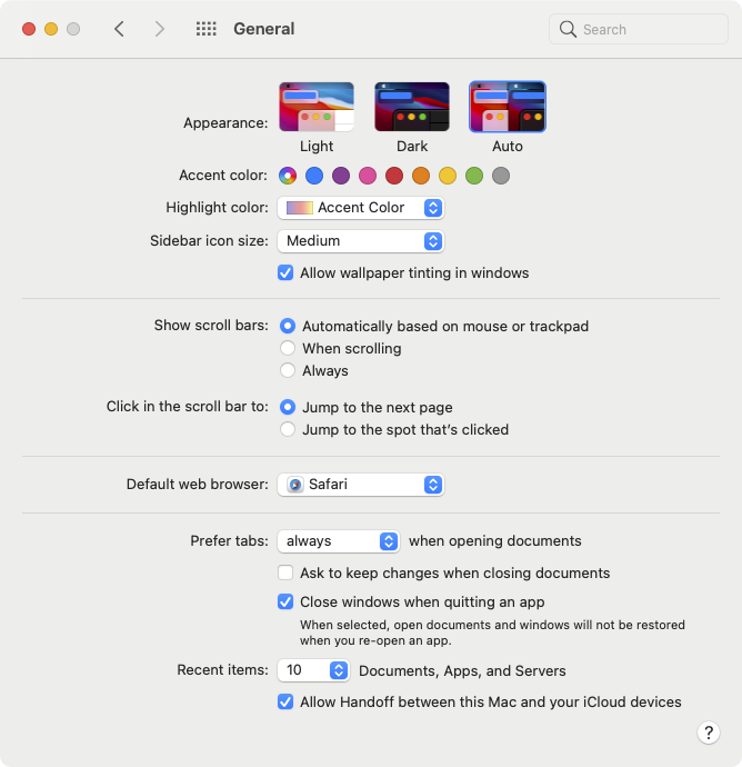

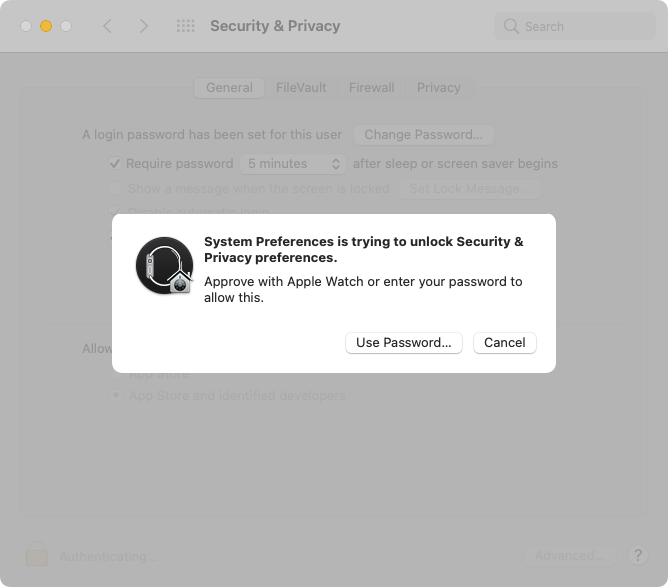

I just noticed Handoff features that used to work in Catalina are now gone, I cannot paste anymore from my iPhone to my Mac. Unlocking with Apple Watch still works though.
Mines was pulled from an iMac at least this is what the vendor said. From my perspective, if people had issues with the actual hardware, the issue would be present everywhere, not just Big Sur. I never experienced any issues with the card, until I started using Big Sur. It is showing the same firmware in Big Sur:
In Mojave, still showing AirPortDriverBrcmNIC:

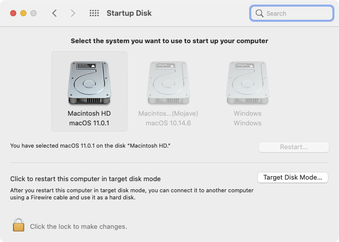

@DanSilov do you have OpenCanopy installed? If you do, try this: Make sure your default startup disk is Big Sur, by default they are all greyed on a new Big Sur installation:
Next, restart your Mac and select in OpenCanopy the Mojave disk. Then, enter your password to unlock Mojave, restart and select in OpenCanopy the Big Sur disk. You should experience a Bluetooth failure. If you reboot again, Bluetooth will be functional again.
