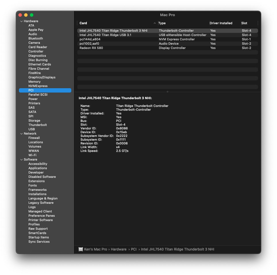

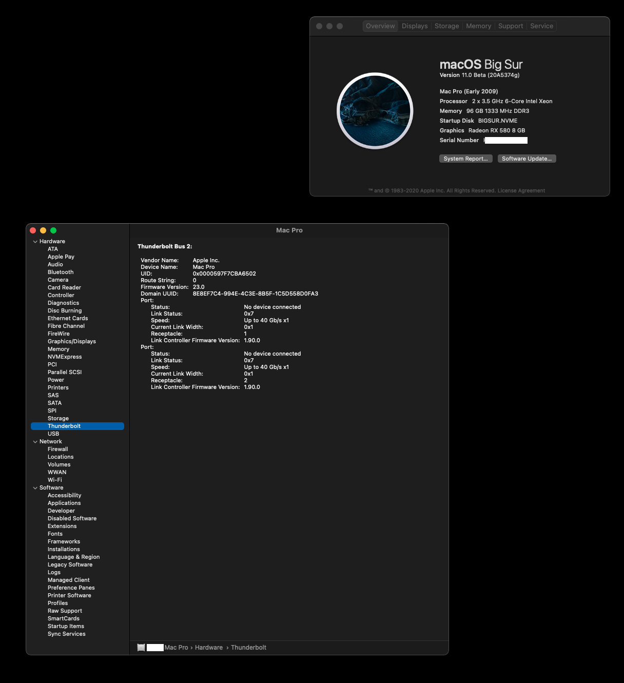

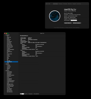

I got OpenCore installed on my early 2009 MacPro4,1 flashed to MacPro5,1 -- running the latest Big Sur beta, Beta 7 (20A5374g).
GC-Titan Ridge on Slot 4 also shows up correctly.
Please see the screen shots attached.
