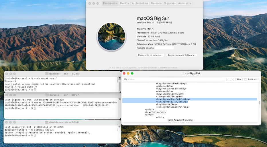

I add also that from recent BigSur releases to disable SIP without a "Custom Configuration" this value for OpenCore worked csr-active-config: fwgAAA==
I'm intrigued by your comment. Is there a way to disable SIP from the OpenCore config.plist? I've looked up "csr-active-config" in the OpenCore Reference Manual (0.6.1) and it appears its use is frowned upon as a possible value for NVRAM LegacySchema. If this is possible at all, can you give us an example of the relevant config.plist parameters that will disable SIP and the relevant parameters to undo that change on shutdown?
I guess you referred to a previous opencore version 0.6.0 , but seems from 0.6.1 setting SecureBootModel Disabled is required to boot BigSur on unsupported Mac, and either with Disabled you can have a snapshot booting and OTA update, while to disable snapshot booting this should work to fix "sudo mount -uw /":
https://forums.macrumors.com/thread...unsupported-macs-thread.2242172/post-28958380
Thank you to clarify this!Then it behaves differently on other hack, sorry for the ot (I was quite sure it was the same).
I was referring to the latest master version, updated as of today.
SecureBootModel=Disabled
SecureBootModel=Default

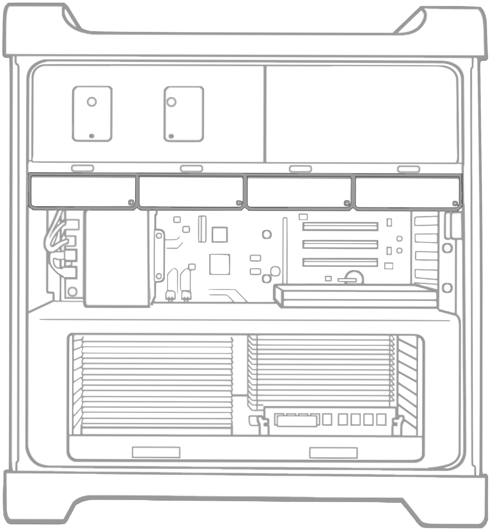

Someone might of already asked this, and i know its completely unrelated but where/how did you get that image for the about this mac?
Haha, I get this question every months, either in this forum, via PM, or other facebook group.
It's extracted from the Apple Technician Guide (with little bit of Photoshop skill).
I know the one you are talking about, im not very good at photoshop and everytime i try to edit out the gradient background it just ends up looking very messy and rough. Would you possibly mind sharing your photoshopped one?

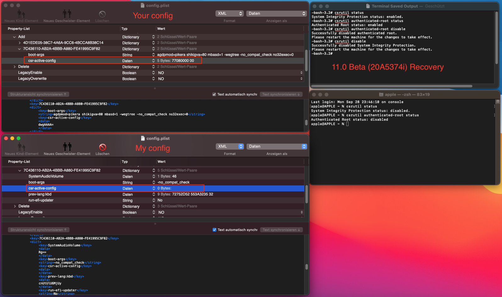

Using this csr-active-config dwgAAA== works to disable SIP correctly on Catalina and previous macOS, but on BigSur csrutil status with "Custom Configuration" and csrutil authenticated-root disabled.
Instead this new value fwgAAA== works to disable SIP correctly on BigSur and authenticated-root, but on Catalina and previous macOS SIP is in "Custom Configuration".
Here is the config.plist example :

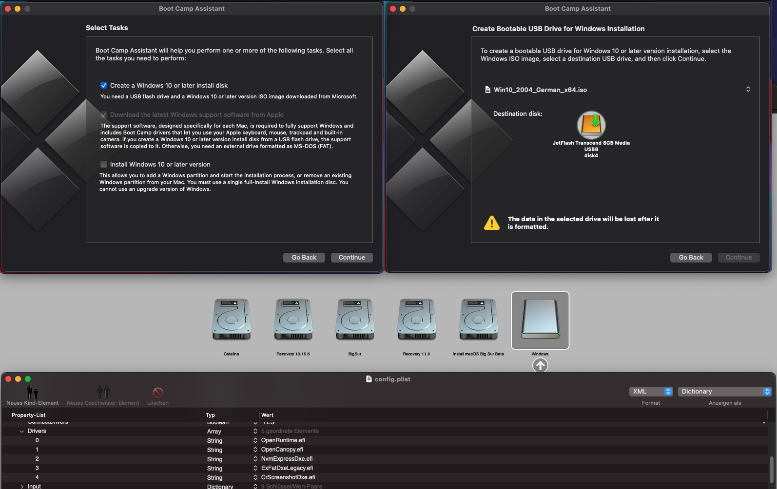

Thanks for the reply. I got OpenCore installed. Finally got the boot selector to show up. So now I am trying to install Windows 10. I followed the steps and tried 3 different USB drives, but none of them show up in the boot selector.
I used Mac to format the USB into the exFat MBR, copied the windows iso with rsync to the USB. Updated the config and copied over the exFatDxeLegacy.efi to the drivers folder and added the line to the drivers array in config. Not sure what I am doing wrong.
Edit: I figured it out, there is a mistake for following the copy command too closely.
Everything works, do install Windows USB, via Bootcamp

Regarding the csr-active-config, how do you convert the values fwgAAA== to the hex-string? I want to disable kext-signing in Mojave, so I found that the value of csr-active-config should be 01000000. But how do you convert the value 0100000 to something dat is the same data-format as the example here?
if you use Xcode plist editor you could type directly the hex value.
Reactions: rippiedoos

Thanks for the website and conversion. Didn't realize it was HEX so I first tried converting it as a string. Now it works, thanks! kext-signing is now disabled!

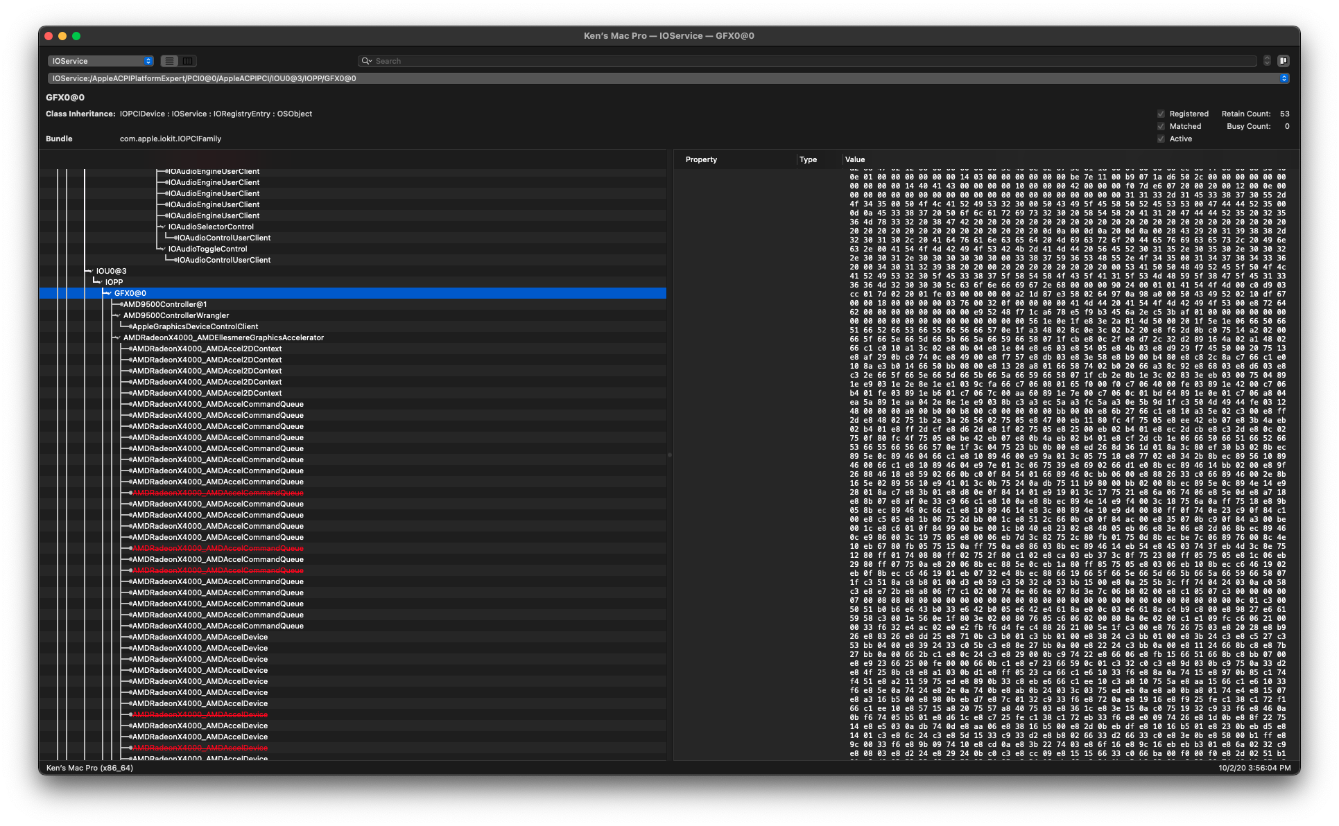

I installed Big Sur Beta 9 last night on my MacPro4,1(5,1) running OpenCore 0.6.1 with RX580.
Odd thing is that HEVC hardware acceleration is now listed as unavailable by VideoProc. Only H264 is listed as available.
To troubleshoot, I booted into macOS Catalina with the same exact hardware and OpenCore configuration, and Video Proc reported that both HEVC and H264 hardware acceleration are available.
Does anyone know how to resolve this and get HEVC hardware acceleration back? I have not encountered this issue in the prior Big Sur betas, so I assume Apple did something to Beta 9.
I have some family issues and stopped all Big Sur testing.
However, please check the GPU's ident in IOReg. You may need to manually patch PXS1 to GFX0 in order to make HEVC HWAccel work again in Big Sur.

Hi, thank your for the suggestion.
However, using HackingTool, it seems that the RX 580 is already identified as GFX0 in Big Sur Beta 9. See attached screenshot. Regardless, I tried your suggestion and inserted the patch segment you suggested into my config.plist's ACPI section and rebooted under OpenCore.0.6.1. I then did a check for HEVC under VideoProc, and it is still showing up as Not Available.
Anyone has any idea how to get HEVC hardware acceleration back in Big Sur Beta 9? I am using RX 580 in Slot 1 on a MacPro 4,1/5,1. This problem did not show up until Beta 9.
Big Sur Beta 9 killed HEVC encoding on AMD GPUs. Might be just a bug... or they are enforcing T2 for encoding now. Decoding HEVC still works fine.
I do not think this is just a bug, I could be wrong but more inclined towards " they are enforcing T2 for encoding " I also read somewhere that now to watch Netflix 4K you have to have a T2 ... Isn't it related?
I hope I am all wrong...
Netflix playback is decoding and as I said, this still works. We will see if it's a bug or not. Apple killed HEVC encoding on AMD GPUs in the past by mistake. This even happened in a final release (I think it was back in Mojave). Wouldn't surprise me if they just introduced that bug once again.
