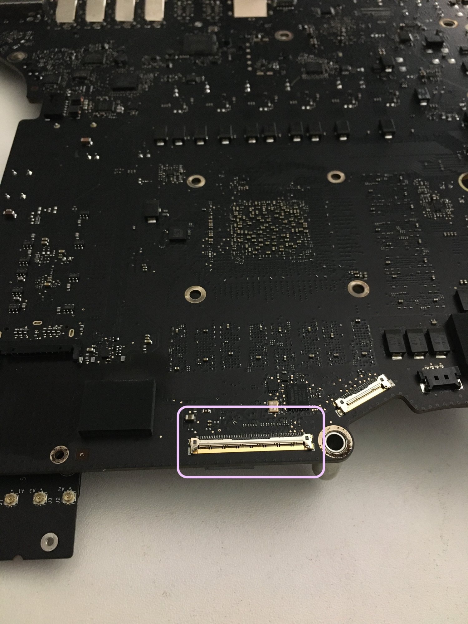

I have rebuilt the late 2015 to a DIY 5k Display. And I have upgraded an iMac Pro.
I assume you have the iFixIt kit with the adhesive and the cut tool. The cut tool is important. It is made of plastic, and the wheel will cut to the correct dept. Also good to have the two suction cups, to lift the panel up in top end.
I use a "stand" to hold the panel in position while removing the ribbon cables. The stand can be whatever material that isn't metal or sharp. Preferably something like a small box perhaps, to prevent it from tipping over.

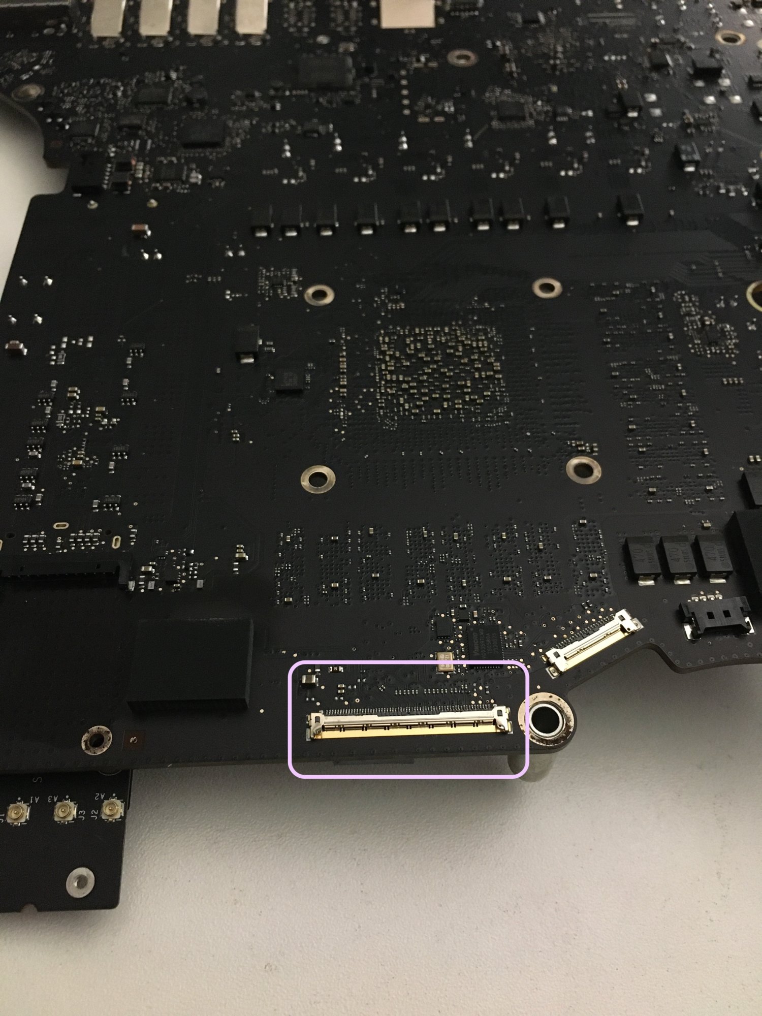

If I remember correctly, the ribbon cable has a metal clip that locks it on position. So do not try to pull the ribbon cable out before releasing the clip.
When you screw the logic board back in, connect a few USB cables to fixate it in the correct position, or an USB and a SD card.

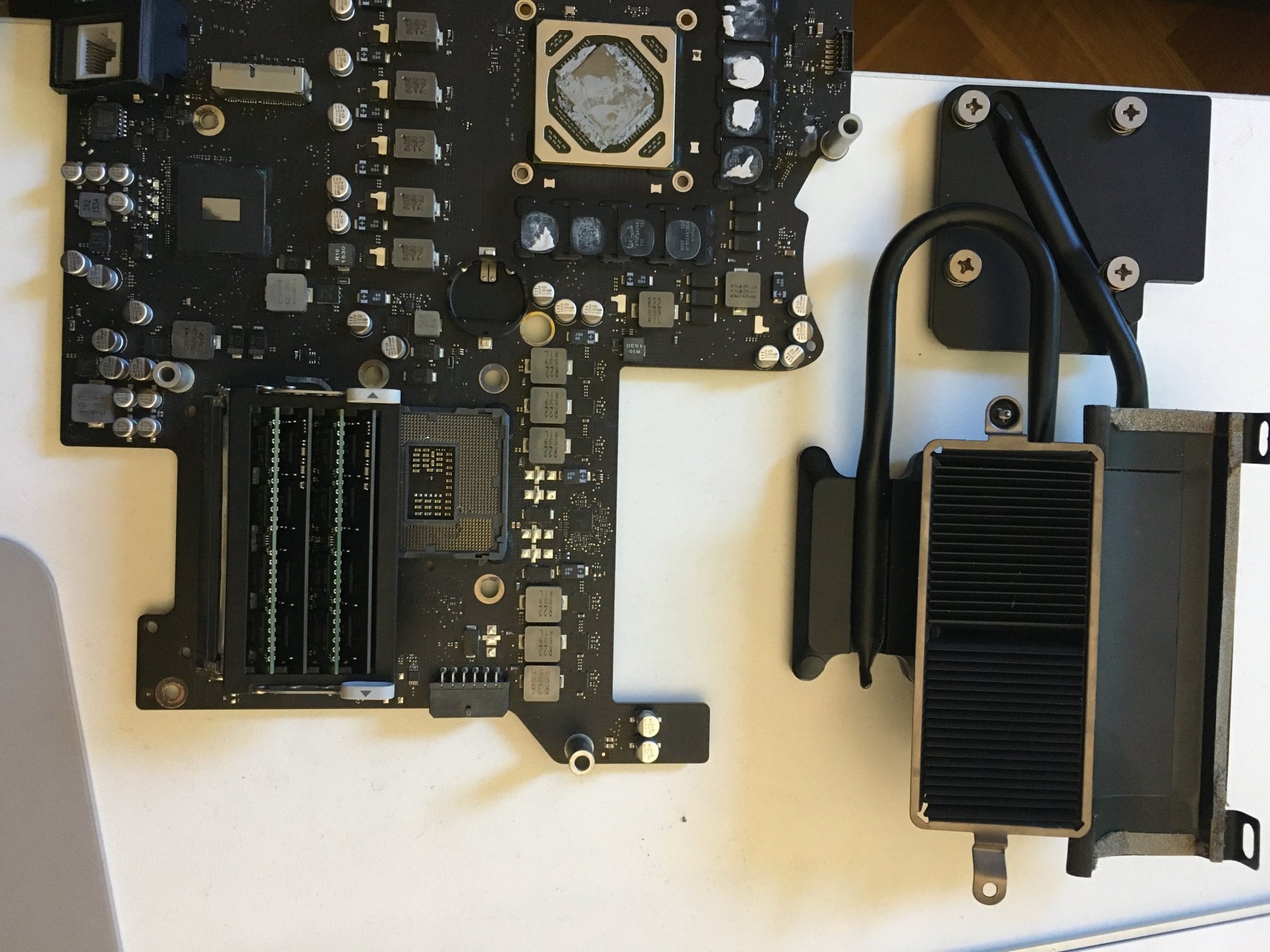

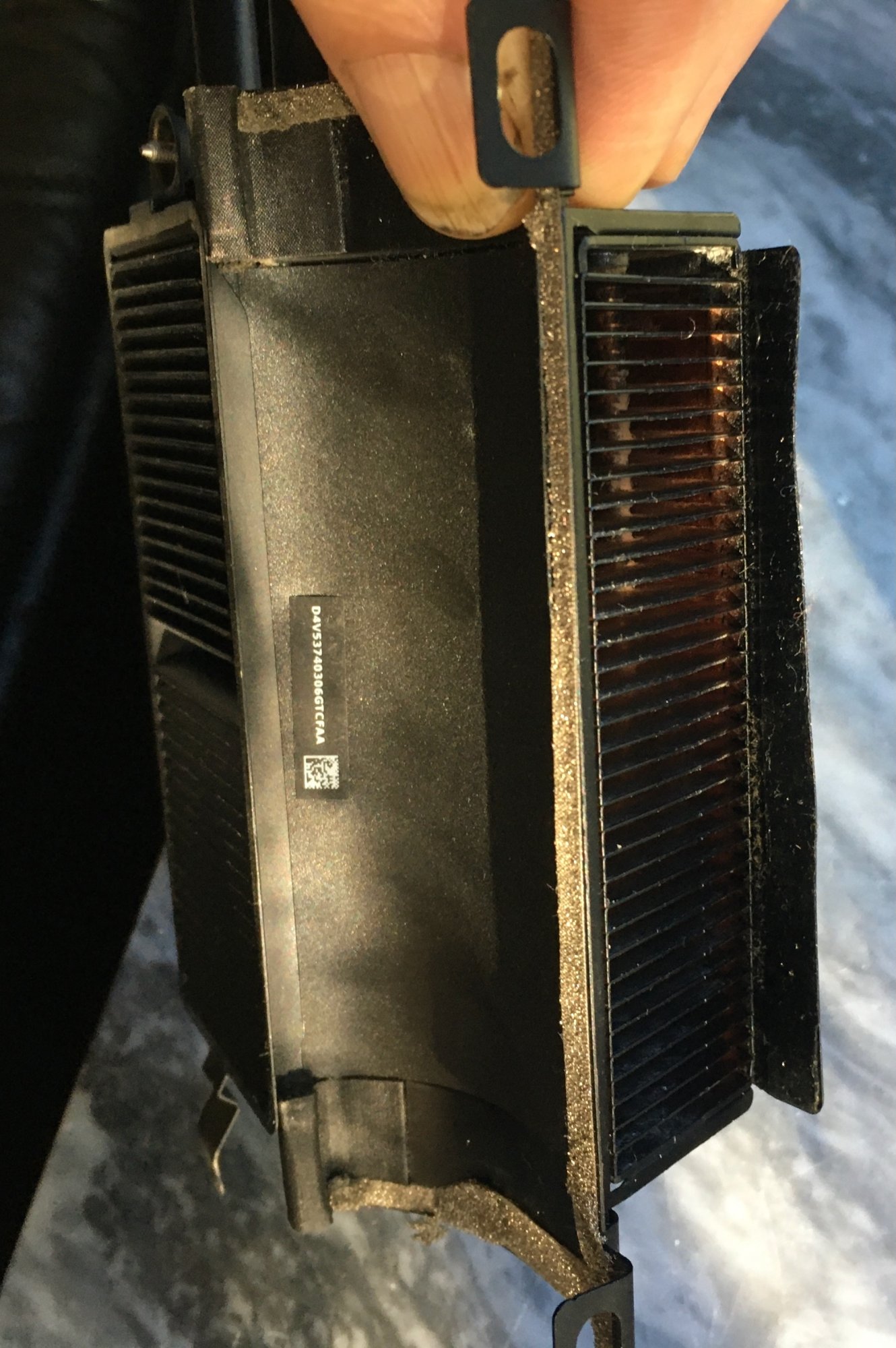

I bought the iMac Pro second hand. And it ran hotter than my own iMac Pro. So I decided to open it up and clean it, and using the opportunity to upgrade it.
There was far less dust in it than I would have thought. I used good quality cooling paste on the CPU and GPU.
The exhaust air is no longer hot, and much cooler now.
So I am not sure if it was the dust cleaning that lowered the temperature, the new cooling paste, or both.

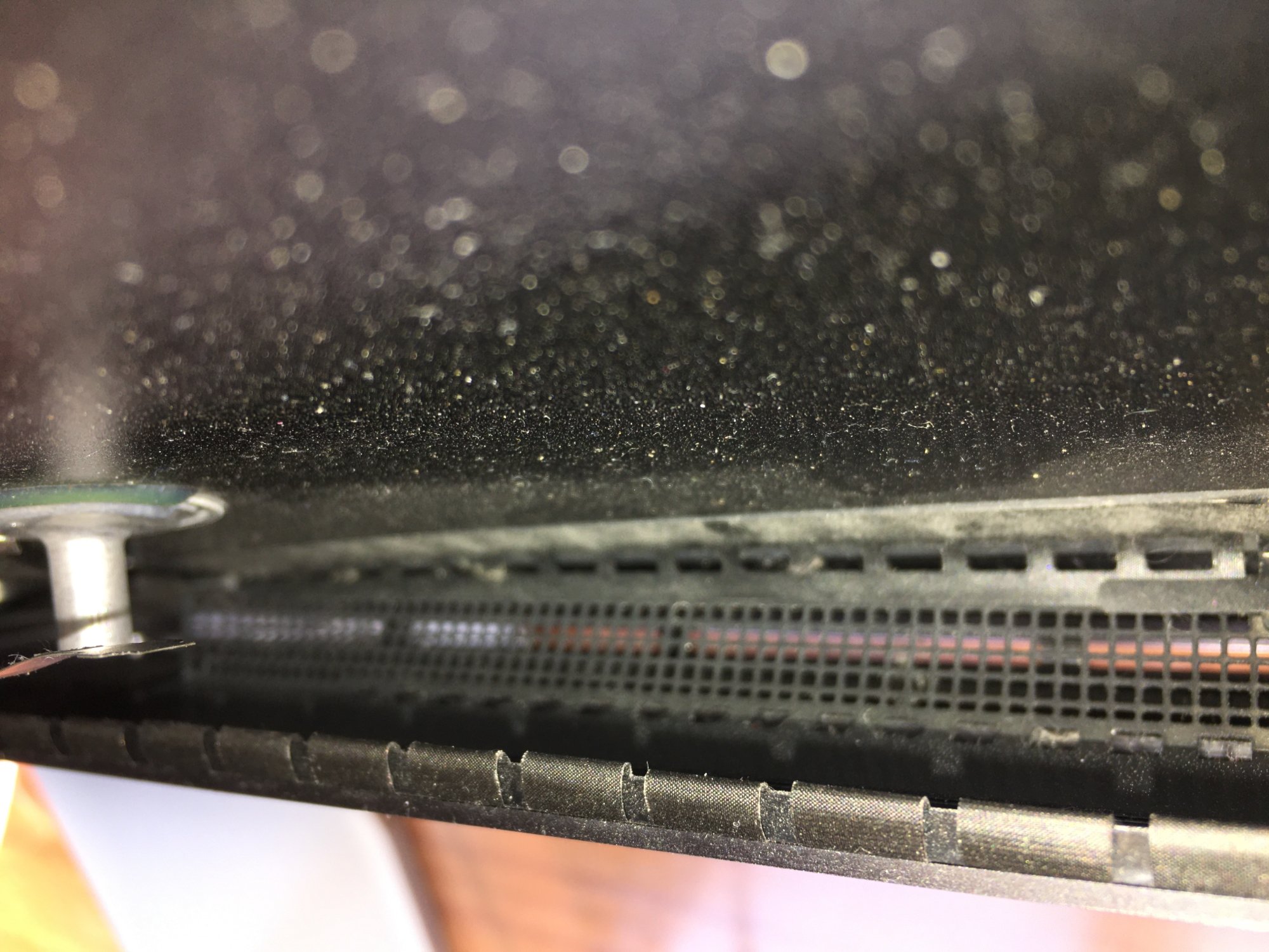

Using a vacuum cleaner to suck dust out along the full length of the bottom intake, and from the outlet vent behind the stand. I would not use pressurised air to blow air in, as that would damage the filter in the intake for sure.

The most important thing is NOT to use a metal slicing blade along the top of the iMac, as if is inserted slightly too far it slices right through the ribbon cable taking the signal to the screen matrix.
Instantly producing a vertical black line below the cut, which is unrepairable and ruins the screen.
If the pizza wheel doesn’t quite cut through the adhesive then only use a soft edge plastic guitar pick to finish the cut.
It’s not difficult, but care is needed…

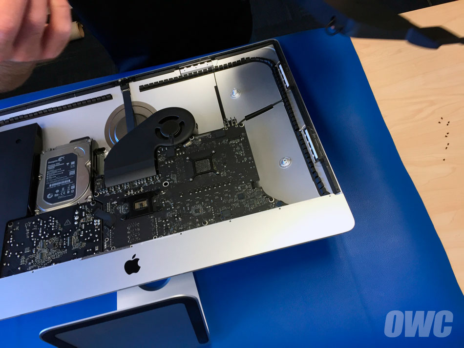

iMac 27" late 2015 parts
I could not find my iMac fan, but the logic board and the cooler with air duct is shown here. So I added the photo from OWC.
I do not see how blasting in air would be useful, especially up in the air vent intake. It would very likely cause the dust filter to be torn up.
