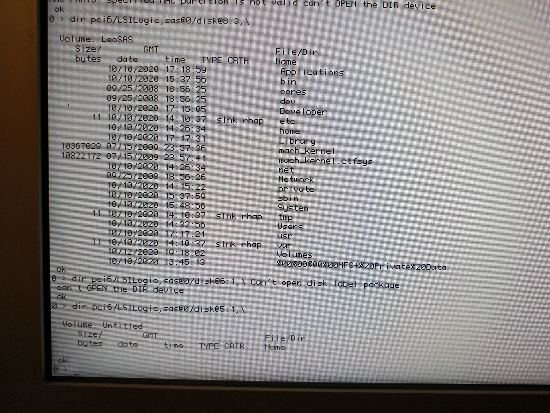

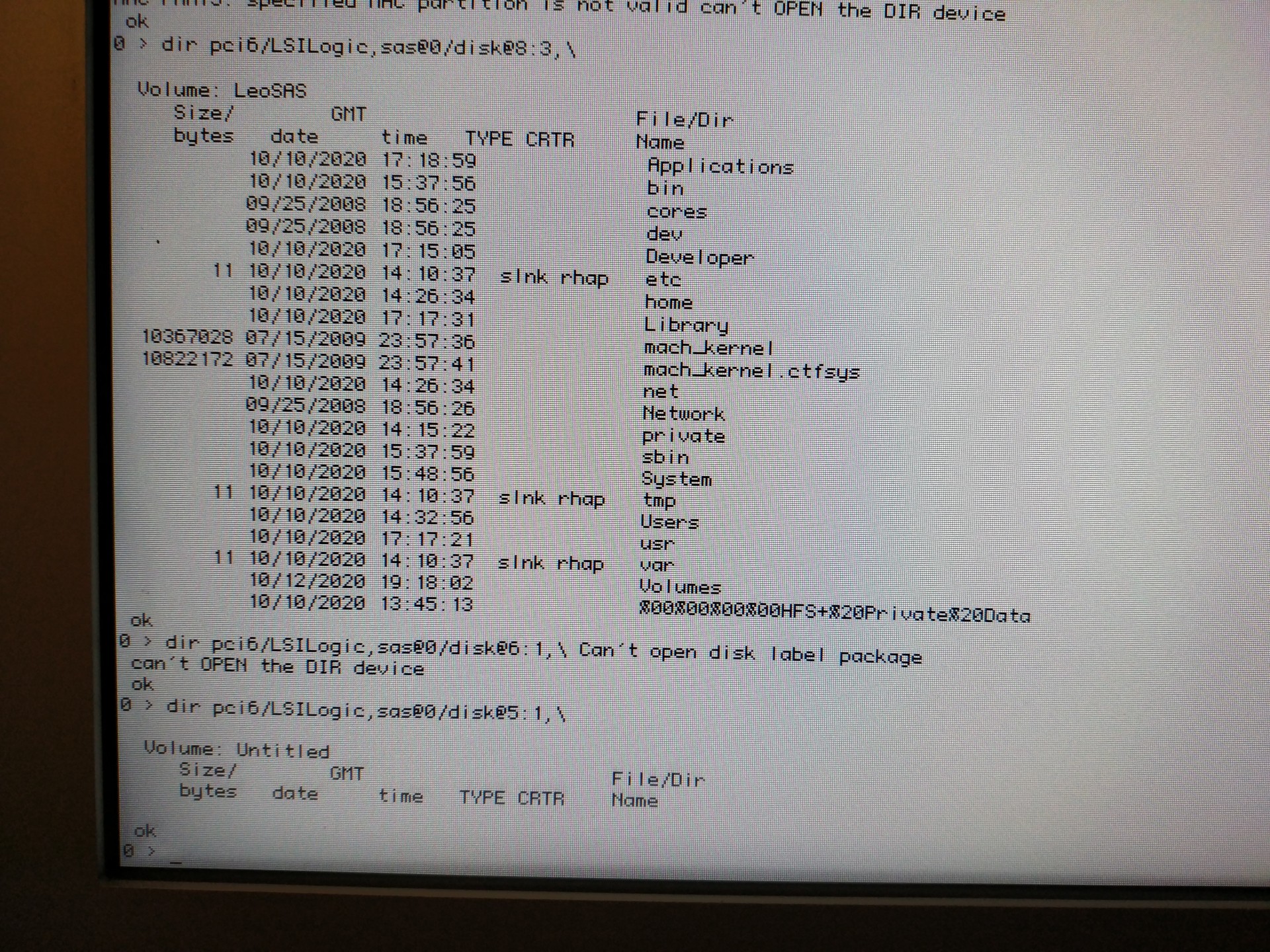

So, the battle continues. Installed SUBJ to SAS drive (it's numbered as disk@5 in OF console, GPT partitioning). (BTW, is there any way, how to check patition style in OF console, really? 🙂 ) But, as expected, there are now boot loader, nothing, what OF can read. Only first partition, which I made as HFS, named Apple_boot, partition type 50 in gpt fdisk. attaching picture. Obviously, drive@8:3 is macOS Leo. So, is there any way to install some boot loader to partition, visible to OF & try to boot from there? (GRUB installed in Gentoo detected OpenSUSE, but it's unbootable, as it can't find partition by UUID in config). (For God's sake, anybody, pls correct my spelling, I feel it IS awful 😀 ).

@Tratkazir_the_1st You can make a Debian install disc or USB stick, and enter into its built-in rescue mode to chroot into OpenSUSE's filesystem. If a spare partition is available in at least 1 MB of size, you can then use yabootconfig -b /dev/sda(x) to install a rudimentary bootloader into said partition, depending on its hierarchical position in the partition map.
That said, I don't have any experience with OpenSUSE and have no idea if this will work, but perhaps it is worth a shot at least as far as bootloaders go.

So, the battle continues. I have installed SUBJ to a SAS drive (It's identified as disk@5 in OF, with GPT partitioning. - BTW, is there any way to check the partition map within OF? 🙂 ). But, as expected, there is no boot loader that OF can read. Only the first partition which I formatted as HFS, and labeled "Apple_boot", with partition type 50 in the GPT fdisk tool. I am attaching a picture.
Obviously, disk@8:3 is macOS Leopard. So, is there any way to install some boot loader to a partition visible to OF & try to boot from there? (GRUB installed from Gentoo detected the OpenSUSE installation, but it's unbootable, as it can't find the partition's UUID.)

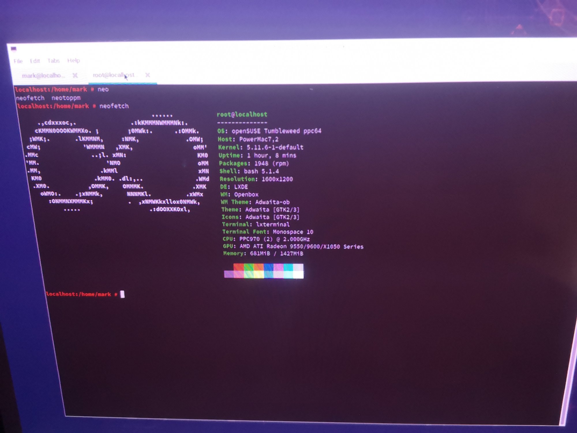

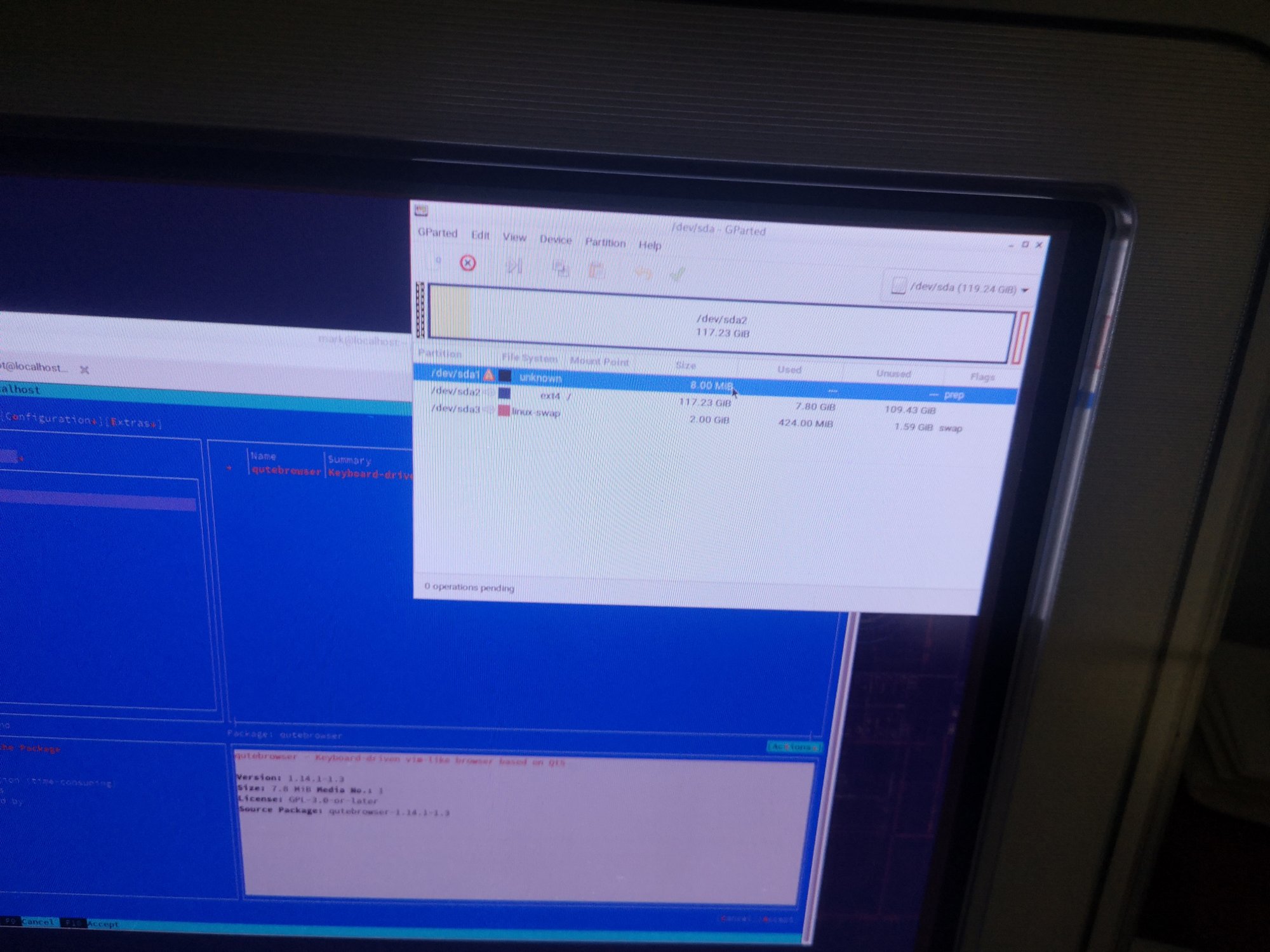

I managed to install opensuse tumbleweed on my g5 with lxde desktop environment. At the moment, I am booting with a live CD from a different distro. I need to fix the partitions in order to either use grub, which I know is difficult, or install Yaboot. Any recommendations?
1. Download the PPC 64 version of tumbleweed and burn to DVD
http://download.opensuse.org/ports/ppc/tumbleweed/iso/
2. My video card that some issues with some of the desktop environments, and on top of that installation doesn't seem to go well if I do any of the suggested desktop environments within the installer. That said, I specifically choose server mode with no desktop.
3. When yo go to format the paritions make sure the OS is ext4
4.Let the install finish.. I did select the third party repositories
4. Boot a live CD like Adélie
https://www.adelielinux.org/download/
5. Boot up to the live CD
7. select c to get grub menu.
8.. Enter ls make sure you see the entry in the next step.
9. Enter the following:
You can tab both Linux, Initrid, and the /boot directory for autocomplete. Also, make sure you use the guided partition during the install and when formatting the ssd. Otherwise, the below might not match. In that case, you will need to make sure you know the partitions or just guess. When you are in grub - type "ls" and try each ieee1275/hd,gpt<1-x> until you find the boot partition.
root=(ieee1275/hd,gpt2)
Linux /boot/<VMlinux kernel> root=/dev/sda2
Initrid /boot/<initrid>
boot
Some of the of the above is dependent on your configuration.
