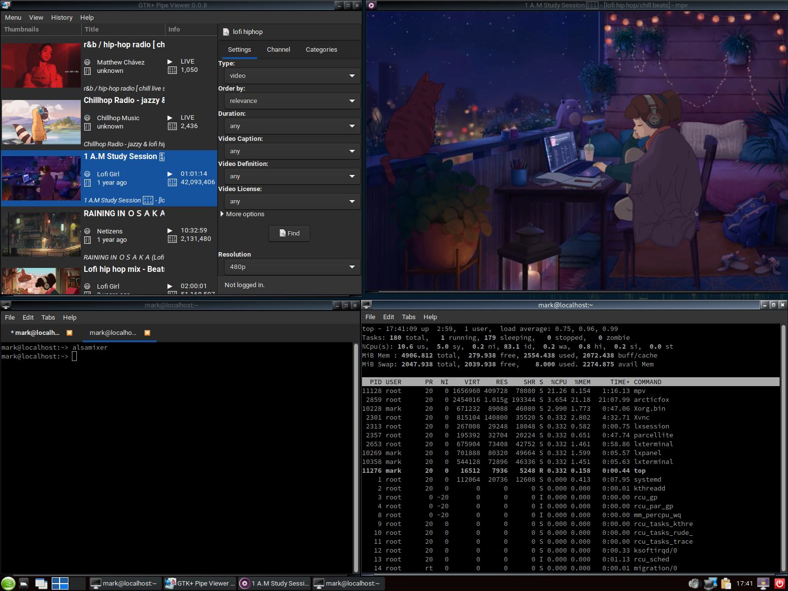

I was able to get youtube working. I am using pipe-viewer, a fork of staw on my opensuse build

Cool. Thanks to both of you. Pipe/Straw-viewer, which I believe was also reviewed, where's great. The command line is nice and fast.. I will do the procedure for Arctic Fox too. Awesome 😎

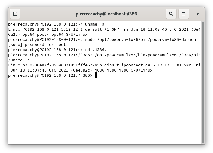

10) To run it, you need to manually
Code:
 sudo /opt/bin/powervm-lx86-daemon
then
Code:
cd /i386
/opt/bin/powervm-lx86 <x86_elf_binary>
(so far only stuff in the /i386 directory can be run by PowerVM-LX86, this might be possible to overcome as the installer does offer the possibility to run stuff from the /home directories. So it might be down to an environment variable that does not get set as the installation does not complete; I need to look in the install script to find out if it's that and what it is.
Also ideally, x86 binaries would normally be run with the runx86 script, but the installation halts before it can generate it. There is however a template in the installer folder, I will try to use it to make a working version of runx86.

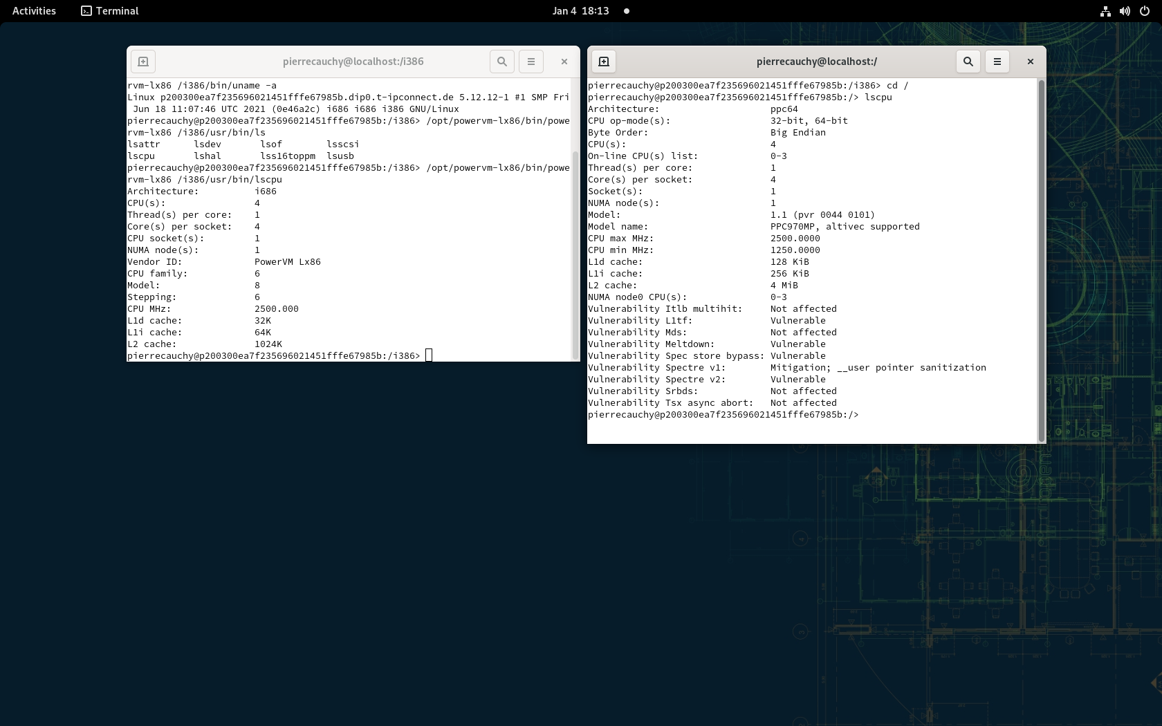

Work in progress but it does indeed confirm that PowerVM-LX86 not only runs on POWER5/5/6/7 but also on PowerPC 970s! As you can see the x86 version of uname -a correctly shows "i686 i686 i386 GNU/Linux" and the x86 version of lscpu correctly recognises 4 i686 cpus

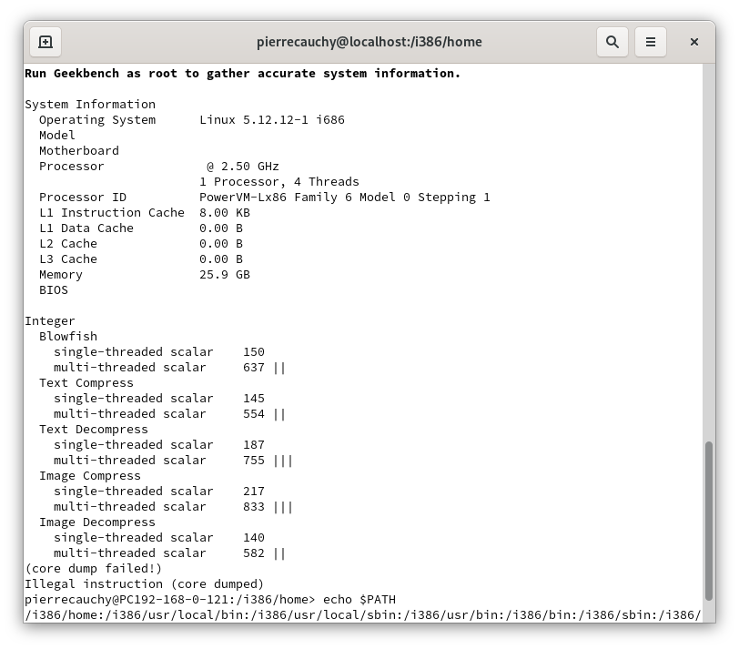

Update on PowerVM-LX86 on the G5 under OpenSUSE Tumbleweed: I tried to get some benchmarks with either sysbench (sysbench-0.4.8-75.38.i586) or Geekbench 2.4.3 (x86).
  • Sysbench does start with PowerVM-LX86 but crashes whenever a benchmark is started (illegal instruction then core dump). I will try with different versions as this one is from OpenSUSE 11.1 which would be almost a couple of years older than SLES11 SP1. I will try with different versions (sysbench-0.3.2-38.i586, sysbench-0.4.8-61.1.i586, sysbench-0.4.10-3.fc11.i586 etc).
  • GeekBench 2.4.3 (x86) does start PowerVM-LX86 and goes through everything fine until Lua, during which it segfaults. I will see if I need some deps that are not present there (notably i586 lua libs). I will try another version, ideally one that still has a PowerMac equivalent for comparison (e.g. 2.2.7)
Or if anyone knows some simpler benchmarks e.g. to just get Bogomips (the i586 SLES 11 version of lscpu does not show them with PowerVM-LX86, so it is likely that neither /proc/cpuinfo or hwinfo can be used to obtain them either).
I had originally thought of hardinfo but that would very likely be a stretch as it does require a lot of X11 stuff which simply isn't there yet, and it was already a pain to install on ppc64 Tumbleweed (not available and could neither be compiled with rpmbuild or a standard make as ppc64 was excluded in the spec and Makefile so I had to convert hardinfo_0.5.1+git20180227-2.1+b1_ppc64.deb from ppc64 deb to rpm with alien along with the required deps which were not available for ppc64 Tumbleweed), but who knows what it would be with the added complexity layer of running it within PowerVM-LX86, that said the deps seem to be there for i586 so maybe something like. hardinfo-0.5.1-2.1.9.i586.rpm (OpenSUSE 13.2), or something older e.g. hardinfo-0.4.2-1.el5.rf.i386.rpm (RHEL5) or hardinfo-0.3.6-0.dag.rhel3.i386.rpm (RHEL3) might work headless in command line mode under PowerVM-LX86 with the right deps.
Btw the modern ppc64 versions, sysbench_1.0.20+ds-2_ppc64.deb and sysbench-1.0.20-benchmark.75.41.ppc64.rpm for both debian and OpenSUSE, respectively, were not straightforward and pretty tough to install, respectively, I had to get libluajit-5.1-common (2.1.0~beta3+git20210112+dfsg-2) manually from Debian Snapshot, then could install it on Debian; for OpenSUSE the deps are not availale for ppc64 so I had to convert them to rpm and copy libs from /lib/powerpc64-gnu-linux to /lib64 and only then was I able to install it. Then they both run fine under ppc64 Debian and OpenSUSE Tumbleweed. If I do get an earlier version of i586 sysbench to work with PowerVM-LX86, I would then install the ppc64 version on OpenSUSE for comparison
So this is the output of Geekbench 2.2.7 before it crashes with PowerVM-LX86, doesn't look too stellar...
