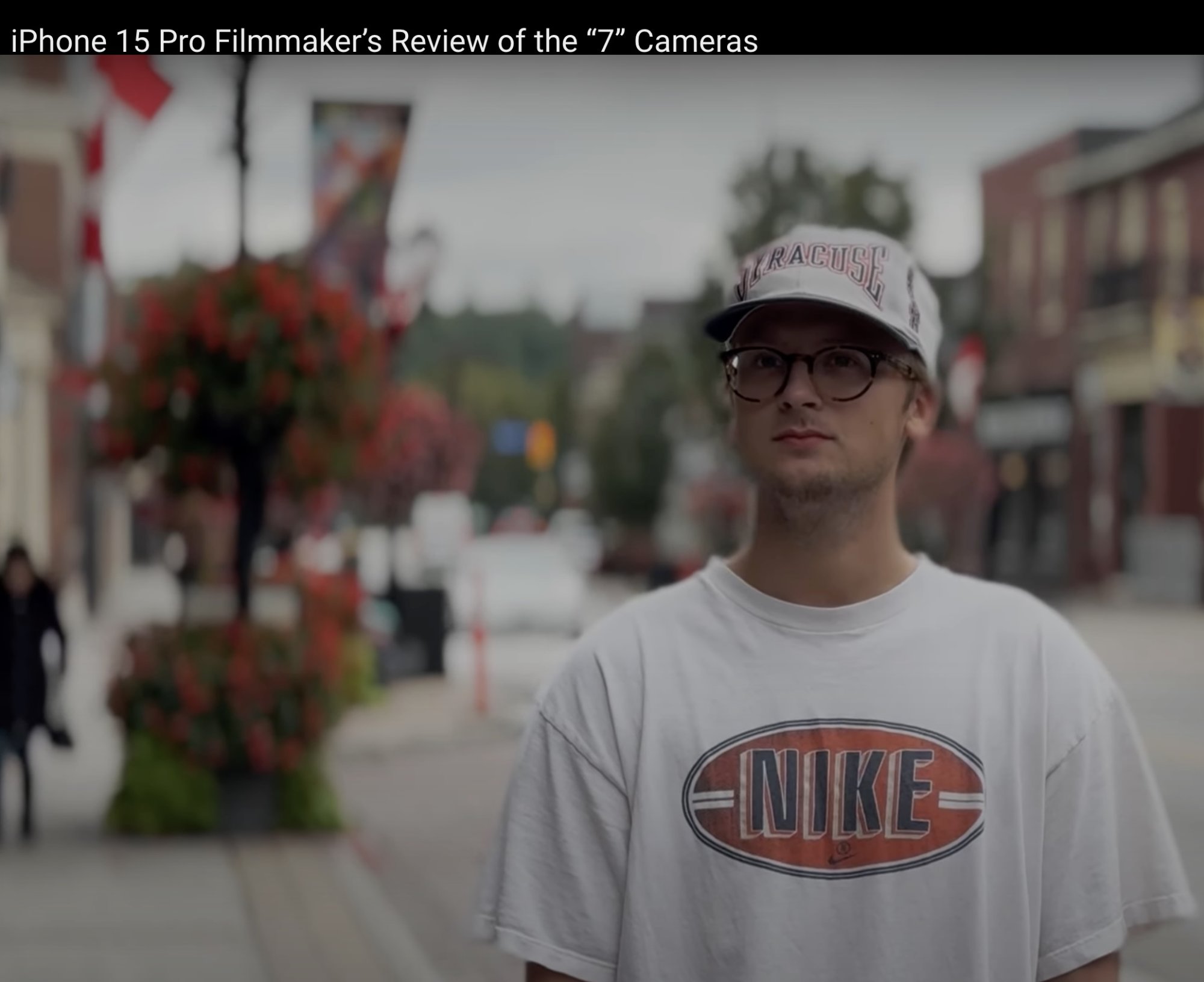

Thanks enjoyed the video. But one thing left we wondering is why all the bloggers that posted today, think the below is great quality cinematic mode? More i hear this comments, the more i think that they get paid for saying these words.

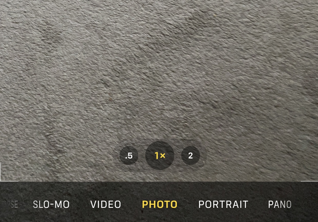

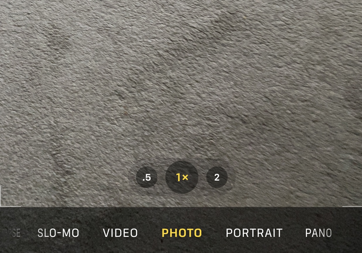

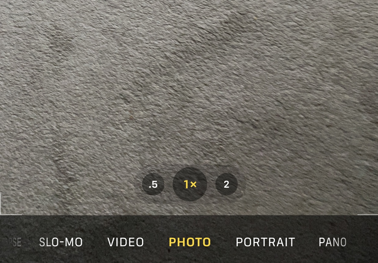

But I'm not sure that that's how the lenses have been described before: my 11 pro max camera has 3 focal length settings 0.5, 1 and 2 (see picture) which seems a more honest description of the optics.
But yes, I am splitting hairs. Fundamentally they are still great cameras, so much so that I ditched my SLR which I never ended up carrying about.

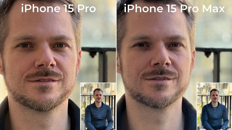

This is the first review I've found with a comparison of native 3x Pro vs digital 3x of Pro Max: Pro vs Max
The Pro is much better for 3x.
Wouldn't that be expected? A 77mm lens behaving better than a 24/28/35mm lens digitally zooming out to 77mm?
The 15 Pro Max doesn't even have a 3x in the native camera app for this reason...it has a 5x to match the 120mm lens.
A "5x" comparison between the 15 Pro and 15 Pro Max better show the latter being a lot better for the same reason (being at the lens native focal length vs the 15 Pro digitally getting there). And likewise, I don't think the 15 Pro has a 5x in the default camera app.

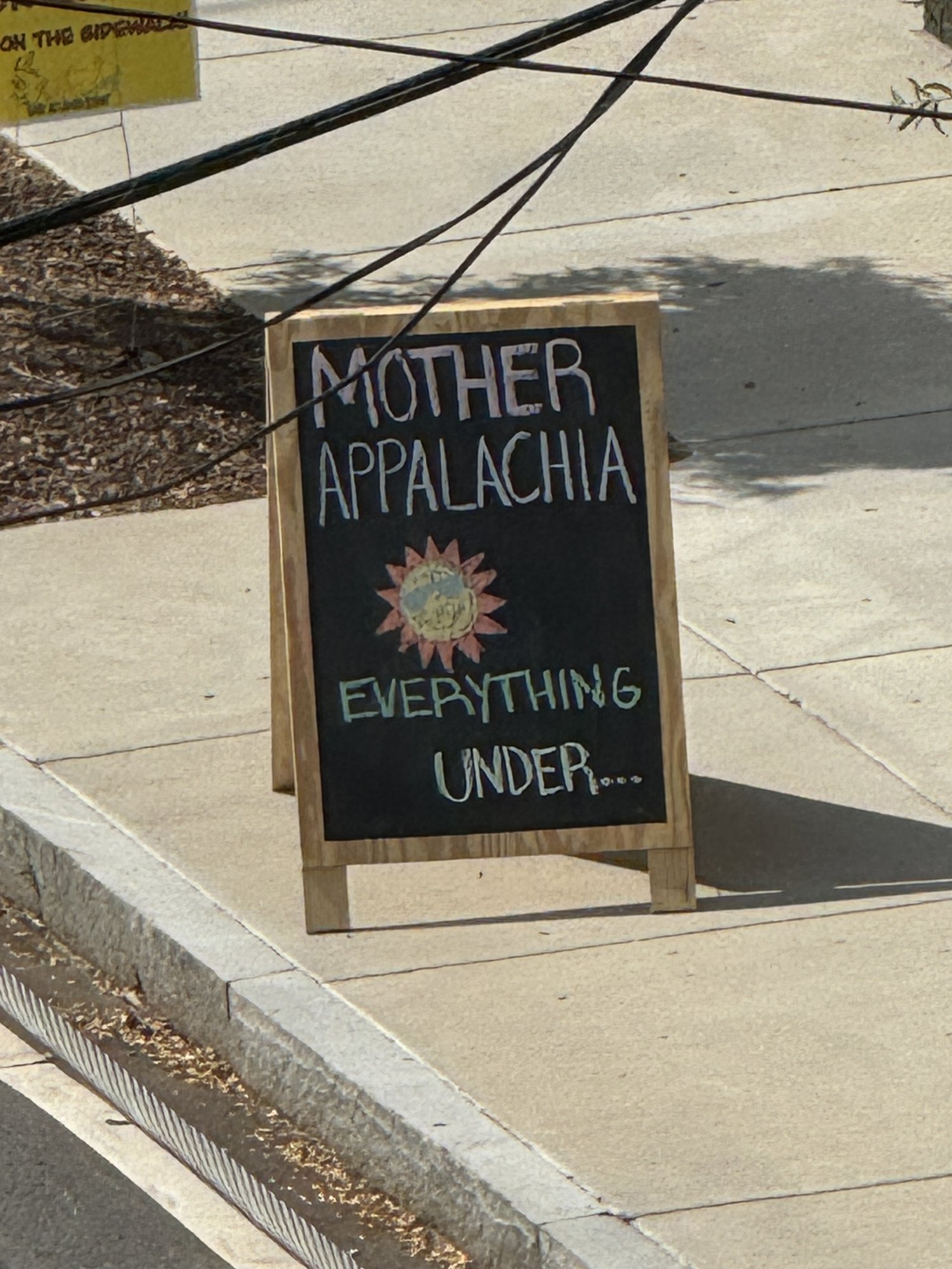

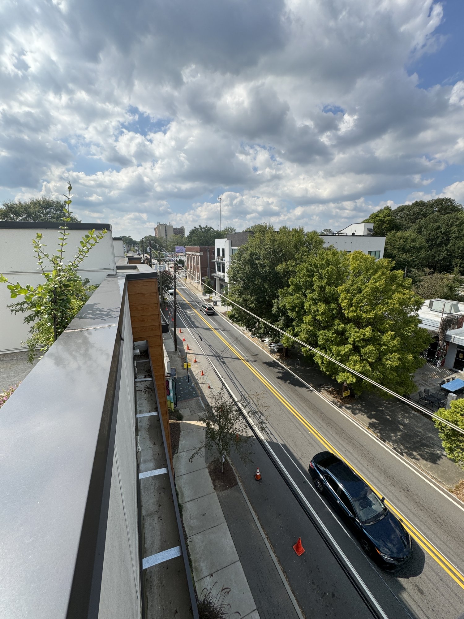

I just took these two photos from my roof top. I think they speak for themselves🤯. First is .5 wide zoom, the other is 25x digital zoom on the sign from the first pic.
Reactions: Lsmachado
Did you use a tripod on that 25x digital zoom? I'm guessing not but that seems really sharp for that much zoom if handheld, even with it being well lit.
