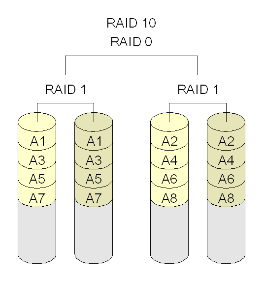

Maybe a picture might help the slow people at the back of the class:
There are four physical discs.
wiki states that you can RAID10 with a min of two drives 😕
Huh? I think your missing something there.... like what's the point of striping a pair of drives, only to backup/mirror the contents to the same set of drives as the stripe???? The mirror is supposed to be a secure backup!!! True RAID10 is constructed from a RAID0 + RAID1 set.
All due respect to DoFoT9 I think he's confused himself and the rest of us to boot. He's somehow thought I was suggesting Raid10 with only two disks. I never said that. He introduced that in his early response. And attempts to explain that misconception have thus failed.
Anyway, based on the diagram above. If I were to partition 25% of each physical drive to allocate to the Raid 1+0 elements shown. What is to stop me using the remainder of the disks (as shown in gray) in a single Raid zero set?
If is a technical limitation of disk utility? Again I'm ready to believe it is not possible, although I would wish it were, but I can't find anything categorically stating it is not doable from Apple.
@Nanofrog, thanks for all the input btw. I'd appreciate if you could comment further to clarify the mixing of raid types though. Cheers.

Technically, I think it should be possible. 🙂 With a true hardware controller, it depends, as some may not allow it, but currently isn't an issue for you.
However, that said, it's not a good practice. The reason is mainly due to simultaneous access, as it will slow you down. That is, if you're doing some thing that wants access to both arrays at the same time, as they share the same drives. It also increases the overhead on the system resources, if that's going to be an issue (depends on CPU load).
If you were thinking of 10 for OS/apps/data and 0 for scratch, you don't need to do that anymore. Scratch was created during the days when physical memory was atrocious in cost. That's no longer the case, and you can place everything on a single array, and bump up the RAM.
If you still want to have a separate scratch array, you'd need to get a pair of drives and use them in the empty optical bay. You'd have to either add a SATA card or pull the optical drive and go external to regain the use of that port to make a pair. This is something to consider, even if you have to get the SATA card, as the '09 no longer possesses the IDE ports on the earlier models.

Now how the hell could you do that? Stripe and mirror on the same 2 drives... isn't that even slower than just mirroring them? You're splitting the data in half and then copying the other half back over... what the heck is the point of that?
redundancy? 😉 😀
haha ouch. that explains it nicely but.
haha yes RAID1+0 i know that, im just confused by what i read.
sorry for confusing everybody, i will shutup now.
if your going to believe for one thing, at least believe me on this! it is possible.
sorry again 🙁
