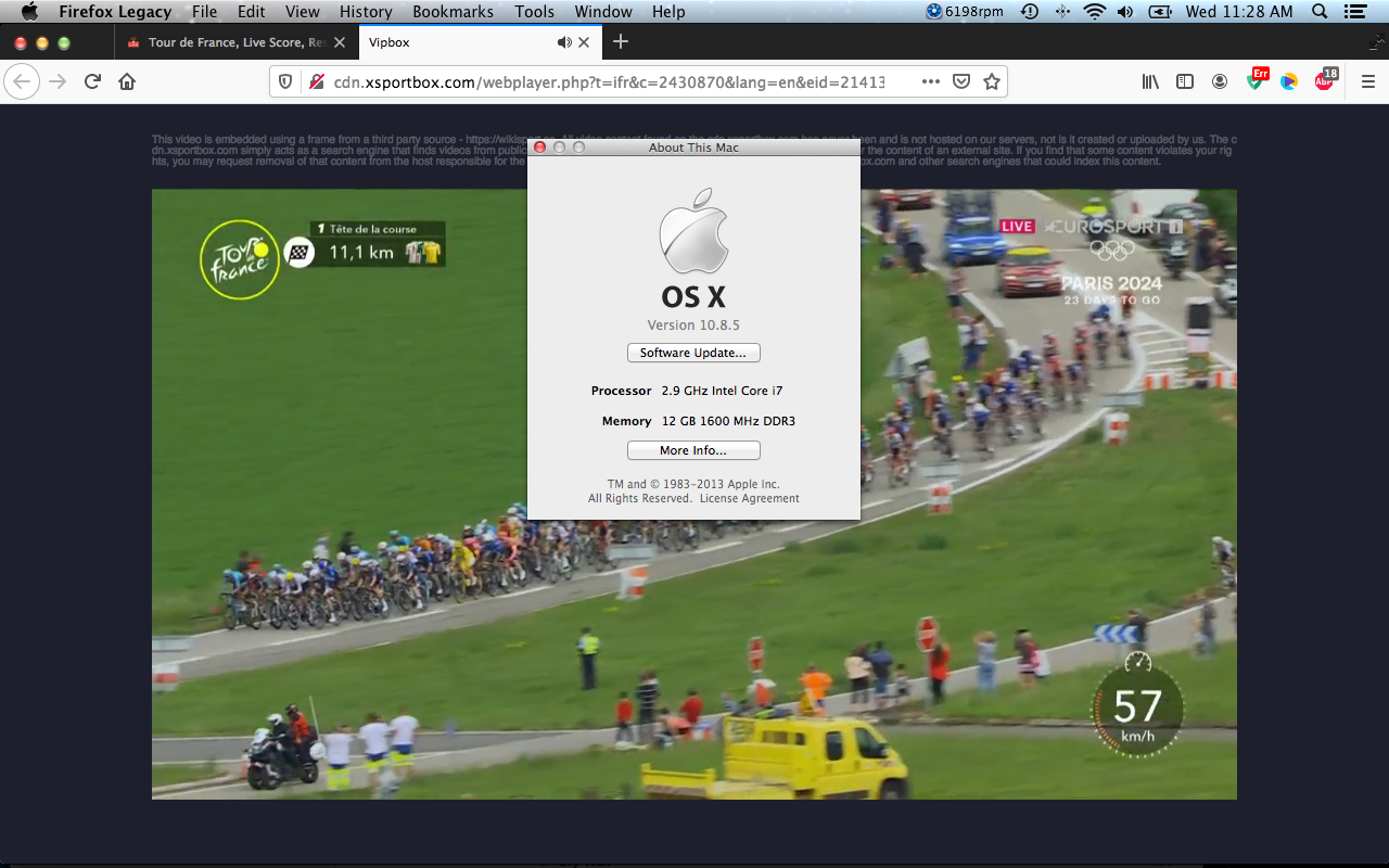

My device has an i7. The overheating cou be due to the old fans and thermal system.
My Macbook pro i7 is from 2012 and does not get hot with Mountain Lion but uncomfortable with Catalina,
so scientifically.... the thermal paste SHOULD be fine,
BUT
since this is a 2012 does thermal paste fade?
the process seems straight-forward and i did that in 2015 several times on other's Macbooks
Although i'm reluctant to fix something that is not broken, and will never use Catalina again.
while others who make online vids always re-paste any old macbooks they buy and fix.
hmmmmm.....
BUT
It absolutely does. Paste from that far back is basically just crumbly substrate of its former self, with ductility at a fraction of what it was, as well as its heat-transferring efficiency.
