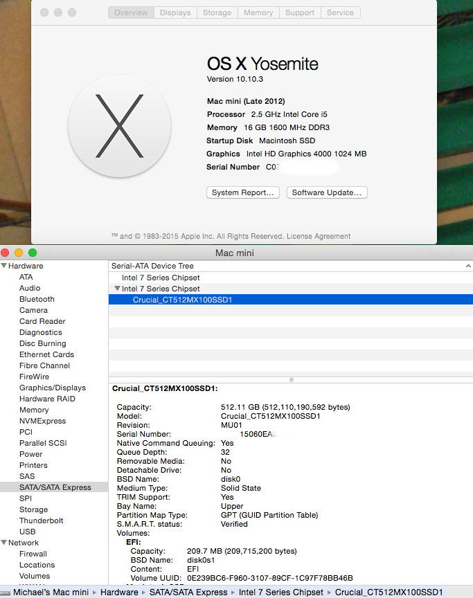

Success - Mac mini late 2012, Yosemite 10.10.3, Crucial MX100 512GB SSD, with TRIM Support = Yes.
Wow...went to your website and followed your instructions (took a risk) and used the "Even Better Method (No kext-dev-mode required!)" method and installed the tool in the systems folder and "BAM" it works!!!
Trim is stating that it is enabled.
I uninstalled Trim Enabler through the program and hopefully it reset the Kernel. I did that before using your method. It seems to be working....!
I wonder "if" Apple takes this method out of future Yosemite updates or even out of El Capitan, if I keep this and do the same thing when El Cap comes out (if it is not added), will this also still work?
I have the same configuration: Mac mini with the Crucial MX100 512GB SSD. This is why I tried... :)
Thanks!!!!!
