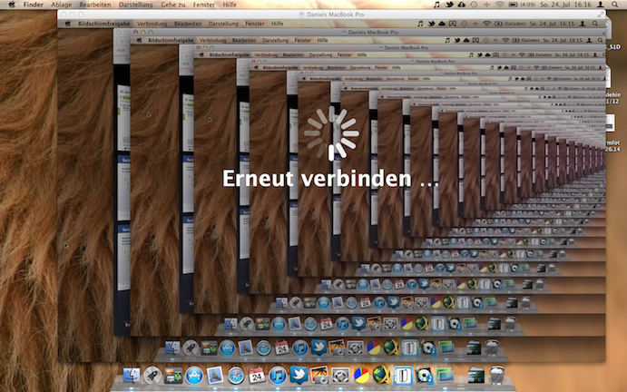

Uh, just got stuck in some kind of screen sharing loop here. 😱 I connected to my own machine via vnc just for fun...made it unusable...I recommend you not to do this! 😀
