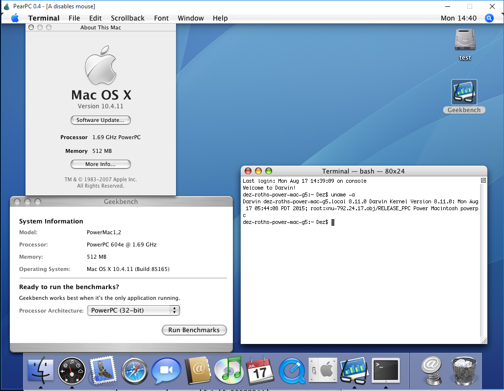

its well known by now that most PCI OWR Macs can Run OS X with the help of xpostfacto but with out a CPU upgrade to a G3 or higher it was said the highest OS you could run on its stock 604 or 603 CPU was OS X 10.2.8 well I was researching this and I came across this http://www.jump-ing.com/?en/Projects/Tiger_on_7600 and I was surprised you could run OS X 10.4 on a 604/603 and I wanted to test this well I dont own a Mac with a 604/603 CPU But what I can do is emulate one with pearpc (QEMUs 60x emulation seems to be broken) So I set up 10.4 with the 604/603 kernel and after some issues with permissions I got it to boot... and this was very cool But the problem still stood that the highest kernel he provides on that webpage is for 10.4.3 and I was thinking what about 10.4.11? so I went around figuring out how to compile and patch the kernel and well after ALOT of failures and problems (in the end I got it to compile on my Dual 2Ghz G5) I got the 10.4.11 Kernel to compile! and it worked on my 604 emulated mac! while I don't own a 604/603 Mac I know many of you here do so I will attach the Kernel I made (very pleased with this first time iv compiled a OS X kernel too) here for you guys to try out... (I wont go into details on how to get it installed in this post) (I also attached some photos on of the stock kernel running on a G3 and a uname -a output you can see the date is 2007 and ill put a pic of my kernel running with its 2015 build date on a 604e)
Screen Shot 2015-08-17 at 14.24.43.png Screen Shot 2015-08-17 at 14.40.52.png

I am looking forward to it heh... (I recommend setting up a tiger install on a HDD on a supported machine first to get everything installed (Like xpostfacto and my kernel) then move it to the Beige machine and booting from it

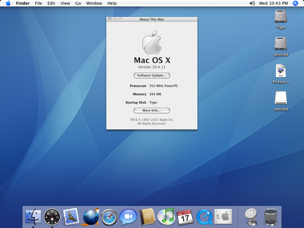

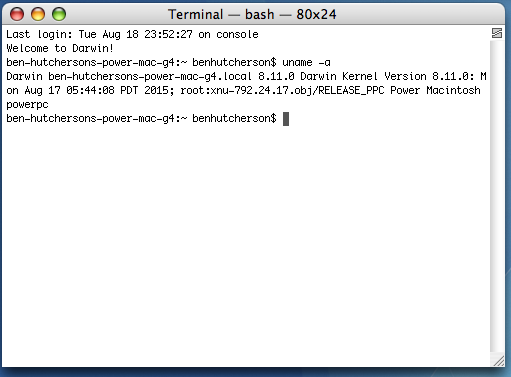

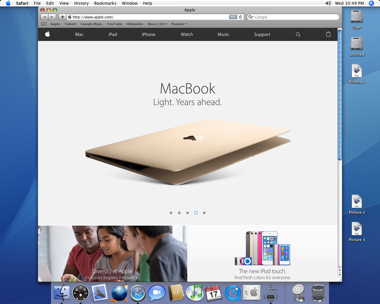

We have successful kernel insertion-now I just need to transplant the drive into a 604e Mac. I may try tomorrow evening-I'll probably either put the 604 back in my 8600 or try my 7350.
Reactions: LightBulbFun

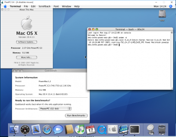

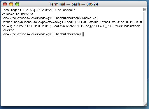

8. Rebooted in the MDD to confirm that the Tiger install was still good and that the modified kernel had installed(see screencap above).

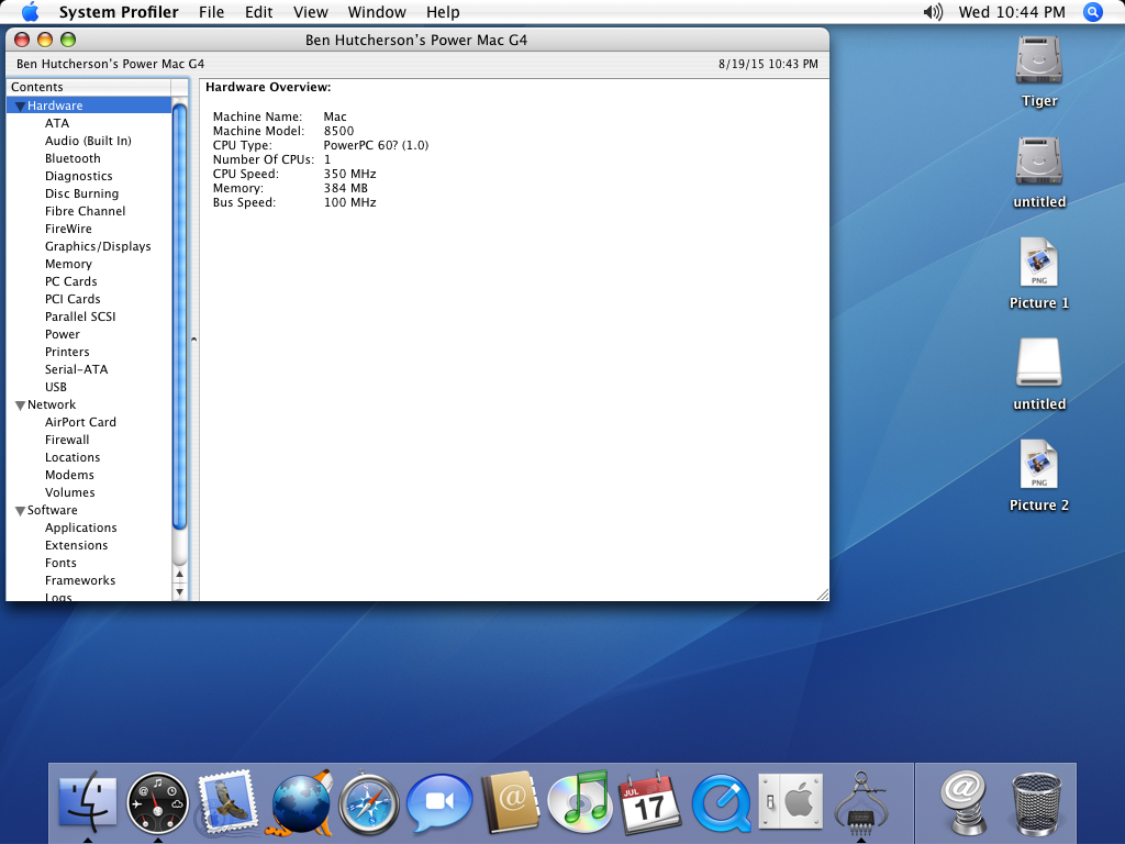

Here's another interesting point-although this probably won't be a surprise to Intell.

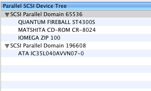

The Acard ATA card I'm using actually registers in System Profiler as a Parallel SCSI card. The HDD connected to it shows up in the SCSI tree under System Profiler.

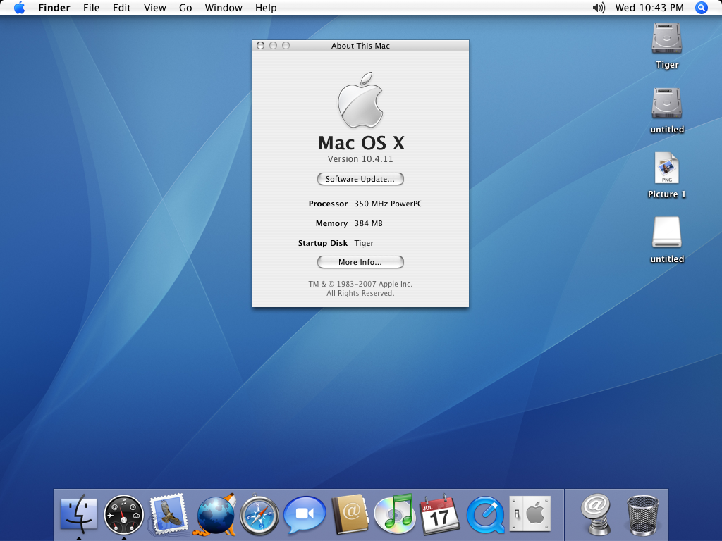

so Tiger (with my patched kernel) will run on a beige PCI mac with its stock 604 CPU man thats bloody awesome :D Im wondering now would it work on a 601 CPU? its said OS X cant run at all on a 601 (according to xpostfacto). to run OS X on a beige machine it needs to have open firmware so the PowerBook 5300 is out of the game for example. the 2 machines I know of with a 601 CPU and open firmware is the 7200 and the 7500. regarding it showing up as 350Mhz I see it reports your bus speed as 100Mhz so that might have something to do with it (also did geek bench run? geekbench 2.2.0 is the last one for tiger)

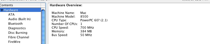

sregarding it showing up as 350Mhz I see it reports your bus speed as 100Mhz so that might have something to do with it (also did geek bench run? geekbench 2.2.0 is the last one for tiger)
Interesting! Are you saying that the reported CPU/bus speed is incorrect? Are the 60x processors basically the same as G3 processors?
indeed it looks like its not reporting it correctly... its odd since I have seen other beige PCI macs running OS X (with G3/4 upgrades) that report the bus speed correctly along with the CPU speed. (bus speed on the 8600 is 40-50Mhz IRC) the 750 G3 CPU was derived from the 603 CPU (skipping the 604) one of the Major features of the G3 was its fast backside L2 cache... a G3 750 with out that is about as fast as a 603 or so of equivalent speed

Bunn, how bad is it? Does general useage just make it die?

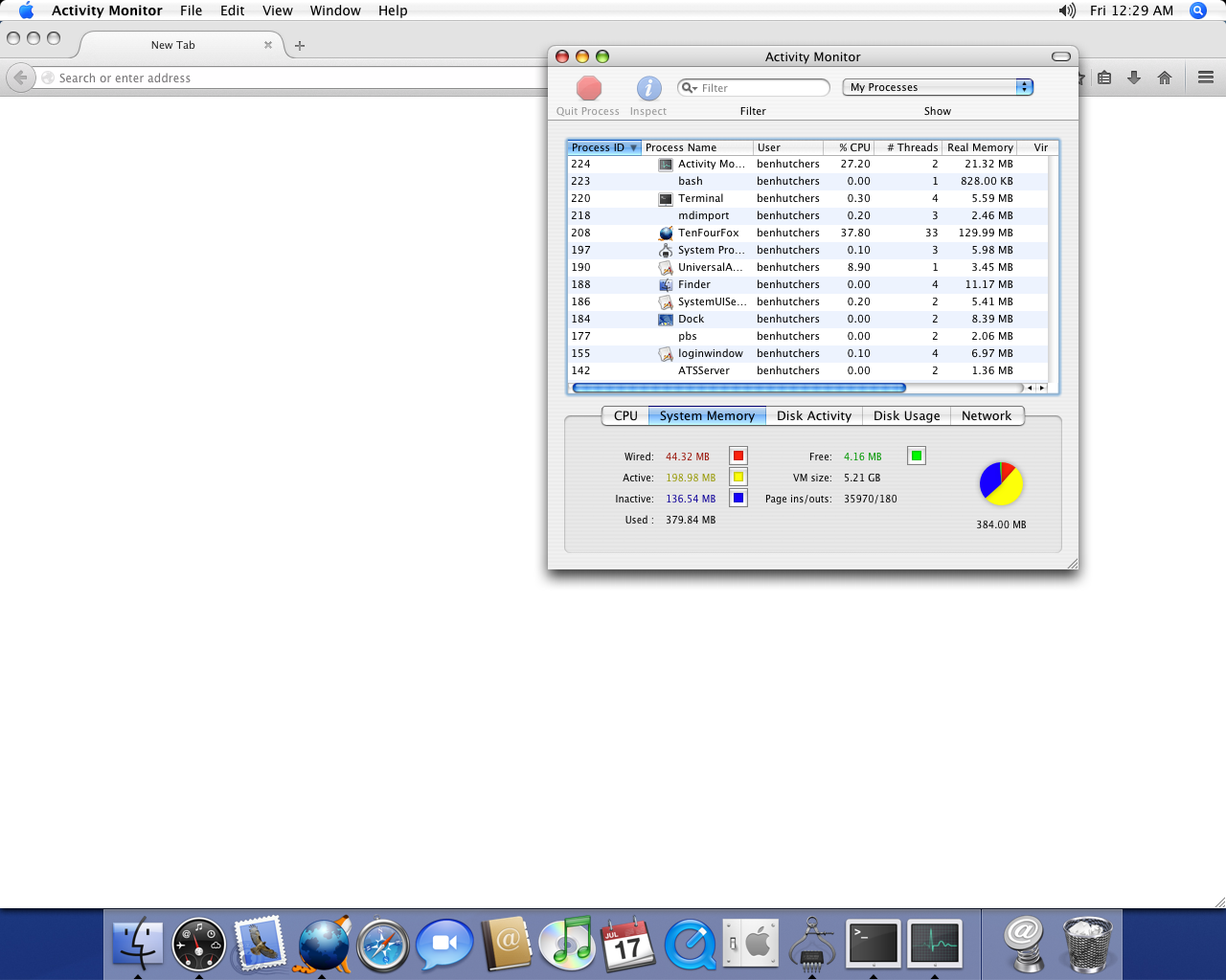

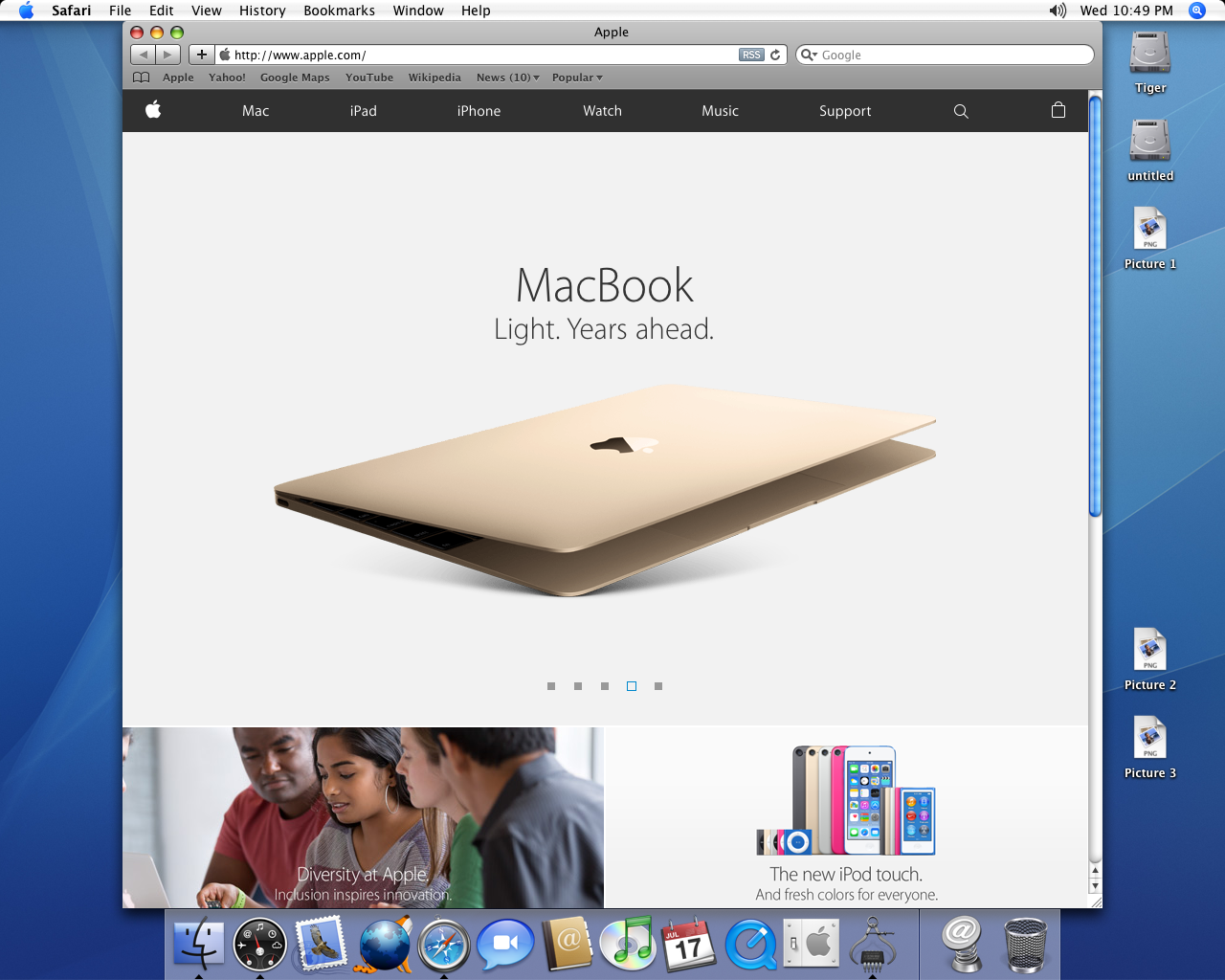

About all I did was browse the web for a few minutes. It actually handled that well, but it was slow. It had issues with rendering this forum correctly, but then I was using a very outdated version of Safari(I never use Safari in Tiger otherwise, so am not sure how it compares). Page loads were slow, but again I'm not sure if I can attribute that to the 10baseT ethernet or the sluggishness of the system. When I finally get around to installing Leopard, I'm going to have to make a tough decision about whether I want USB/FW or 10/100 ethernet, as I only have one expansion slot left to play with. I'm inclined to think internet sharing with another computer over FW would be the way to go.
The only "off the shelf" way I know to get a modern browser would be to run Classilla in classic mode, although I'm not sure how well the computer would handle the resource hit of that.
The GUI was also a bit sluggish. Apparently there is a way to enable QE on the PCI 9200 I was using, which I think would perk things up a lot.

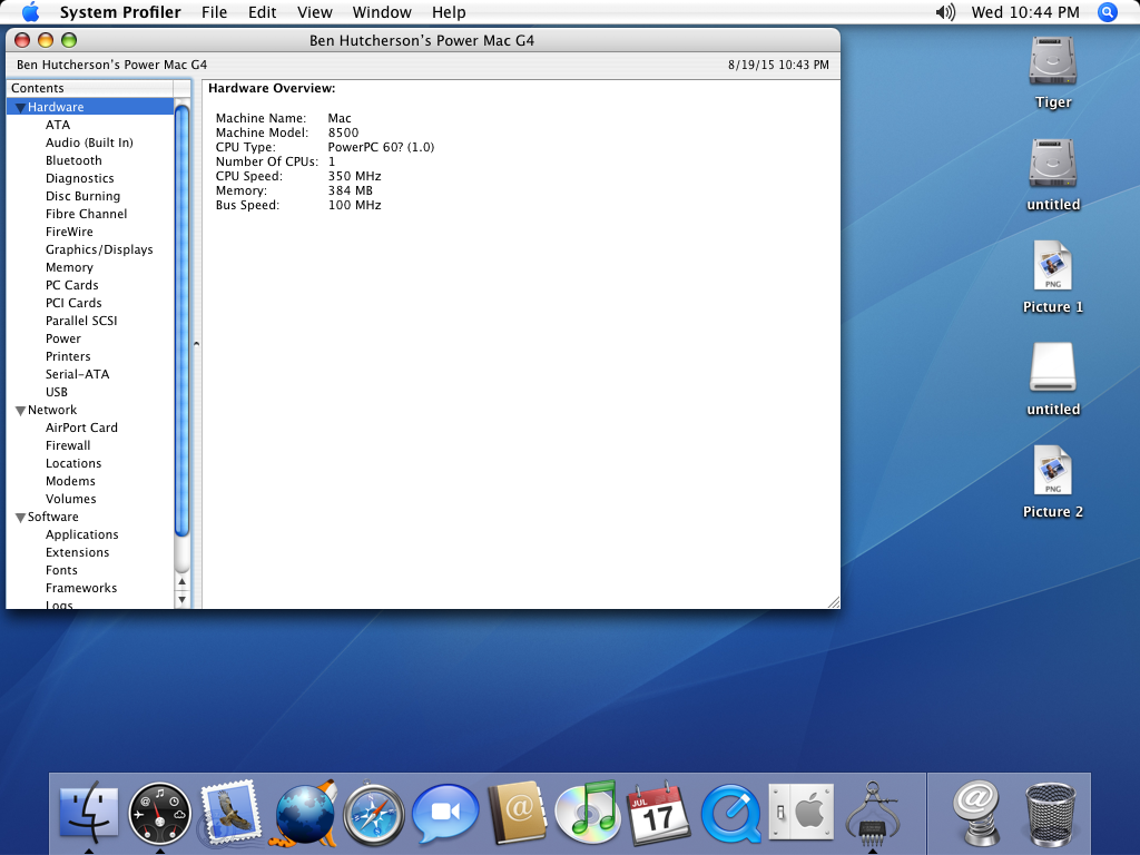

I put the G4 back in the 8600. To be fair, this is my first experience with running OS X on this particular computer/processor combo, but I actually found it less stable than running with the 604e. In particular, TFF, Activity Monitor, and Safari all crashed on me before the system KPed. I may try replacing the original kernel and try again, but before I do that I want to run this Tiger install on the 9600.
For the time being, here are some more screen shots. System Profiler more or less reported the G4 correctly, although it still called it a 60?(a common thing I see with aftermarket CPUs) and I don't think it saw the L3 that the processor has(and is seen in OS 9). It did correctly report the 50mhz FSB.
I'm also attaching a screen cap of the SCSI device tree to show the ATA card.
I also think that Activity Monitor is definitely telling me I need more RAM, although I've been hesitant to drop $100 at OWC for 1gb of RAM.
