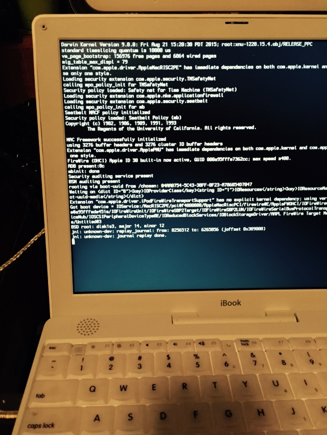

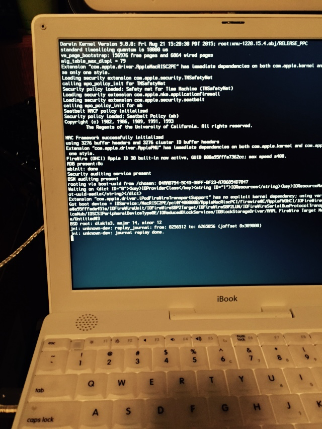

Picture incoming (and yeah I know about the platform driver thing its why i was looking for a G3 with the MacRISC2PE since leopard has built in drivers for it since its used on some G4s) this is where it hangs (in my emulated G3 beige when i set the CPU to a G3 it also hangs here more on the emulated G3 beige in my other post about leopard in qemu) (this is bens machine)
I think the problem is with the "waiting on" lines. It seems the Leopard doesn't like how the root device is setup. Have you tried pressing Option at boot and then selecting the Leopard drive/partition?
the thing is tho I have had that problem on other things before and it says still waiting for root device after a while... (also on the iBook it says got boot device) so I doubt its a HDD problem (plus like I said on my emulated G3 beige where i got leopard booting on it with a G4 CPU when i set the CPU to a G3 it hangs in the same place) BTW the iBook is booting from another G4 mac in TDM over Firewire
