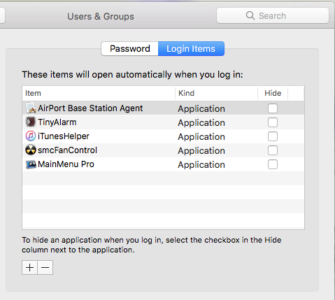

May I ask, what exactly do you mean by Legacy Apps as if I can know what they are & where, I would like to be able to get rid if any offending ones. I do have a log in items that load at start up - please see screen-shot to check if on my list might be offending ones & which I should get rid of.

Other stuff to consider getting rid of:
smcfancontrol
MainMenu
AirPort Base Station Agent

You should not need any fan control. If you do...Macs Fan Control is pretty good. Much better than SMC ever was.
But less is more. Especially when troubleshooting.
