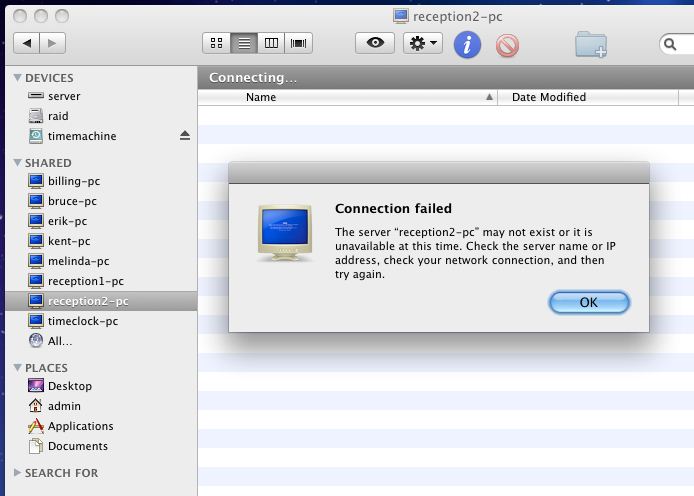

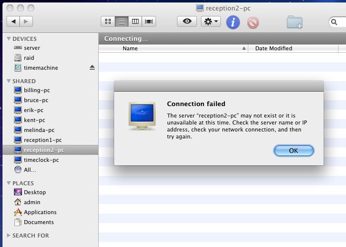

in the finder i see all fine, but when i click - connect-as, it fails:
and i get this message:
ideas ? the server is running SMB to share files.

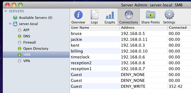

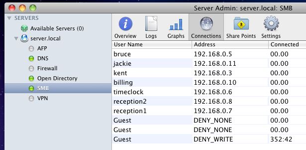

even in SMB i see the connected users with proper IP. the computers are named: "usernamename-pc" like kent-pc

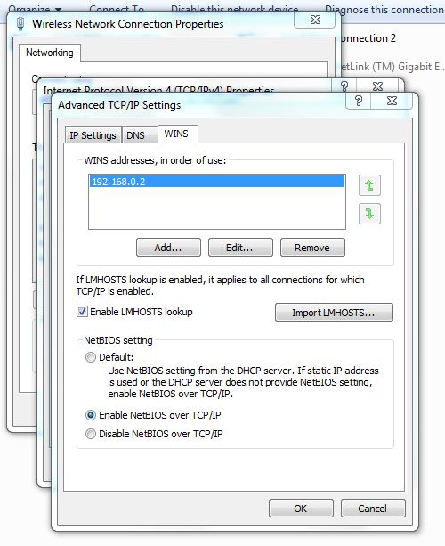

Also - is your Server name showing under NETWORK>[adapter] Properties>WINS>NetBIOS Name?
Any entries under: WINS Servers?
:apple:
One more thing:
Once you go "static" (disable DHCP) on Win7 PCs you might want to enable NetBIOS over TCP/IP under WINS properties (IPv4)
Check if LMHOSTS file is in use and see if there are some "strange" entries in there that could mess up the mapping.
:apple:

not sure what you mean about:
server has WINS enabled and i've entered the IP address manually into the IPv4 setting into each PC as WINS server.
One more thing:
:apple:
this is the LMHOST.sam in C:\Windows\System32\drivers\etc ?
i see no entries there. all is commented with #
