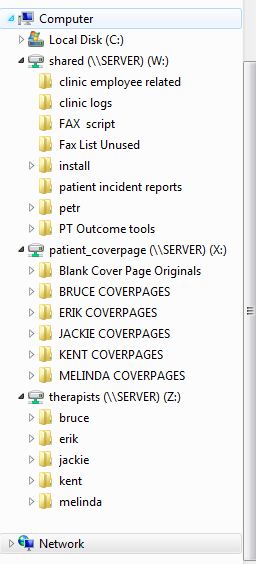

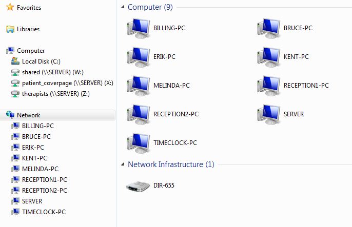

it seems with static IP's it's somewhat improved. but still weird behavior:
the Windows computers have 3 mapped drives from the server to access WORD 2007 files. In most cases the browsing is fast and swift as well as searching in them. Then on occasions. estimated 2 of 10 times the spinning wheel will appear and the windows file explorer would hang for about 10-20 sec or so. then the file will open fine.
what might be causing the delay ? what can i can check ? all PC's have fixed IP addresses. Are there services on W7 that i should check for, disable ? it seems in the morning it's better, then around noon it starts to happen more often. what's causing such delay ?

i've disabled few services including DHCP on the router and all the clients PC's the speed negotiation is on auto i believe. only the server and one PC uses ethernet - the rest wify-n
can you comment on the SMB updates ? Do i need both WMB and DMB enabled on the SMB server ? No domain login is used.
