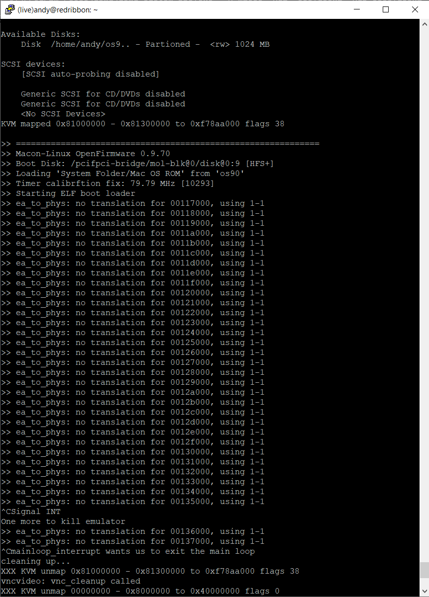

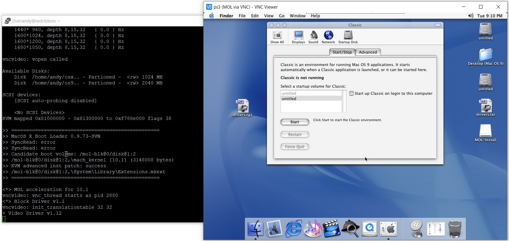

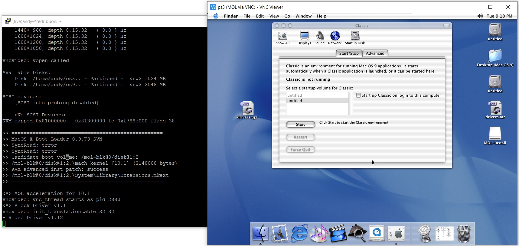

you could always go and try
PPC Mac-On-Linux after you install any current PPC linux and report back here how it went, perhaps if you alrady have a PS3 and a web connection you might ask if people like Lu-Zero
http://cia.navi.cx/stats/author/lu_zero might like to access your netted linux ps3 to help him make his valued work more accessable etc...... or buy him a ps3 LOL.

as regards getting a current PPC Linux installed and running, (im not sure if anyones tryed running MOL there yet?)
Lu-Zero said here
http://www.powerdeveloper.org/forums/posting.php?mode=quote&p=5583
"Posted: Fri Nov 17, 2006 7:34 am Post subject:
the quickest way to get it running is just fetch or produce a standard stage3 image, add a default kernel for ps3 (the latest cell-sources should do) and it should work. (if you have a powerpc or a ppc64 would be easy since you can chroot inside)
I'm not 100% sure since I don't have access to a system...
Currently I'm trying to update the toolchain snapshots to let people start using spus and ppu specific instruction scheduling since running generic or g5 tuned binaries could lead you to a delusion ^^ (it could be quite slow due misses, pipeline bubbles and other stuff you can avoid compiling for the cell target)
I'll try to prepare a quick recipe to let you play at the earliest, give me at least a day or two to be more sure.
ping me on irc in few ours (since I have to do something in this evening and I won't available now) or send me an email if you want to act as guinea pig (requirements: crossdev, time, patience) "
as you can see above (links)it is almost trivial
😉, unless your refering to the longer term goal of optimising for the specialist SPE's, then yes for now at least, but give it time and effort, as for now it runs or will run as soon as someone trys MOL and gives feedback to the devs if it didnt, fun factor fix 2 days+ estimated.
as a starting point anyone with a ps3 and wanting help with PPC based Mac-On-Linux should perhaps start asking here
http://www.powerdeveloper.org/forums/viewforum.php?f=27 as thats were many devs etc hang out....
