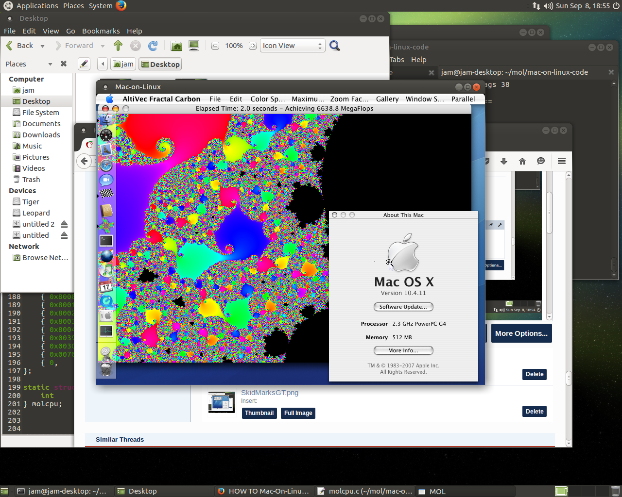

We are now ready to boot Tiger in Mac-On-Linux !
$ sudo startmol -X
On the initial run, MOL will spit out a timebase_frequency value.
Copy the "timebase_frequency:" output (such as "timebase_frequency: 0x01FCA554"), then add to the sessions.map as instructed;
$ sudo vi /etc/mol/sessions.map
Paste the line in near the top of the file.
Save/write and exit (':wq')
Once the guest system boots, the MOL drivers will appear on the desktop as a disk image, run the installer and reboot/shutdown then run again with;
$ sudo startmol -X
I found that using FTP to transfer files in and out of the system via guest and host works. Enable FTP Sharing in Mac OS X via System Preferences > Sharing and then access from the host side;
$ sftp 192.168.41.2
You can then get and put files to transfer. Of course you could always use scp .
It may be possible to mount your host's SMB shares in the guest, but I couldn't get this to work - it just hangs when trying to connect to smb://192.168.41.1 from within the guest.
While the old version of Safari works, I couldn't get TenFourFox to start up. Realising that TFF builds are CPU specific, I tried downloading the G3 edition and bumped the system memory up to 1GB, but still no luck.
In further research I found there is a TenFourKit version of Webkit for Tiger, but all the links seem to be dead. I'll keep hunting for this as it could make Safari more usable.
Good luck and post your screenshots!
