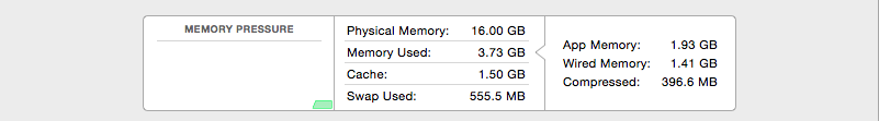

So I did the SMC Reset and its been a week. The Mac Mini is still using 12Gb for cached files, however it seems to be managing the ram better. There is no lag when I remote VNC into the machine. Also the SMC restore didn't make any noticeable difference in opening and saving files. I did reconfigure the raid, seems to have helped with writing files.
