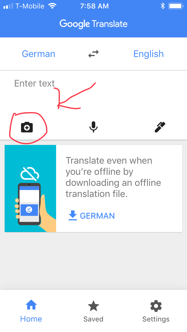

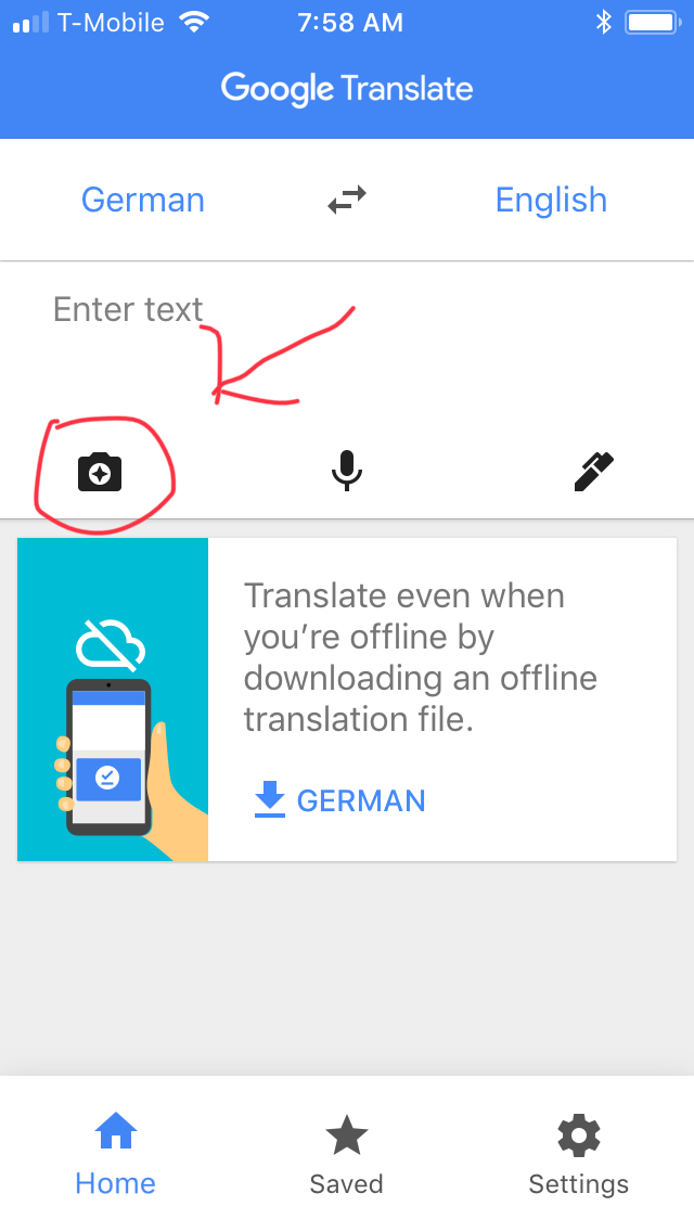

Just for future reference, if you have a smartphone, there's an app called Google Translate that can translate real time using the camera.
Just point it at the computer screen.
Had no idea the app would do that, I usually just plug the text in! Thanks for the heads up. I live in Germany and often have to translate French and Italian. This will come in handy!
