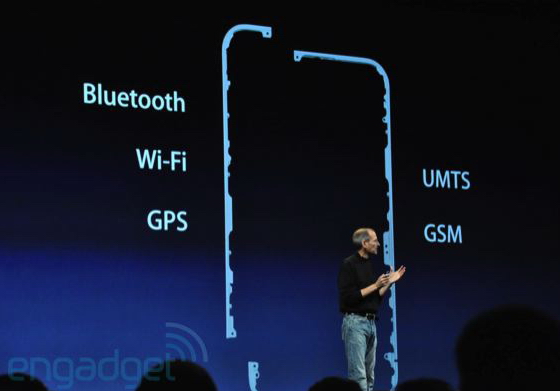

My question is if it's an issue of where you're holding the phone, why does a bumper fix it?
A bumper is also a dielectric spacer which can greatly reduce the capacitive loading (and thus loss) on the antenna with only a moderate (but non-zero) thickness.
Antennas work best the farther away they are from anything even slightly conductive (such as the battery, wiring, circuits, salt water in the blood stream in your hand, etc.).
The iPhone 4's design puts the antenna as far away as possible for a non-external antenna (no whip, stub or hump) from the internal circuitry. The bumper moves your hand away from the antenna about the usual amount for an internal cell phone antenna.

The amusing aspect of this entire discussion is the assumption that this is NOT software related, but a hardware design flaw. We even have Danish specialists weighing in. Yeah, so. We'll see how this goes with an update, but I think this is hilarious how people see the same thing and come away with different thoughts.
The way I see it is this... Yup. There's a hardware issue at the core of this. It's present in EVERY shipping cellular phone. It was especially pronounced in the iPhone 4 when held in a strikingly common way (personally, it took me a while to reproduce the same results, I was holding it wrong).
"Hardware issue", YES. "Hardware flaw", NO. Why not a "flaw"...? Because it was done intentionally, and should not pose an ongoing, irresolvable problem. What few people are saying, is whether such a condition, as occurs here, can be addressed via software. Personally, I think only Apple knows for certain, but others can make very educated guesses (yet few have).
