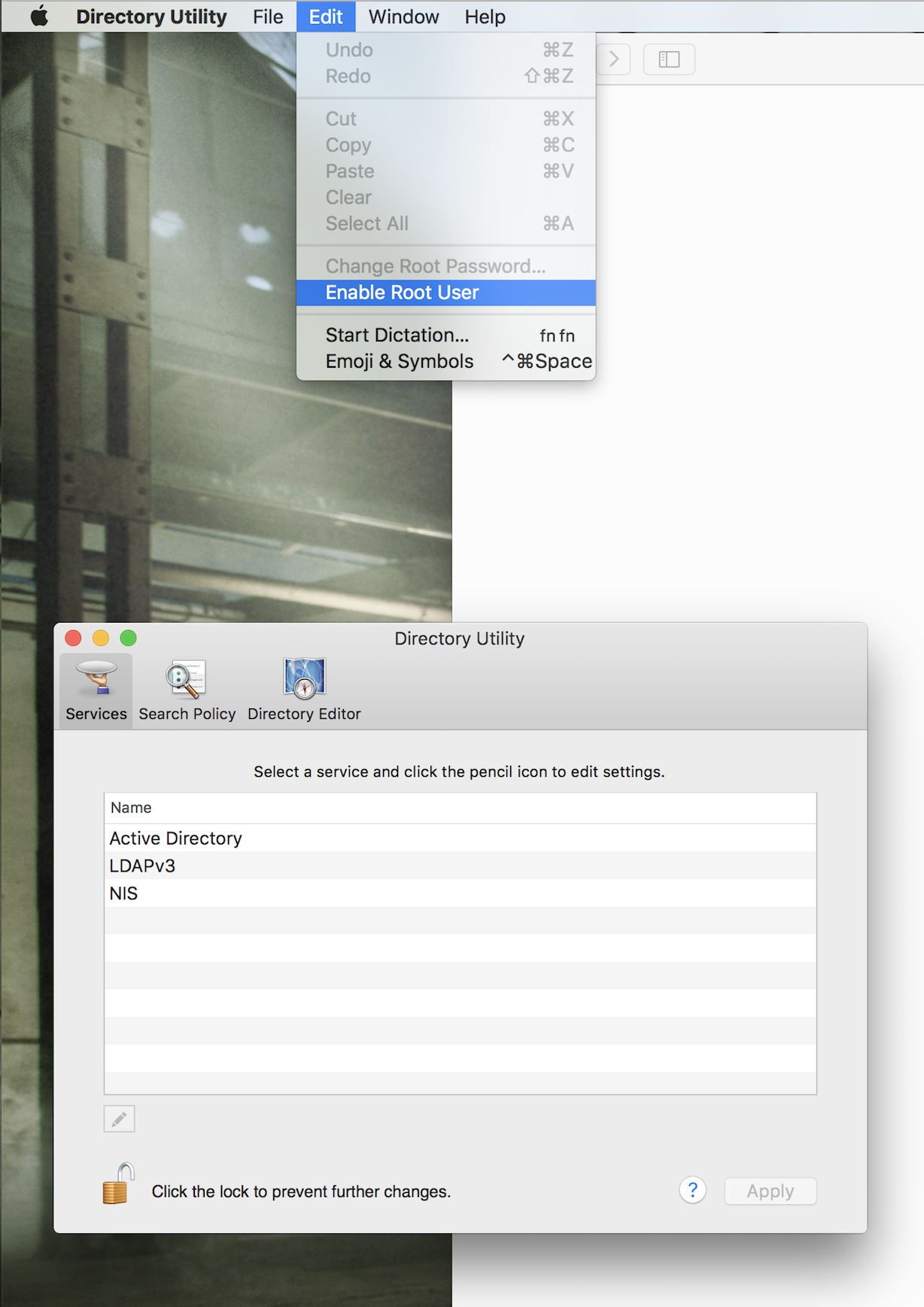

I think that Other login is caused by enabling the root user and might be unrelated to this adware issue.
In Spotlight start typing Directory Utility then launch it when it comes up. Then click the unlock at the bottom and enter your password, them look at this screen and where this screen says Enable Root User... does yours say Disable Root User??

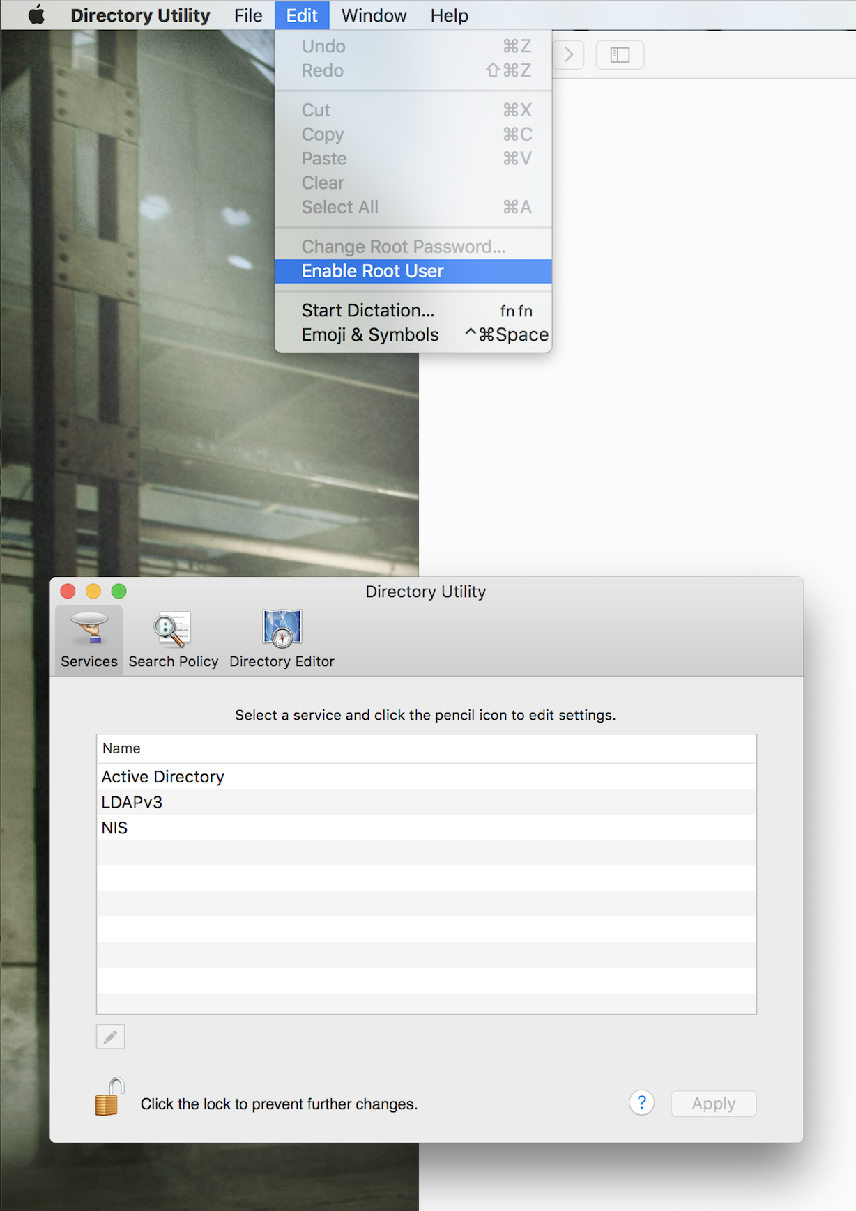

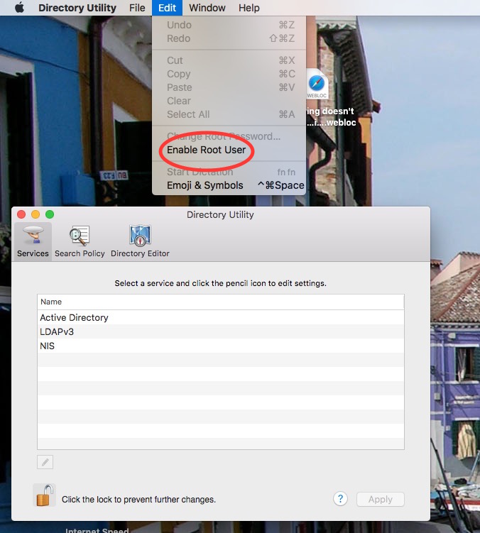

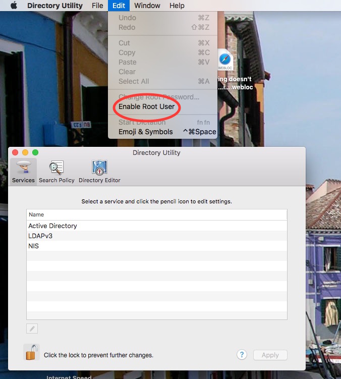

No 🙁
Hmm... just for grins... try to enable it then disable it after.
Just from searching around I see a lot of posts from people who had that Other login appear after they enabled the root user.
Enabled chose a password, disabled and done a restart. Still there
