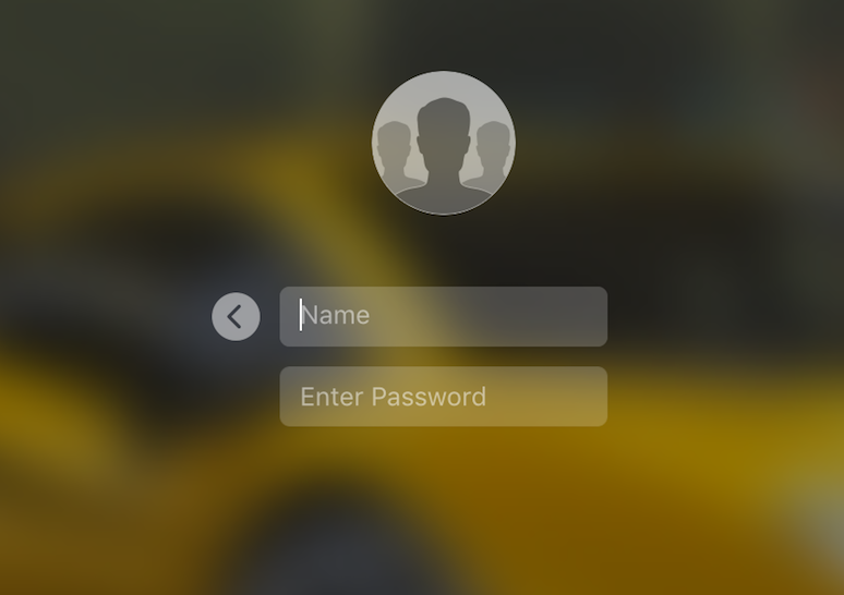

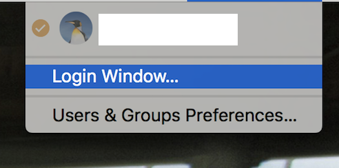

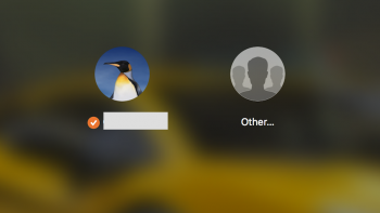

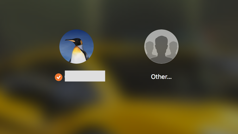

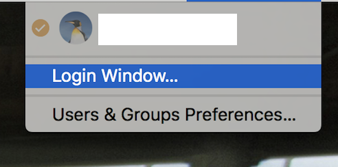

Hi all,
I logged in this morning and noticed there was a 'other' user on the home screen. Went to settings>user and couldn't see it there. I've created a random "test" account logged into it and then logged, then deleted to see if that would help.
I've tried to enable the 'guest' account but it won't allow me to for some reason. It doesn't show up anywhere on any settings only the log in page. it also has a username and password which i'm not sure what that is?
I haven't created an second account on this iMac only when testing to try and clear the 'other' account as shown.
Any ideas?

What is the output of this Terminal command?
Code:
dscl . -list /Users | grep -v $(whoami)

hyphomycete is one of your accounts? There are a couple of accounts that I don’t immediately recognise. The “Other” login prompt is usually shown only when there are hidden, enabled accounts.
You can see which ones are enabled with this command.
Code:
dscl . -list /Users AuthenticationAuthority
You should only see an entry for Guest and for your own account.

hyphomycete isn't one of mine. I only have 1 account which is my my own, and labelled as my name. This is the return i got from terminal
You should remove the hashes from your post. That hyphomycete account seems suspicious. I cannot find anything about it online with a superficial search. If it does not ring a bell, then maybe that is the reason for the problem.
This should provide some more information about it:
Code:
dscl . -read /Users/hyphomycete UniqueID RecordName PrimaryGroupID UserShell NFSHomeDirectory
Code:
If I'm honest i've done the above terminal and haven't a clue what any of it means....
It provides some records on that user account: its user ID, its primary group ID, its default shell and its home directory. It could give a hint about its purpose and whether you can remove it.
You can of course try disabling it to see whether it solves your problem:
Code:
sudo dscl . -create /Users/hyphomycete UserShell /usr/bin/false
@Weaselboy: I suspected as much. Does Malwarebytes recognise these random accounts?
I think you may have installed "pirrit" adware. See post #18 in this thread.
That adware makes a hidden account to run the adware from and uses a random name for the account. Use Malwarebytes to get rid of it.

@Weaselboy Yeah restarted and the 'other' account is still showing on the log in screen 🙁

Also restarted the iMac again and it's still showing on the log in page.
