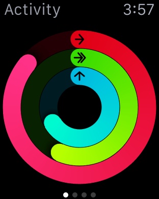

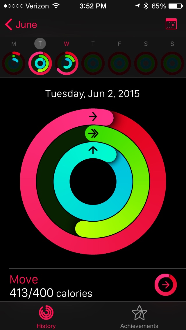

I recently got my watch and it was already on 1.0.1. However, my exercise ring seems to be doing alright. I haven't done any "dedicated" exercise since I've had the watch, just normal walking around school and these were my rings yesterday...
And today (note the time in the screenshot...still only 3:57. Just got home from school). I have 17 minutes of exercise just from school.
From what I can tell, if I'm actually doing something that would be considered exercise, I get credit for it. I can get 2 or 3 minutes of credit for walking quickly from class to class. But it has to be VERY quickly, which makes sense, as when I walk my normal pace (which I think is still fast) my heart rate at the destination is usually in the 90s to low 100s...not much calorie burn going on there. However when I get credit for exercise, my heart rate is always above 120 (that takes a very brisk walk). I think some people may not realize that they're not doing as much exercise as they think. I don't have 1.0.0 to compare it to, but from what I can see, it's not that inaccurate. I've yet to use any of the workout app. Been raining constantly. Plan on trying it out today.
