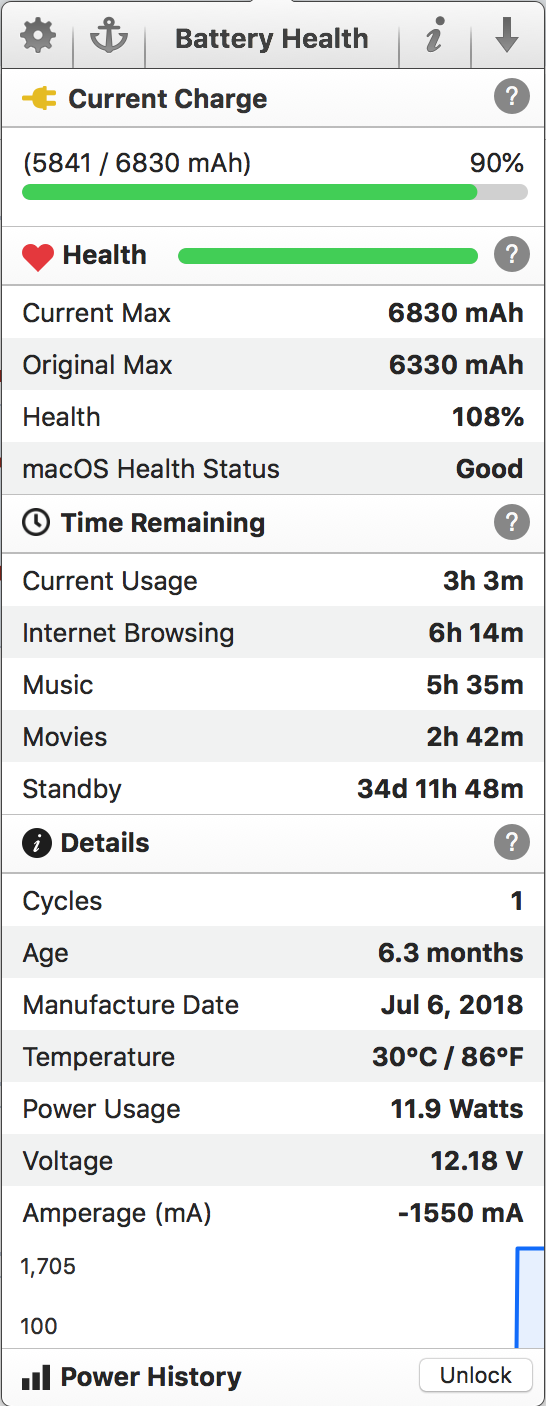

Received it this morning. This is way faster than I was told and expected (14 business days + shipping).
I dropped it at Apple store on Sunday; they shipped to repair center on Monday; repair center received it on Tuesday, finished the job and shipped it to me on the same day. I received it the next day (Wed) morning.
Applaud apple for not cheap out on shipping.
Now with 108% full capacity battery and brand new keyboard, I have to say $199 is very well spent.
