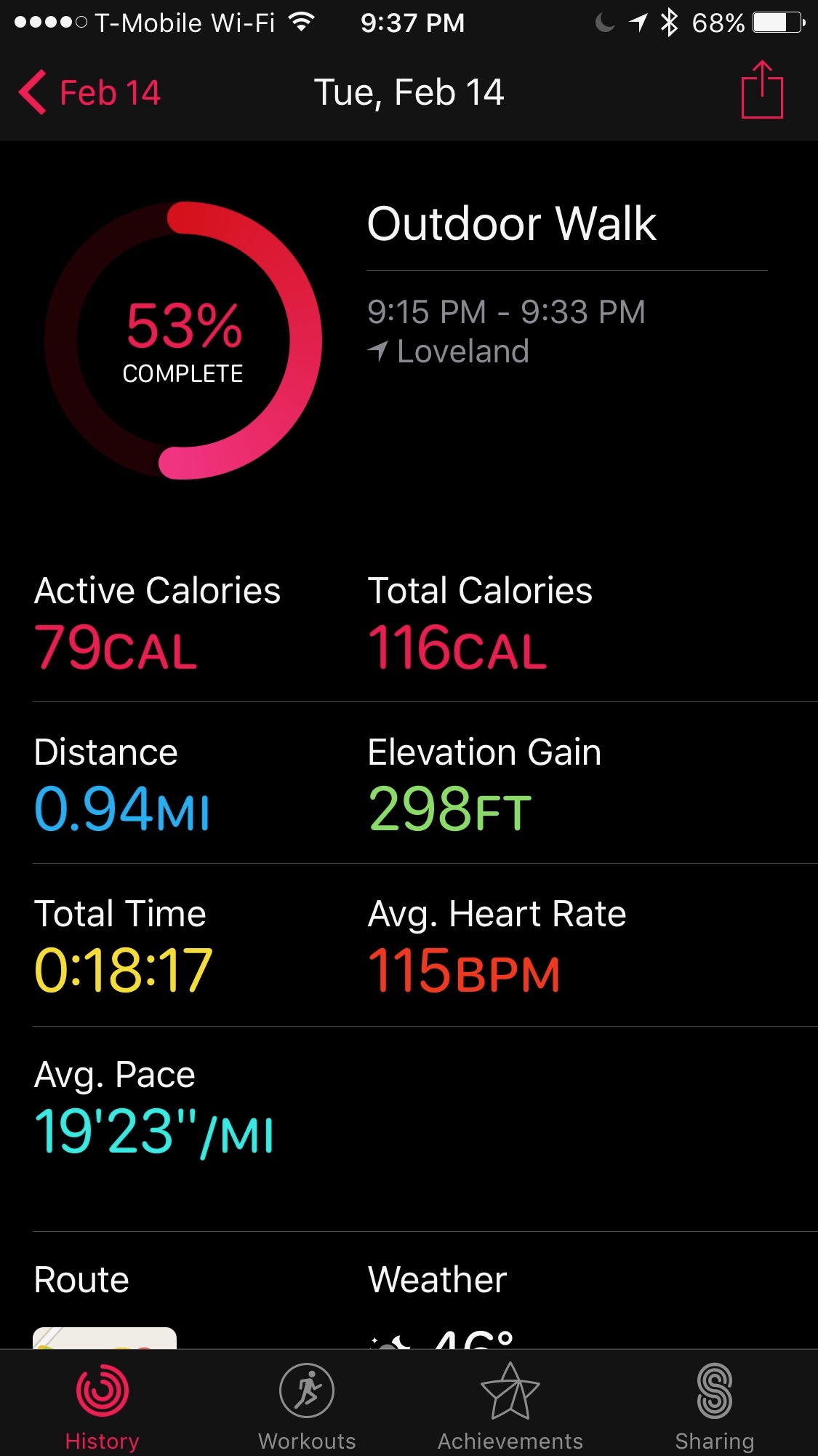

I recently sent this letter to apple hoping this issue will be address it is really killing my experience with the watch.
Hello,
First off I want to tell you love Apple and nearly all of your products. For that matter I love the Apple Watch. But the exercise tracking has really be a pain point of my lately. I recently sent my Apple Watch in for repair b/c of this exact issue and now I realize it wasn’t my watch it must be something else. I do one main thing with my watch take it for walks inside and outside. I have tons of comparisons and the difference between the indoor and outdoor walks is really frustrating.
I took this walk recently only a few days after calibrating my watch and the issue is nearly duplicated on my new watch. Please help…..
The pictures I have included are my recent walks in the same place on my property during my nightly walk. I don’t know what to trust. The Outdoor walk came second in which I actually walked slightly slower but as you can see my heart rate was higher. The issue here is the calories 79 to 129? I simple don’t understand what is going on here. Keep in mind this is a brand new watch that has been properly calibrated.
Thank you,
On average, indoor walking burns more calories for me because its more consistent. Even if I don't use an incline, it is a set speed for the entire duration. When I go on outdoor walks, I noticed that I don't maintain the same speed. A 2 mile walk outside is roughly 150 active calories, a 2 mile walk on the treadmill no incline is about 275 active calories. My pace is much more consistent and my heart rate is much higher on the treadmill.
As to your photos. Just because the average heart rate is very similar, doesn't mean there aren't times of high spikes and low drops (possible misreadings) and that is enough to skew the data. You could have a 5 minute period of 180BPM and a 7 minute period of 80BPM. You will be burning massive amounts of calories in the 180BMP and possibly enough to outweigh the 80BPM by far.
One note about this walk they were both done outside and I covered the exact same area for both walks. My issue is that something is wrong here with the tracking. The walks should have come out with very similar calorie numbers but as you can see they are drastically different and there is absolutely no reason for this except that I clicked indoor walk for one and outdoor walk for the other. This is ruining the experience and makes me feel like I can't trust the watch's data at all.
Running an indoor walk outside is going to completely skew the data. The watch could get confused because of elevation tracking and what not. The only way to compare is to do a 1 mile indoor walk on a treadmill and a 1 mile outdoor walk outside. Try to maintain the most similar pace possible, maybe use a football track for the outdoor walk, so you can time the laps. I edited my above post with a possible explanation of why you are seeing this data. I will repost it here.
"As to your photos. Just because the average heart rate is very similar, doesn't mean there aren't times of high spikes and low drops (possible misreadings) and that is enough to skew the data. You could have a 5 minute period of 180BPM and a 7 minute period of 80BPM. You will be burning massive amounts of calories in the 180BMP and possibly enough to outweigh the 80BPM by far."
[doublepost=1487132089][/doublepost]It could very well be what bcave mentioned above. Outdoor walks only give you true credit if you maintain 3.3mph for the entire 60 seconds. This refers to calories and exercise minutes, because it is looking for a brisk walk. Even though your pace is similar to the indoor walk, the indoor walk may automatically award you the credit no matter what your pace is after 60 seconds. So therefore, if you slow down outside, you lose some credit on the outdoor walk, but running an indoor walk outside will still give you that credit.
I do indoor and outdoor walks on a regular basis, my indoor walks are always higher calorie count because if you look a the stats, my heart rate and pace are always higher and faster. But I am beginning to think it has something to do with the algorithm of the workout itself and how it counts it.
After looking at my heart rate numbers in the health app updated more than once a minute for both walks I don't see any thing out of the normal which you describe. I can tell you this from all of my reviewing my data. The Outdoor walks consistently burn around 80 calories per miles. The indoor walks I do average 100 to 120. I will also state this most of my fastest paced walks are outside. Another thing I notice which is counter intuitive is that the slower I walk on an indoor walk the more calories are actively burned per mile walked. Maybe that is okay based on things I am reading but that doesn't explain the consistence of the outdoor walk calories burned no matter what my pace.
Well the discrepancy would be exactly what bcave mentioned earlier. Indoor walks have a different algorithm than outdoor walk and doesn't look for the 3.3mph average to give you full credit. And that seems to make perfect sense here.
[doublepost=1487133063][/doublepost]All I know is that all my outdoor walks are consistent and all my indoor walks are consistent. Every outdoor walk usually has a slower pace and lower average BPM compared to indoor and because if that, outdoor walk has a lower total calorie burn.
I agree that it could be b/c of their algorithm but it surely needs work. When I am sweating on an outside walk barely burning a 80 calories per mile and then take a second walk later that is leisurely and burn 140 calories in a one mile walk. Something is drastically wrong. I think the problem is that outdoor walks don't burn enough calories and indoor walks at time burn the right amount but if you walk slow you are burning way too many. I almost wonder if it is just burning based on time rather than other factors on the indoor walks. I had a Fitbit surge that seemed way more consistant but didn't have all the other things I love about the Apple Watch. I have to say that I just don't trust it anymore and I am ready to jump ship back.
One thing I will say that seems very accurate is the miles number. I do indoor and outdoor the miles are dead on no matter what.
Well thats what the algorithm for indoor walk that we are speculating about. That it counts time, distance, pace and heart rate, meanwhile outdoor walk counts elevation, distance, pace and heart rate and only time if you maintain the 3.3mph level for the entire 60 seconds. I burn about 90 calories per mile outdoor and about 125 per mile indoor. So pretty similar to you. Which means its the intentional algorithm and indoor walk has a different criteria than outdoor walk.
