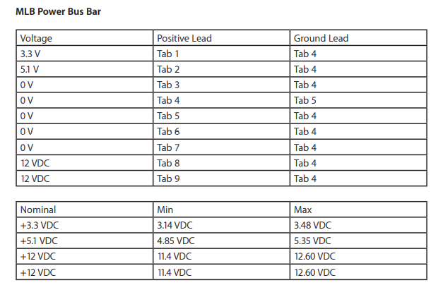

Ref Apple G5 PowerPC Service Manual
No boot tone (LED on, fans spin, no boot tone, video) or No video (LED on, fans spin, boot tone, no video) 1. Reseat video card 2. Replace video card 3. Replace front panel board cable 4. Replace speaker 5. Replace front panel board 6. Replace logic board.

After reading the service manual for the G5, there is an official way to test the logic board and the psu and to see if the voltage is passing through to the 970/s
You need a multimeter or voltmeter to test to perform the test.
The logic board has terminal connection that provide voltage to the cpu. If you are experiencing problems then this needs to be performed. This could indicate several things.
Faulty PSU or a faulty Logic Board.
The terminals are not accessible on the Quad so I would recommend that you remove the processor module and connect clips to the terminals and label each wire and then reassemble.

There is other ways to test as well. I would look voltages as the system is underload and measure the voltages if your system hangs and then post the results. We can then establish what happens during the system running and hanging etc and during hang at startup.
You could have a voltmeter permanently connected to monitor the voltages. You could use something like this eBay item number:284964434191.
