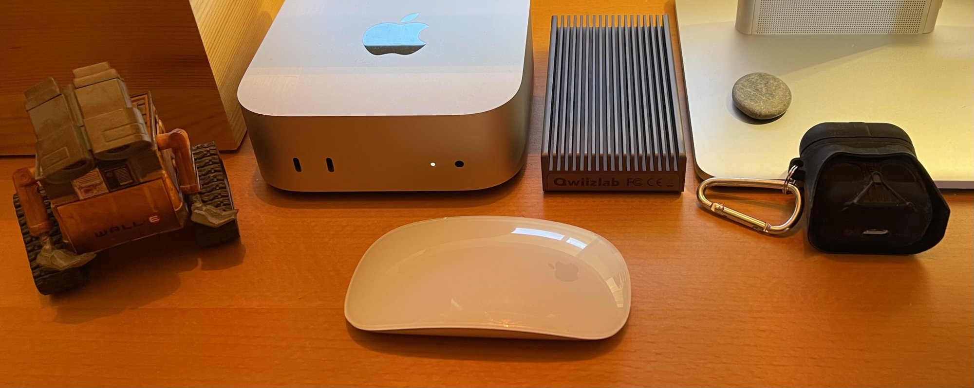

The OWC 1M2 is the same colour as the Mac mini and the Studio Display.

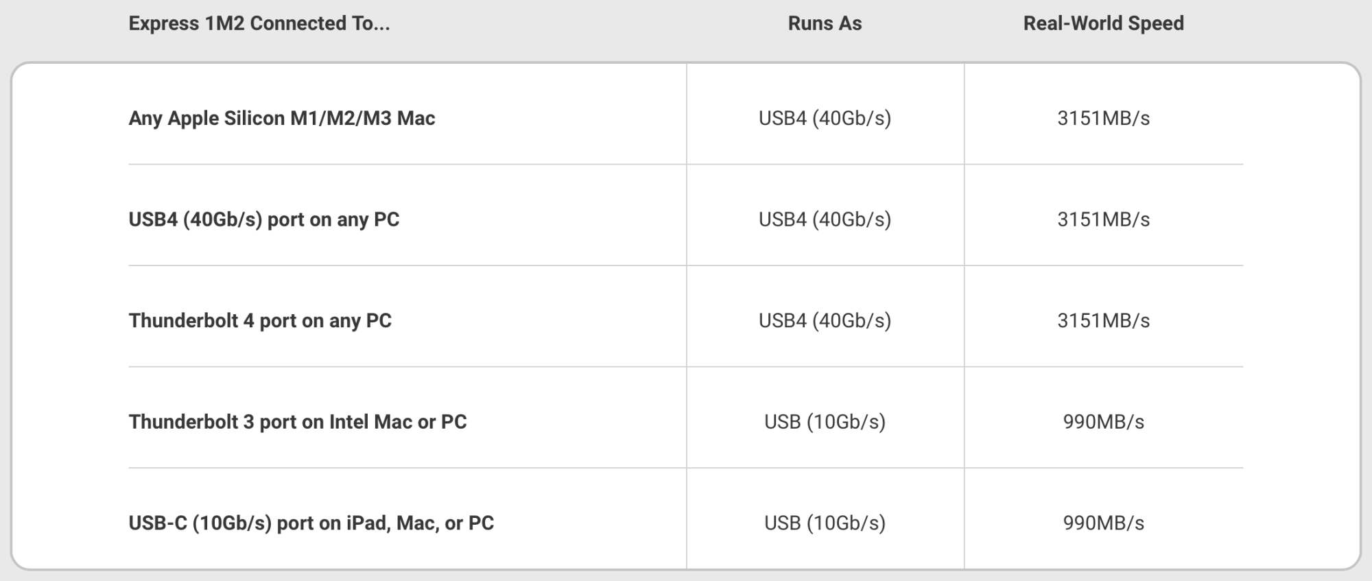

It is because there are some enclosures (e.g., OWC 1M2) that have the same chipset but fall back to 10 Gbps on TB3 interfaces.
Yeah, that OWC 1M2 doesn't support Thunderbolt at all. It falls back from 40 Gbps USB 4 to 10 Gbps USB 3.
