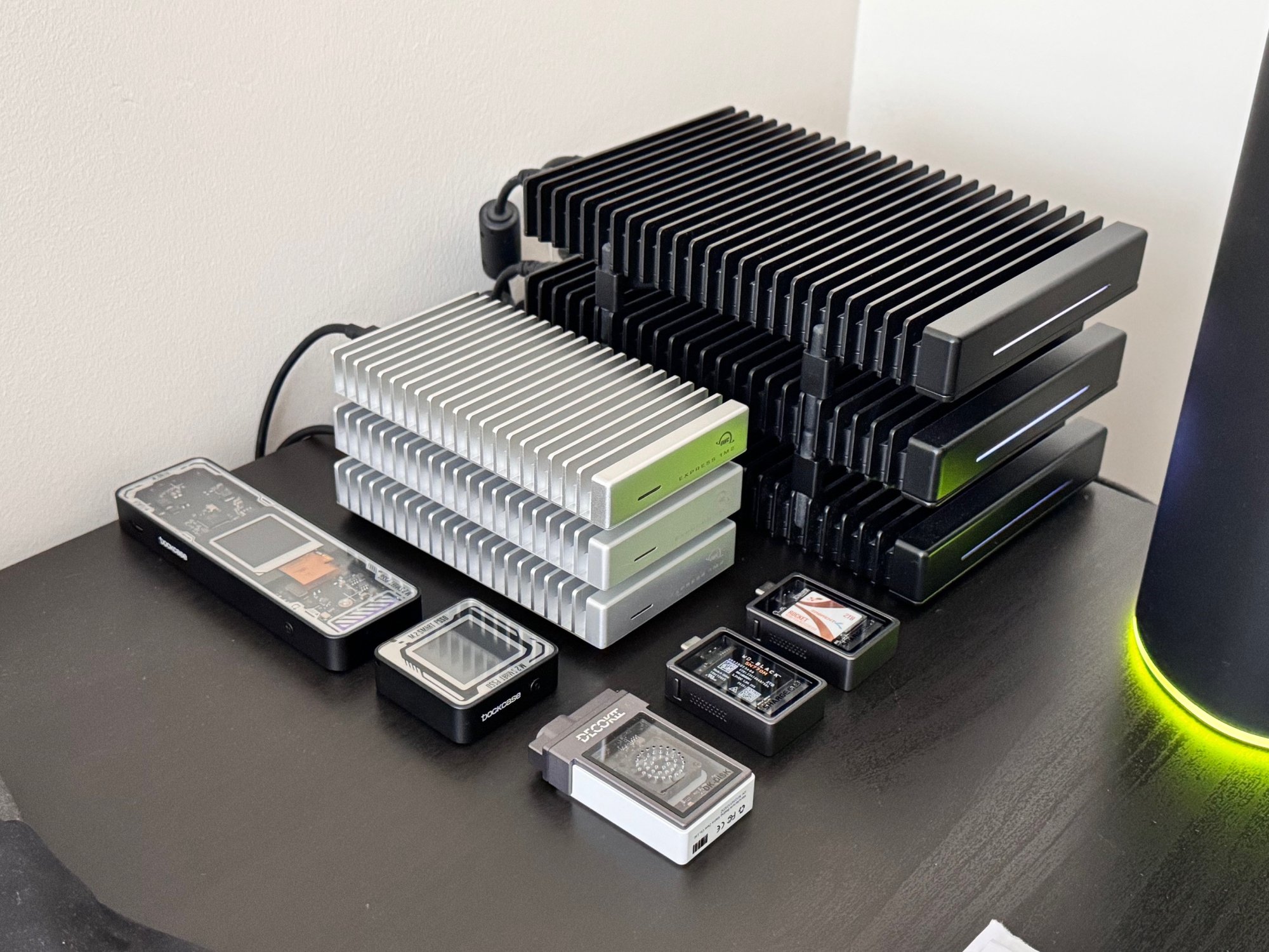

As you can probably see from the attached, I also favor the 1M2. They just work - in fact they are my main drives now. I rarely even use my Thunderblades for anything other then archiving since the 1M2's arrived.
2 of the 1M2 drives came prepopulated with 8TB drives.
I put a 4TB Samsung 990 Pro in the last.
All have worked flawlessly. All my systems have TB4/USB4 compatibility so never noticed any issues with TB3 etc at all.....

Saying that, I do have a Qwizzlab drive on the way as well. Not that I need it - just wanted to try one out! lol
