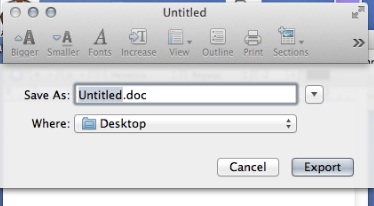

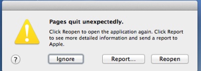

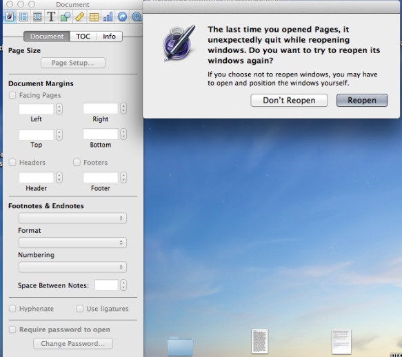

All was fine until I tried to export Pages as a DOC using via LibreOffice, though this has worked many times. The next thing I see is Pages along the top apple menu, but the dropdowns are mostly greyed out. and I am greeted with the messages below.
I have the DVD for Pages, is it all right to re-install over the top of the current Pages application? Of course, I don't know if this is necessary, perhaps someone has a better fix.
I didn't lose any data because my data is saved on a different a volume, of course the program is on the HD.

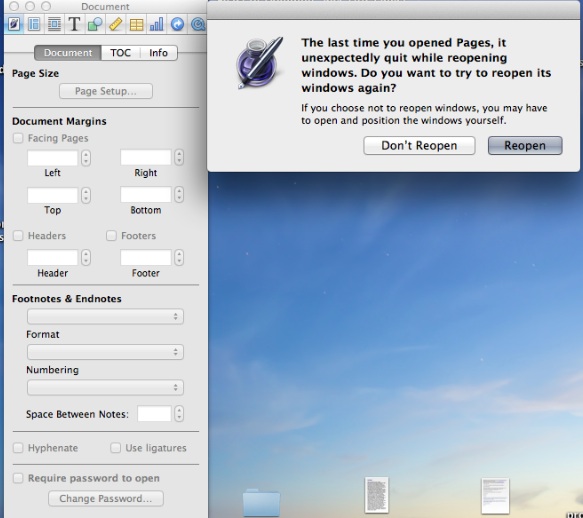

Below the 1st response (Don't Re-open / Reopen), the document feature comes up same time as 1st response, either choice don't/do gives me the 2nd option (Pages quit unexpectedly...).

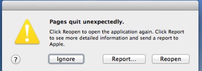

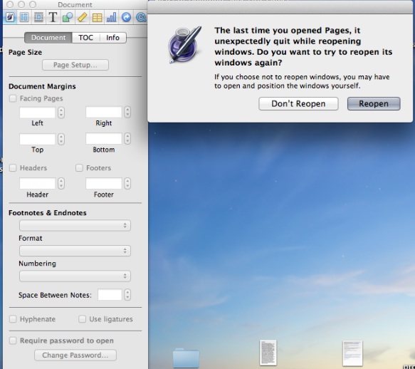

Bummer! Just trashed all the iWorks parts I could find, installed iWords using DVD as directed, but all that happens is a
"Problem Report for Pages", and the other two items as well.
A message reads: "Pages cannot be opened because of a problem. Check with the developer to make sure Pages works with this version of OSX. You may need to reinstall the application. Be sure to install any available updates for the application and OSX."
Click "Send to Apple: to submit the report to Apple. This information is collected anonymously."

Didn't want to stay away so long, but ran into a problem on the Mac Mini and it took me a while (1.5 days) to sort it out, but it's all better now, nothing to do with Pages. If i shared with you(s) I would be able to see your eyes rolling, so I will save myself my own humility; this had nothing to do with my stated problem at the start.
I guess I am the OP??
I appreciate the three parties trying to help me.
Yes, I have a male husband 82 today; I'm 72, been fixing my own computers since 1995. The trouble is, I don't know the correct internet lingo (terms) being used today. I do not have ANYONE, especially my age or even younger to help when something goes wrong with my computer, and I can't figure it out, but I don't give up. If not for forums like this one, which happens to be my favorite, I would have stopped using the computer a long time ago.
Back to business:
Everything is working today, the only loss is the use of 150 GBs named Macintosh HD, which BTW. now wears a cross and skull bones logo rather than a Mountain Lion's head. Perhaps I will try to advance to OS X El Capitan, which I downloaded a long time ago, but never used. I guess I believe in the old saying, "If it isn't broke, don't fix it." Looks like it's broken now. But whether one is buying a new car, or a new OS10, never purchase until others have tested them.
Sincerely, I really do, appreciate the help.
Patt
