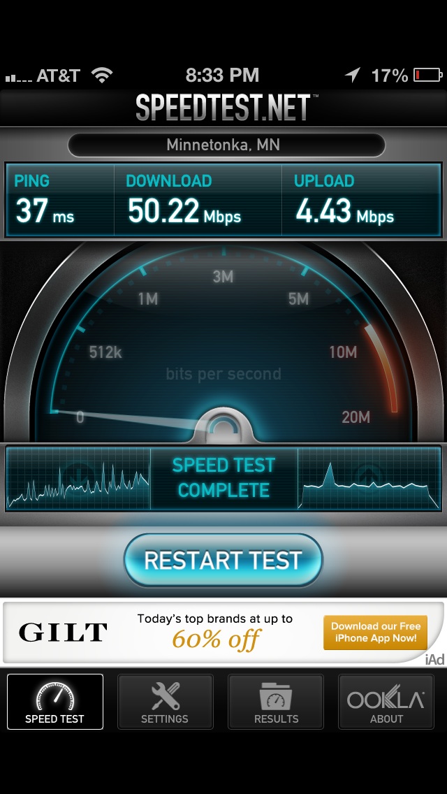

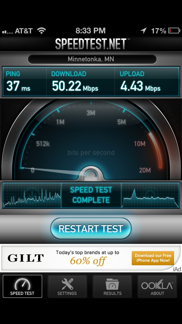

Sorry, not happening on this iPhone 5.

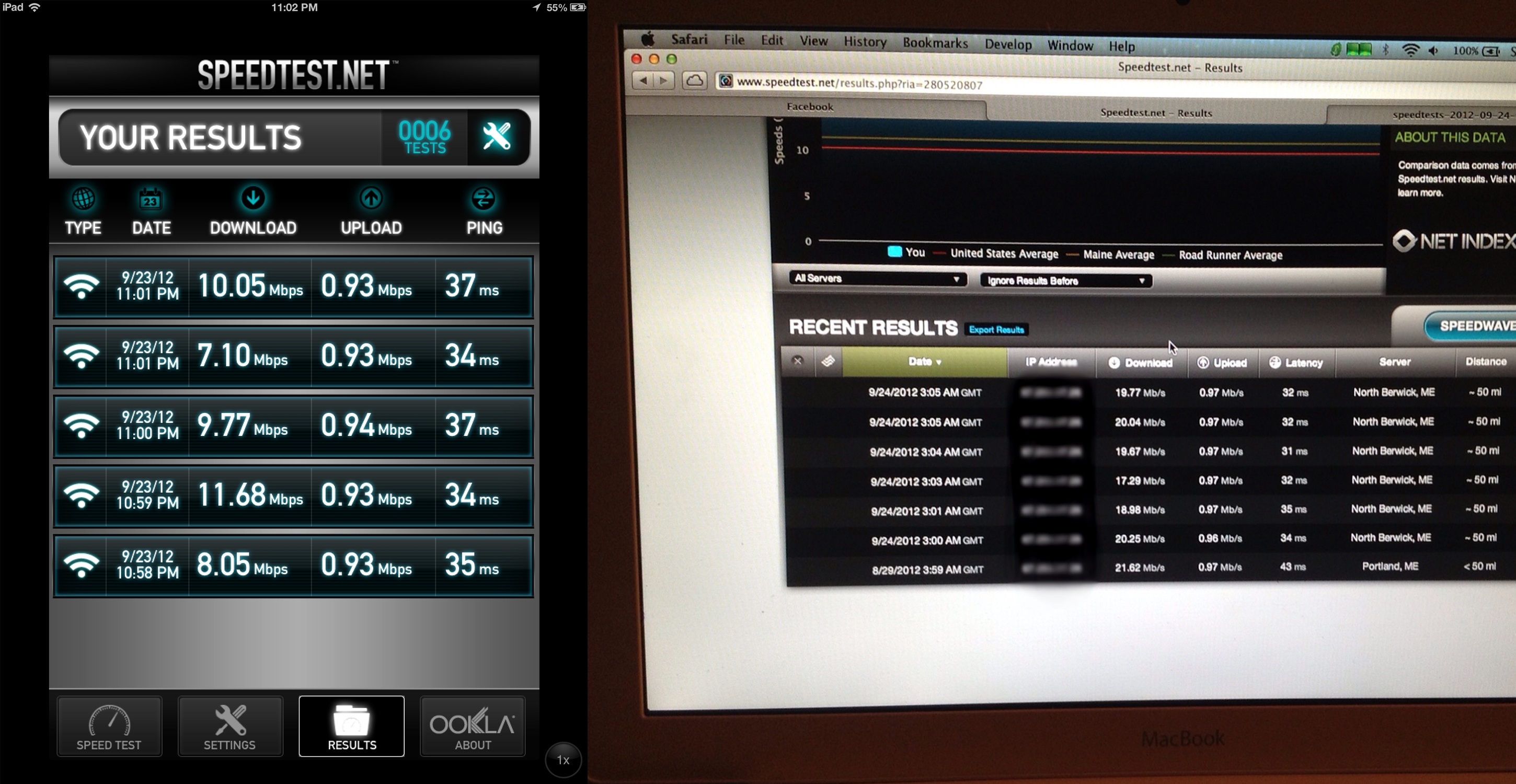

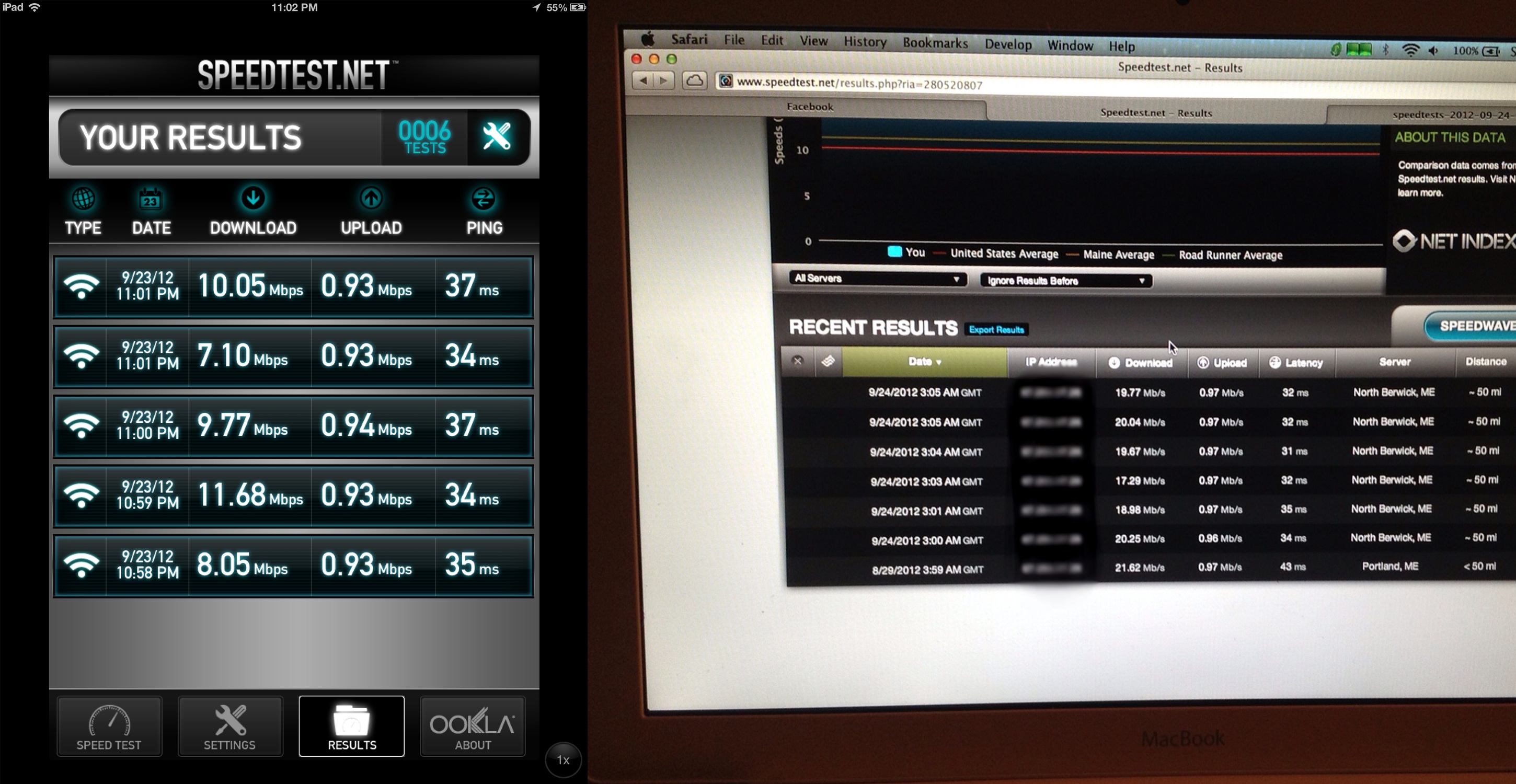

I agree my iPad 3 wouldn't hold a connection for about 2 days after the iOS 6 launch (I got it when it was released Wednesday). After I read that you saw speed decreases I decided to check my iPad. I have a 19Mb/s home connection. I got speedtest.net's app (9.7MB) and it took almost a minute to download with a near 3MB/s connection. So I ran speed test on my MacBook and my iPad (normally they would match for speed on iOS 5) and found my iPad came in at ~50% slower then my my MacBook.

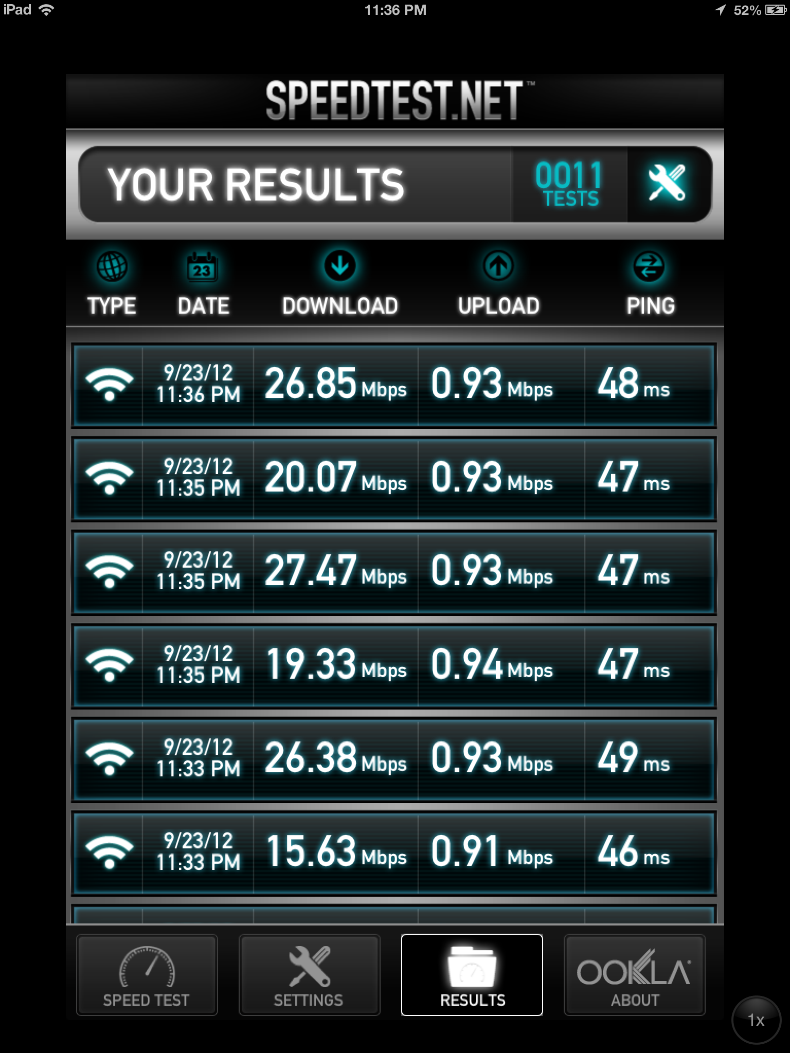

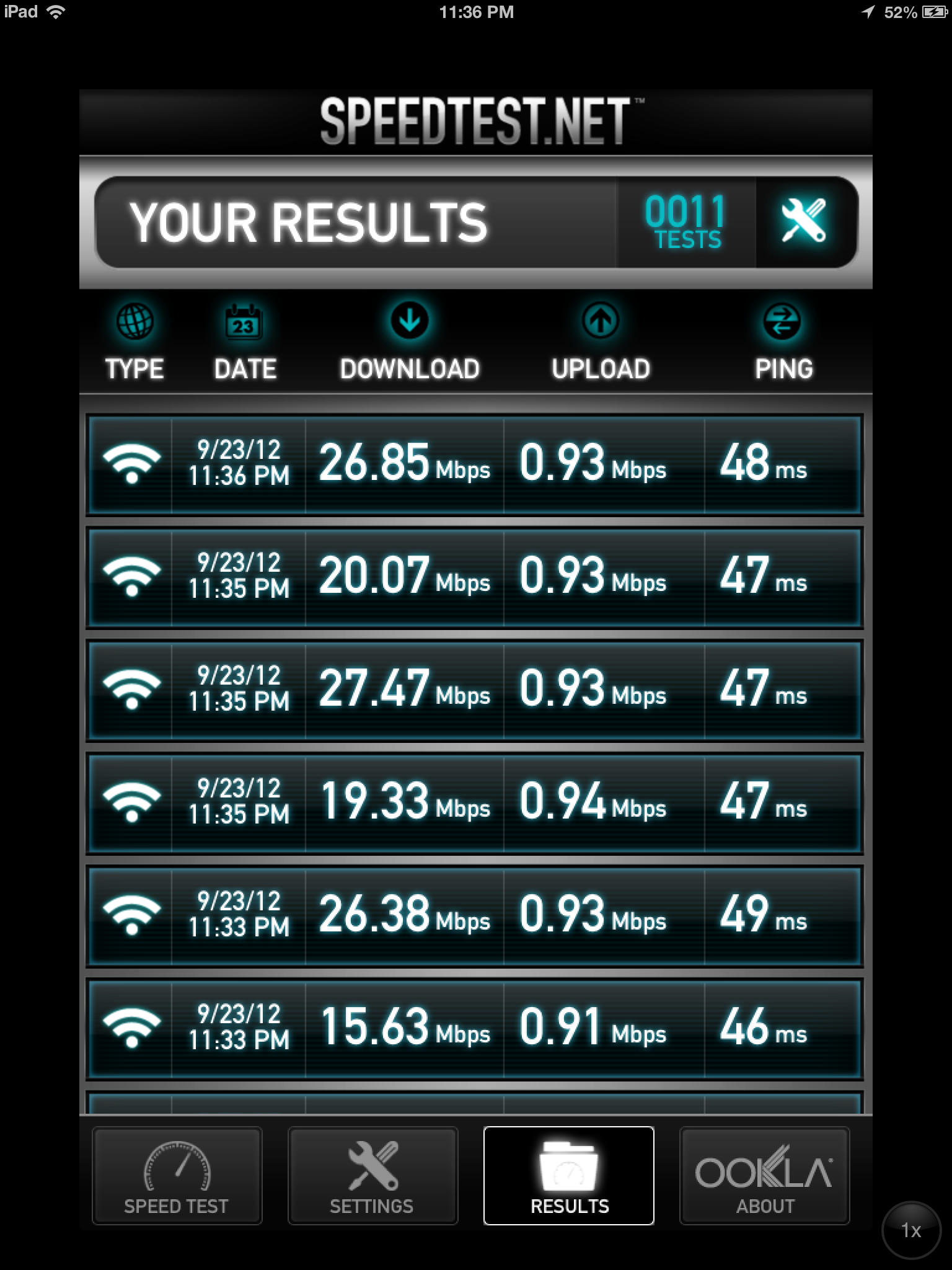

Just turned off WPA on my time capsule and I got 26Mb/s on my second try. 19 Mb/s seems to be the norm with WPA off and 7Mb/s with it on. Good to know that it is a software issue.... My iPad is actually getting better speeds then my MacBook.
