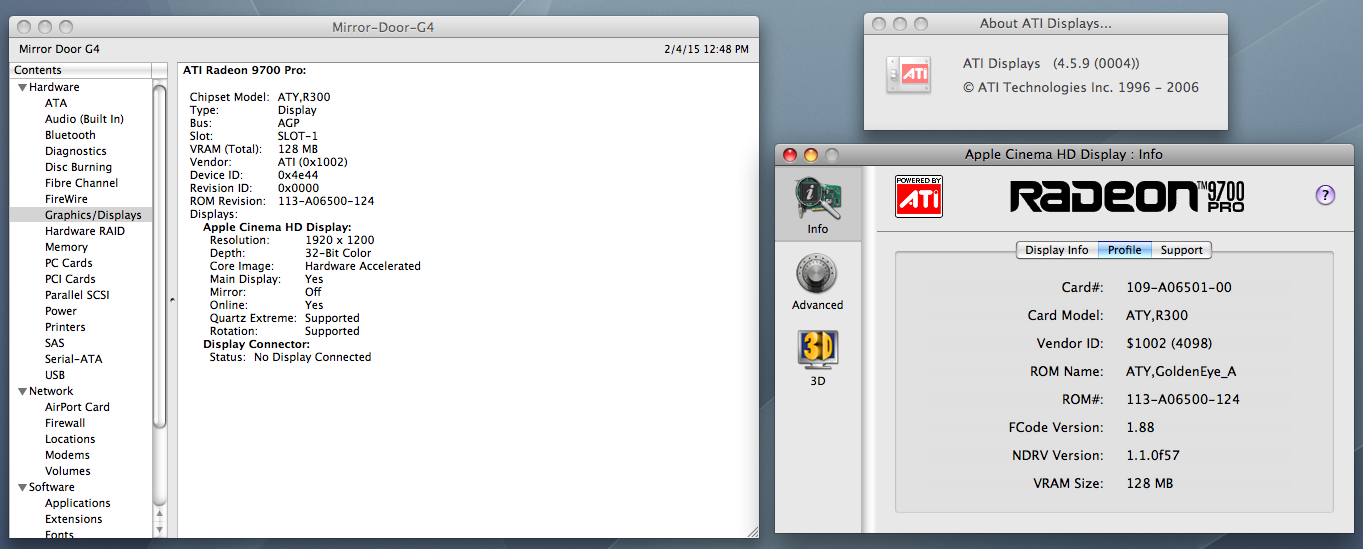

All this talk of video cards, so I thought I would post that I just got a new in the sealed static bag Apple 9700 Pro! The super rare one that was offered as a BTO option with MDD's. It has the ADC plug, and was in the apple replacment part bag with labels. I put it in my MDD FW400 1.25ghz, and its working perfectly, but gets awefully hot while playing minecraft. I actually achieved 79fps in our ppc minecraft with it in a test.
Special thanks to Bulbfreak for locating it on ebay and telling me about it!
Edit: Added in a screenshot of the info windows for anybody thats curious.

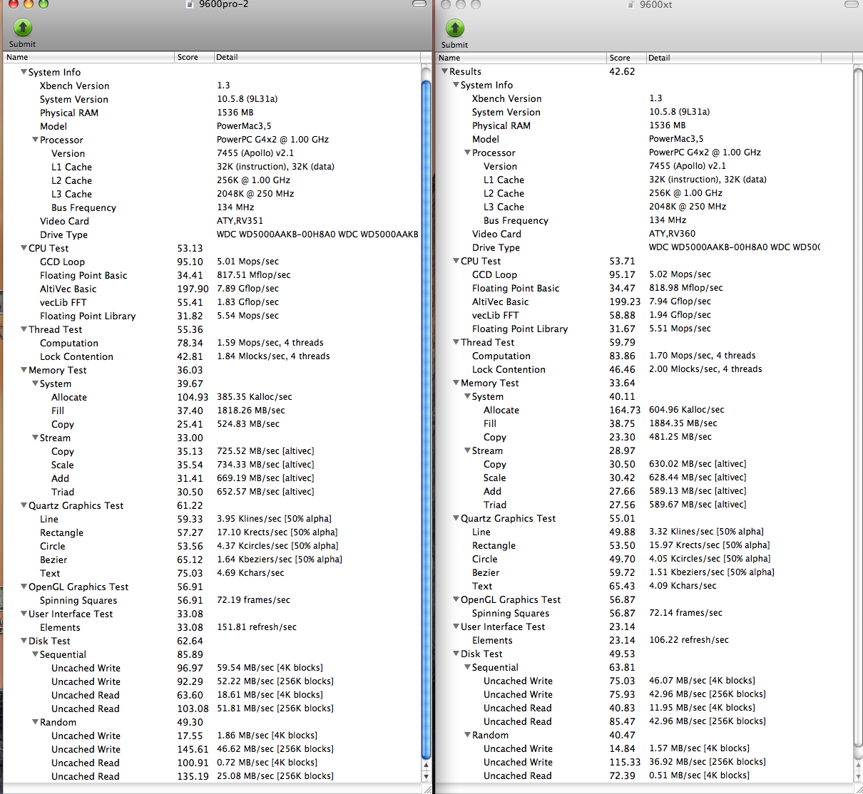

I just finished migrating over to my "new" Quicksilver, which really is in many ways a duplicate of the main one I've been using(except this one is a legitimate dual 1ghz, so I get the L3 cache...it's actually noticeably faster).
In any case, I also swapped around displays and due to some issues with the DVI port on my 9600XT, I decided to try the 9600 Pro again. Much to my pleasant surprise, it worked the first time without any issues at all in this Quicksilver.
That makes me want to try the X800 in it, but I'll save that for another day 🙂
So, with that in mind, here are the promised benchmarks from Xbench. The first is the 9600 Pro, the second the 9600 XT. I should also add the caveat that both cards were driving two display, although with slightly different set-ups. The XT was driving a 17" ADC Studio Display(1280x1024) and a generic(Acer) 20" 1680x1050 panel. The Pro is driving the same 17" Studio, but also a 23" Hi-Def Cinema display(1920x1200).
At least in this particular set-up in a 4x AGP slot, the Pro appears to significantly outperform the XT-at least as per Xbench. Take these results for what you will.

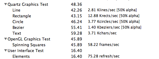

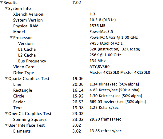

I redid the test under as closely duplicated conditions as possible...Pro on the left, and XT on the right
The Pro still fares slightly better, but they're close enough that I'd like to run the test multiple times and do a statistical analysis.

I'm quite surprised by your results, is that 9600xt running at its proper clock speeds? I never would have thought the 9600pro would beat it like that.
As I said, I suspect(but can't prove) that the 4x slot is the limiting factor for both cards, and it seems that the greater VRAM of the Pro is making up for some of the difference. As you can see in my second test(where I did everything I could to make the system state as equivalent as possible), the difference really is close. With the numbers that close on only one test, it's really bad statistics to declare the Pro as better, especially since they do vary from trial to trial.
As far as running the XT at its correct clock speed-both cards were used as "plug and play" with the exception of installing the ATI drivers which are necessary for the Pro to work properly. The drivers were installed for both tests in my most recent post. I haven't played around with any of the available settings in the ATI control panel-all are default.
I also don't know how good of a "stress test" Xbench is of GPU performance-I know that many folks use a graphics-intensive game to truly benchmark cards, but as I'm not a gamer I don't have the standard suite of programs used.
All of the benchmarks I've looked at comparing the two cards directly looks at them in 8x slots-generally G5s for the Mac versions of the card. Again, I suspect that the fact that I'm running both in a 4x G4 with a 133mhz system bus is at least making some difference.

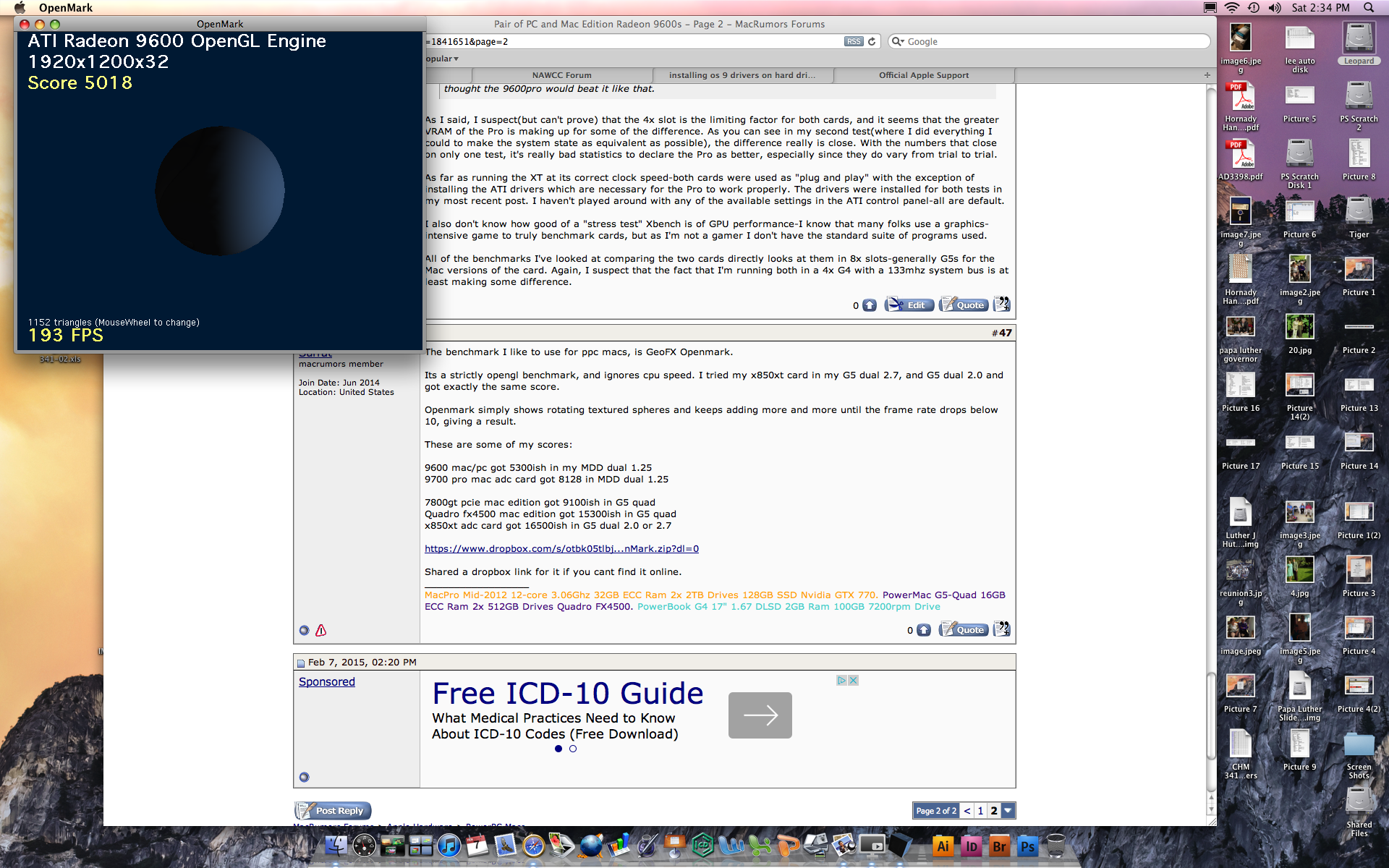

The benchmark I like to use for ppc macs, is GeoFX Openmark.
Its a strictly opengl benchmark, and ignores cpu speed. I tried my x850xt card in my G5 dual 2.7, and G5 dual 2.0 and got exactly the same score.
Openmark simply shows rotating textured spheres and keeps adding more and more until the frame rate drops below 10, giving a result.
These are some of my scores:
9600 mac/pc got 5300ish in my MDD dual 1.25
9700 pro mac adc card got 8128 in MDD dual 1.25
7800gt pcie mac edition got 9100ish in G5 quad
Quadro fx4500 mac edition got 15300ish in G5 quad
x850xt adc card got 16500ish in G5 dual 2.0 or 2.7
https://www.dropbox.com/s/otbk05tlbjau30p/GioFX OpenMark.zip?dl=0
Shared a dropbox link for it if you cant find it online.

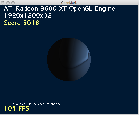

The 9600 Pro decided to(again) quit working in my Quicksilver, so I put the XT back in.
I had saved the OpenMark results from the 9600 Pro, and just ran it on the XT. Both were done from a fresh boot...and they got exactly the same score.

That makes me wonder if the pc/mac 9600 is actually clocked as high as the XT mac version is? Interesting results there..
