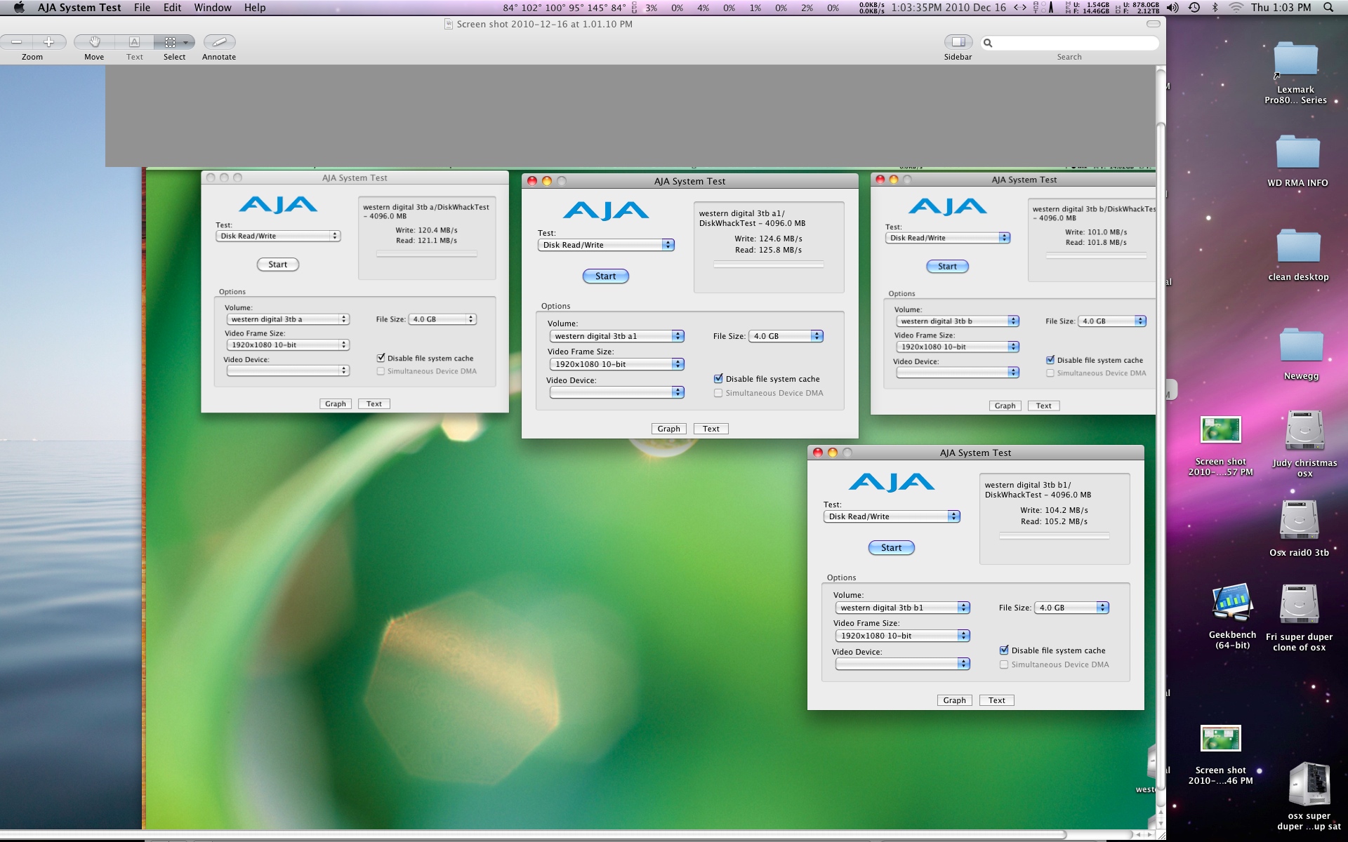

will see the unpartitioned drive as 3 tb. it will let you partition in 1.5tb partitions for mac. (We don't need no stinking windows or is that badges) some aja scores. basically 120 on the outside partitions and 102 on the inside partions. next up a raid0 of the outside partitions.

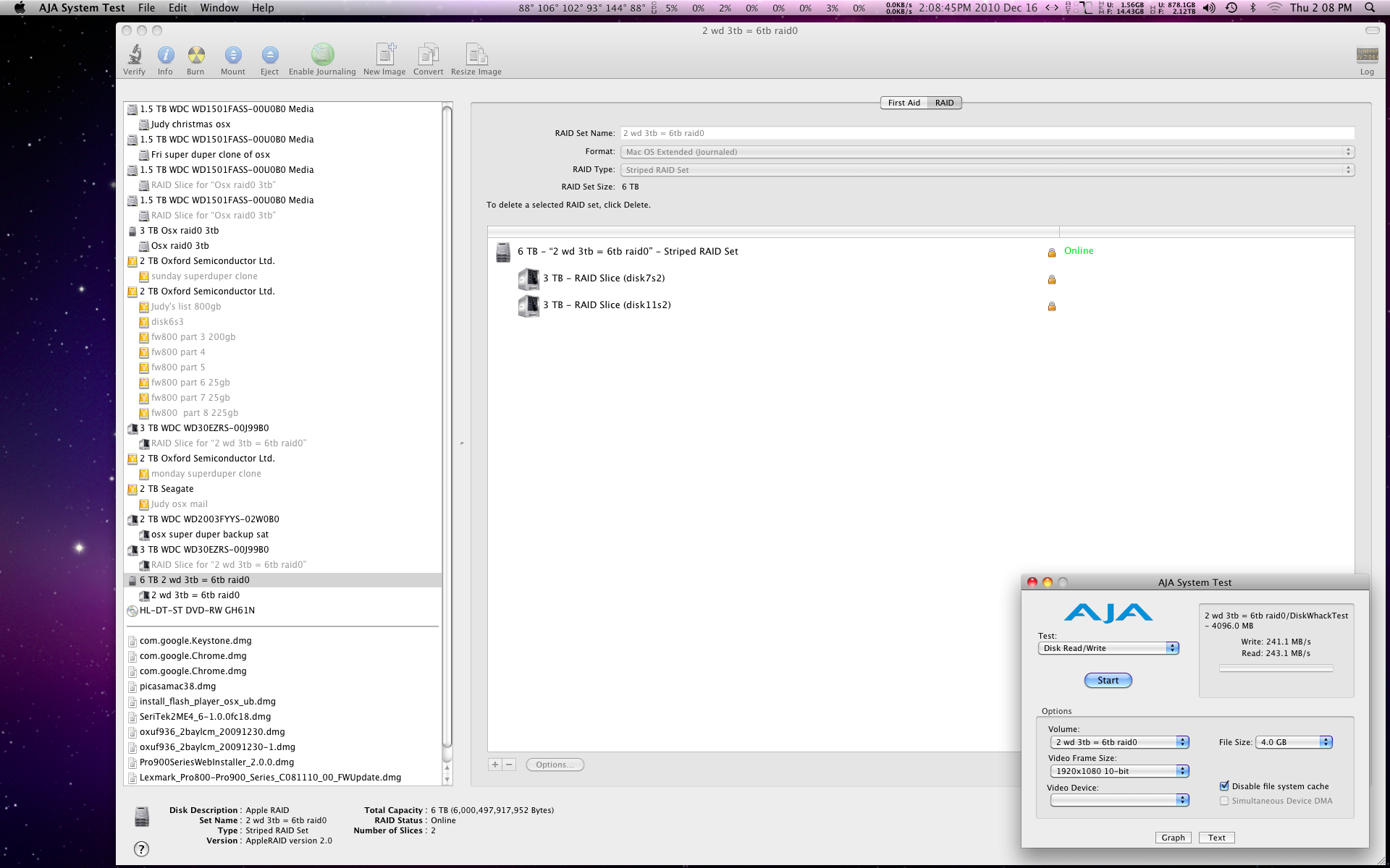

I tested a raid0 with the outer partitions. aja was 235 write 242 read

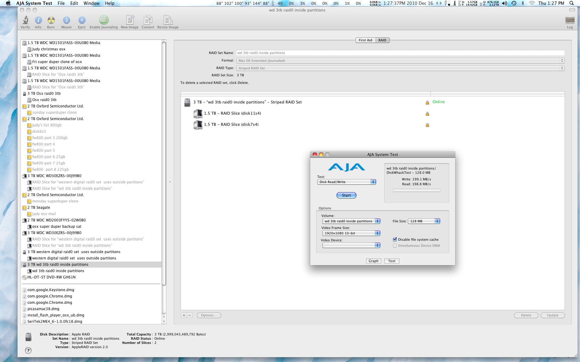

i tested the inside partitions in a raid0 aja was 199 write 198 read makes sense to get these numbers the unraided outside partitions add up to about 245 so 235-242 for raid is logical. the inside not raided add to 202 sot 198-199 for the raid0 makes sense. well as far as rosewill 8 bay and seritek 24tb piece looks doable. quite a feat the inside of the pro can have 12tb and a ssd so 36tb in 2 pieces amazing.

raid0 with 2 3tb partitions

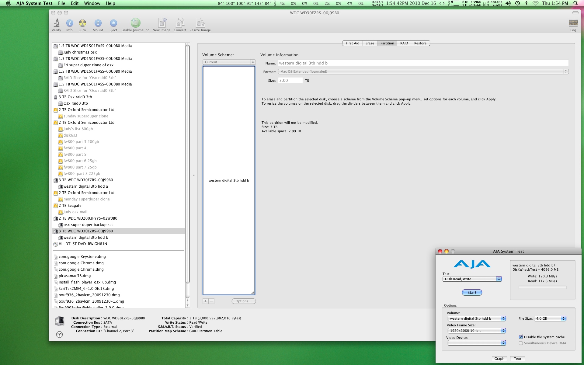

the news gets better. i tested if the rosewill and the seritek card will allow a full 3tb hdd 1 partition they do. I erased the raid0 setups and partitioned each hdd as 1 3tb partition was able to do so as mac osx format. notice one hdd seems faster. i think it is the rosewill not the hdd. the rosewill has 2 esata jacks 1 for 4 hdds the other for the other 4 hdds. one jack is faster then the other. one last test a raid0 should give me about 240- 242
yep it did about 241 and 242. well I want to get the rocket raid card next week to do more tests and i want to test more pieces. but 3tb is easy and will work with esata cards at least seritek for sure as tested by me today.

philipma1957:
Keep in mind that the cards you're trying out are BIOS based, so they won't be able to use the disk as a single partition using the full capacity.
This should be possible using the ICH on the systrem, as it's EFI (the one useful benefit to EFI/UEFI right now, as you can get past the 2.1TB limit in BIOS).
The non-RAID HBA's by ATTO, or the RAID cards by Areca and ATTO should be able to use a single partition using all the available capacity once they've been flashed to EFI (single disk operation = Pass Through mode). There's also the eSATA for Mac from Highpoint that's EFI based as well.
